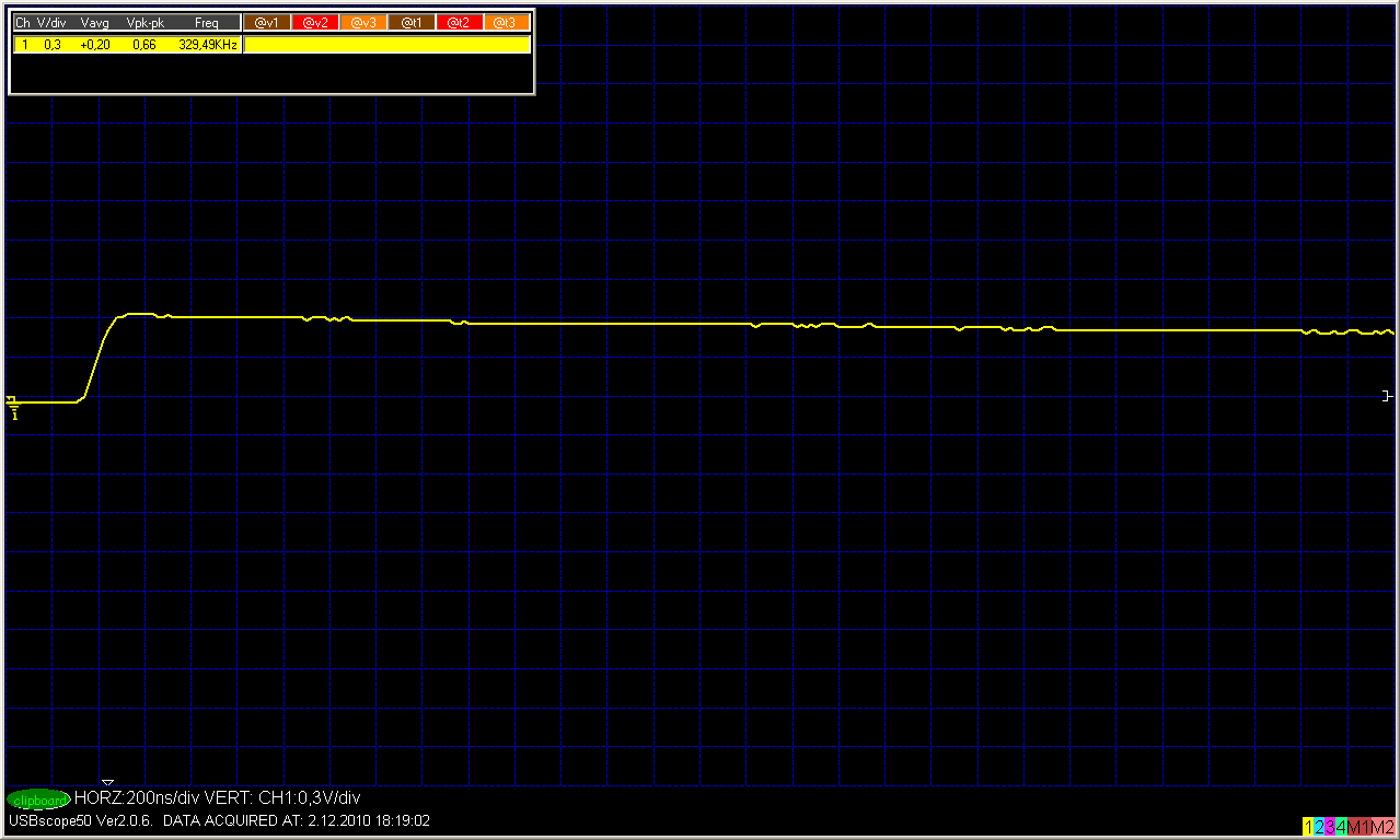

Here you can see the input signal rise time, in 200ns/div. 20ns per sample.
To Joao: thanks for kind words, but I cannot disclose the circuit. I sold a similar one for commercial purposes, and there is one same trick used in both designs.
PMA
no problem and I can understand that. May I ask you what "test record" you are using, or is it just a square wave signal from the generator.

Joao,
no test record, no vinyl scratch or mistracking reproduced by any even fastest and most differentiating cartridge would produce a signal with less than 200 nanoseconds rising edge, as I have shown in this post:
http://www.diyaudio.com/forums/anal...rch-preamplifier-part-ii-711.html#post2385003
This signal is produced by square wave generator and CR differentiating network. I do have measuring records, but I do not use them as fast impulse generator.
