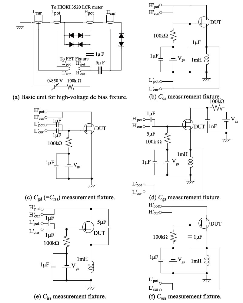

An open question to all, but probably especially for Scott :
Is there a simple method for DIYers to measure the frequency dependent Ciss and Crss values of JFETs and MOSFETs ?
There are 2 figures in the Freescale AN211A, but with no description at all.
Thanks in advance,
Patrick
Here's a better set of test jigs. Just substitute a decent hand held C meter and with careful zeroing you should be able to get pretty close. For the JFET's you normally use measuring Cgd = Crss should be enough . Since they are symmetrical Cgs = Cgd and you should be able to read the values off of the Crss vs V graph for any operating point.
