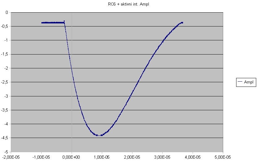

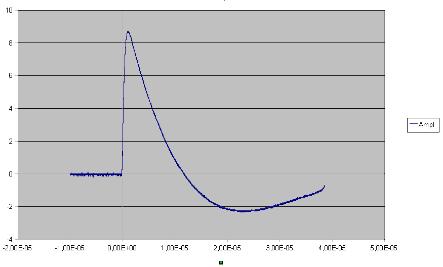

For the reason that we speak about faster signals (not very fast yet), opamps and feedback, I would like to demonstrate a more demanding signal, than MC output.
The amplifier input signal is from Rogowski Coil, measuring 8/20 us high impulse current of several kA in a High-Voltage test lab setup, with plenty of interference.
The output signal is from inverting opamp integrator. This integrator consists of very fast opamp and very fast buffer.
As we can see, the input signal, which is derivative of measured current, has sub-microsecond rise time. Output of the opamp integrator properly displays the shape of measured current. Now please understand why I become nervous when I hear that 5 - 10us of input risetime generally makes problems to feedback circuits.

Yes, PMA, your output looks OK, BUT you are using an INVERTING integrator. A phono stage is a NON-INVERTING integrator, with the input filter set at 30KHz, rather than 1 Hz or so. Please note the difference. Then look at Graph 1 which shows the TIM waveform with the LF356, an early jfet input op amp. Is .03% to 0.1% OK?
Going further Pavel, I suspect that your INVERTING INTEGRATOR never sees the transient in the first graph that you presented, only the second graph, and THAT is only 1/2 as fast as the TIM(30,30) waveform that I used. This is because the input signal is ALREADY integrated at the input, due to either inductive or capacitive integration, whichever is used for your INVERTING INTEGRATOR. A practical phono stage, that is normally used, by virtually everybody, is the rough equivalent to a NON-INVERTING integrator and the original waveform appears at the input of the op-amp. This is the problem. So where you think that you are handling a faster signal, you are really handling a slower signal by approximately 2 times, and using a very fast IC op amp as well. Still, how do you know how much REAL distortion you are generating? How accurate do you have to be? 1%, .1%, .01% ?

sorry but the 2 graphs don't do much to me vertical scale on first one is 2 times scale on second
A MC phono stage has gain of 60dB normaly
PMA
Sorry, second graph is -integral of the first, so you have to know integrating constant to calculate exact voltage value. This constant is not important, the shape is important. In case you understand how to integrate and differentiate, then you can easily compare the two images. Multiplication constant is not important to do this.

Yes, the non-inverting integrator would not work in my measuring instrument. The complete instrument is in fact non-inverting, as it has inverting output stage, and (-) x (-) makes (+). I have shown only images from development stage of the integrator, it was measured in 2003.
I would respectfully disagree. To respond properly, the active integrator must create accurate output to keep virtual ground at zero level. If not, then the output signal is distorted and not an exact integral anymore. So, in case the integrator is not a) fast enough b) cannot provide transient current to charge feedback capacitor, then the output is incorrect.
