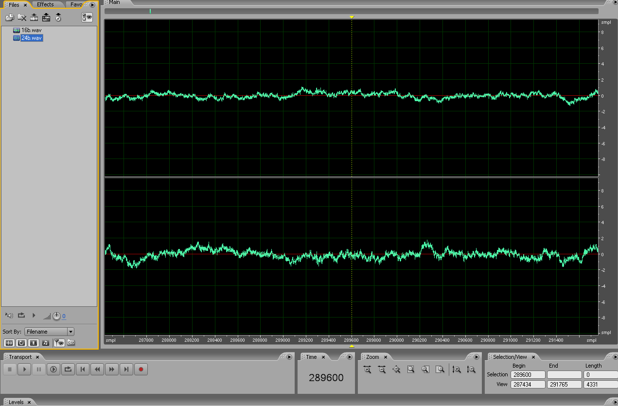

Pavel, I've tried to record noise at -93dB (about the level of 16 bit dithered silence) and when played back set for normal listening I hear nothing. What do you mean?
Try this:
https://www.dropbox.com/s/fzptrndp7avwya5/16b_24b.zip?dl=0
16 bits x 24bits, same recording (a friend of mine, enthusiast). Take a very good audio equipment, no notebooks, no smartphones. Warning, initial part has very low volume, followed with high volume kicks. In the first half, you may hear quantization noise from 16b file, with good headphones and good headphone amplifier. Please feel free to make any file analysis, you will see quantization noise in the 16b file and not in the 24b file. You may also make your own TPD dithered 16bit file from the 24b file to see and hear the added noise.
For those who do not have dropbox account, click outside login box window and you will be able to download the file then.
Is not it amazing to get such low noise from the whole recording chain? SOTA gear is excellent. 16bits is not enough.

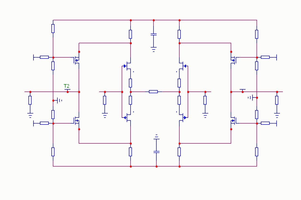

The original equation was in impedances, where Z(C) = 1 / ( 2 x pi x f x C ) and Z(L) = ( 2 x pi x f x L).
That's why the constraint equation changes form when replacing the impedances Z(L) and Z(C) with the above.
Walker's original equation was: Z(L2) x Z(C3) = R1 x R4
Then substituting for the impedances, L2 / C3 = R1 x R4
We then have the time constant (L2 / R1) = the time constant (R4 x C3) as the condition of balance.
Note that the presentation equation does not have consistent units and so cannot be correct.
That's why the constraint equation changes form when replacing the impedances Z(L) and Z(C) with L and C.
We then have the time constant (L / R) = the time constant (R x C) as the condition of balance.
Note that the presentation equation does not have consistent units.
Indeed, fully agree. Thanks for the amplification.
Edit: I used one of the resistors to tune the bridge which nulled the odds. Why is that, why not ALL harmonics? What do you think would happen if I tune the cap?
What do you think would happen if I tune the cap? Jan
In theory, tuning any one of the four parts should yield the same results as the others. In practice, things may be a little different.
The capacitor is rather small in value also, only 120 pF. Maybe the evens are in the class A amplifier.
Try this:
Whatever, I don't hear a thing.

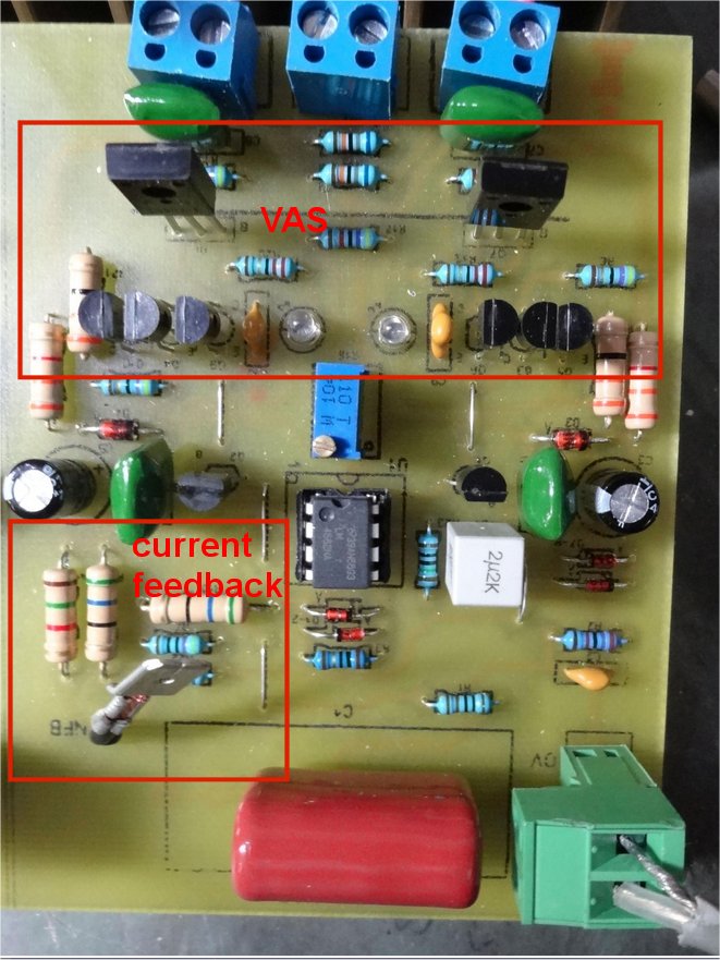

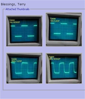

I just saw "simple". Member still4given just fired up the "eyesee".
Just the "mocked" TL072/NE5532 IC can do what a much more involved
discrete design can do (at 100W).
The limited performance of these old IC's is circumvented by V/I use -
it seems (>50V/us slew - nice 100k square waves).
Scope (below) says it can match anything discrete (VFA). Listening impressions
were in line with leach/blameless/"advanced".
"Somewhere in the middle" can be both simple / high performance (and
a CFA :) ) .
