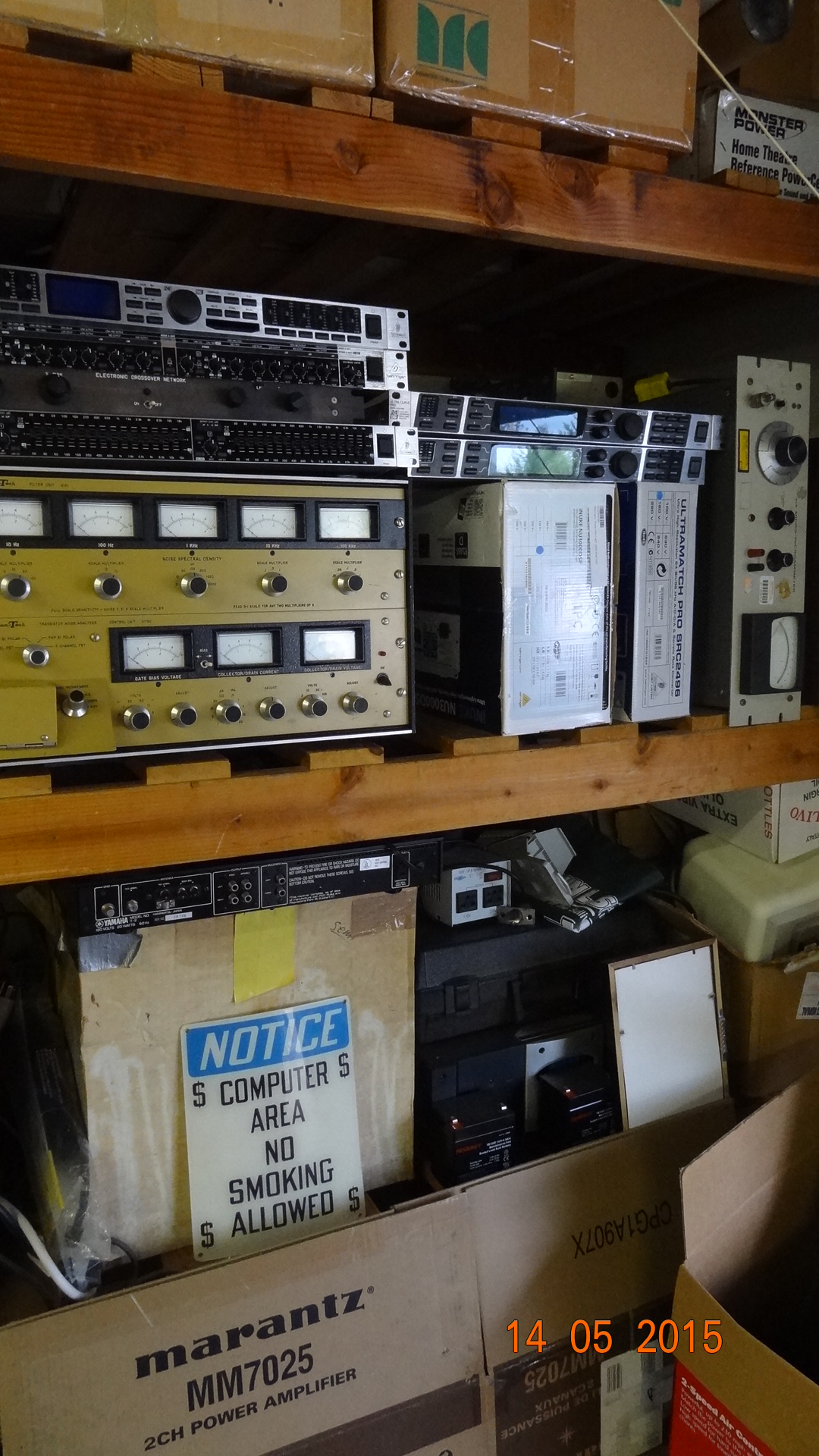

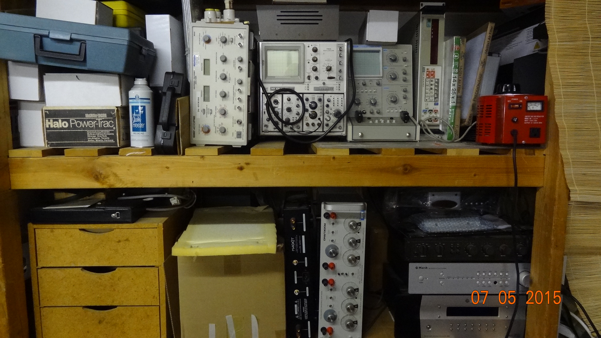

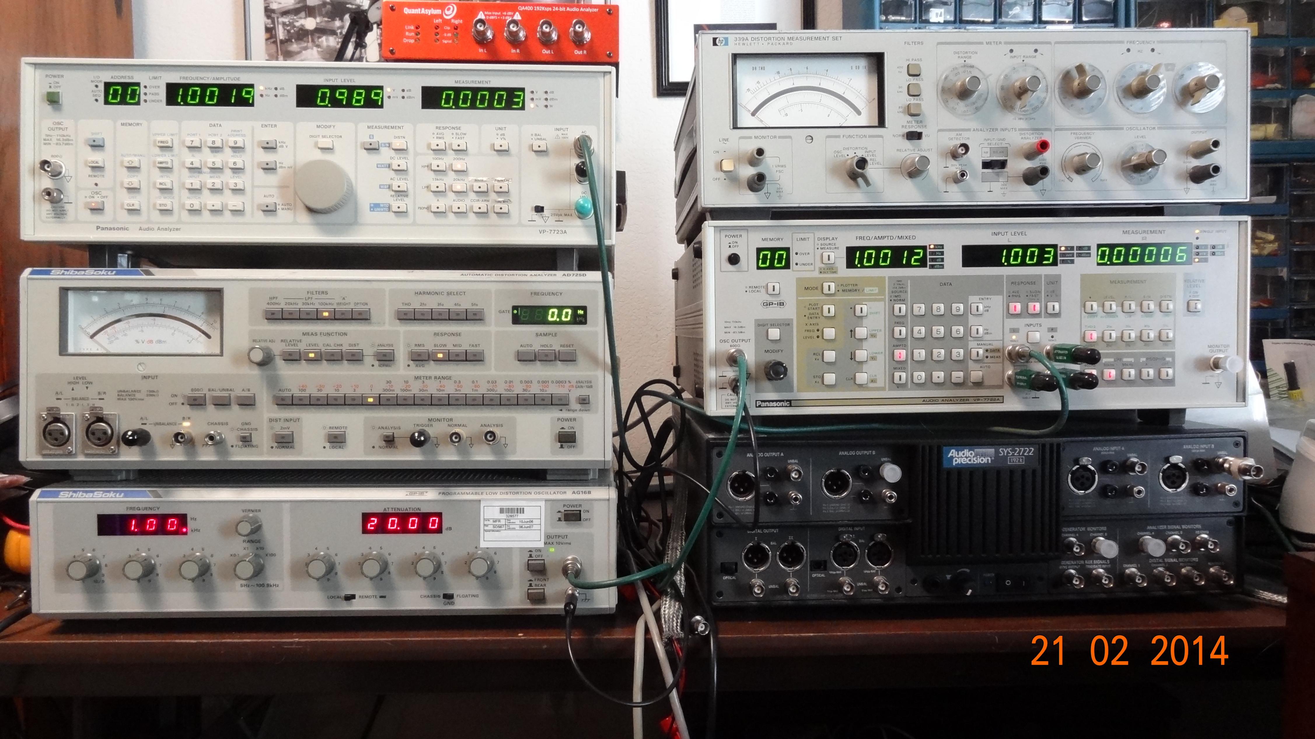

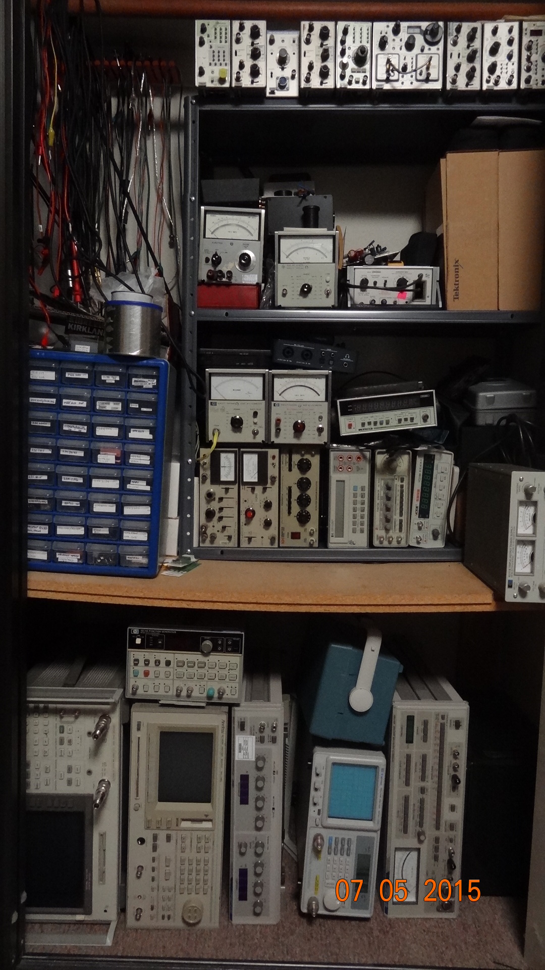

Too bad Waley doesnt live next door to me... what he could do with all these racks and shelves full of test equipment. Every few years I do a purge to make room for the next batch of instruments. I'm in that purge process now:
Making room for jitter testing and some other new items.

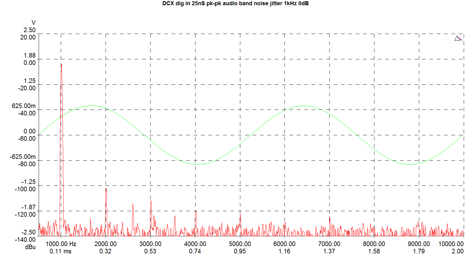

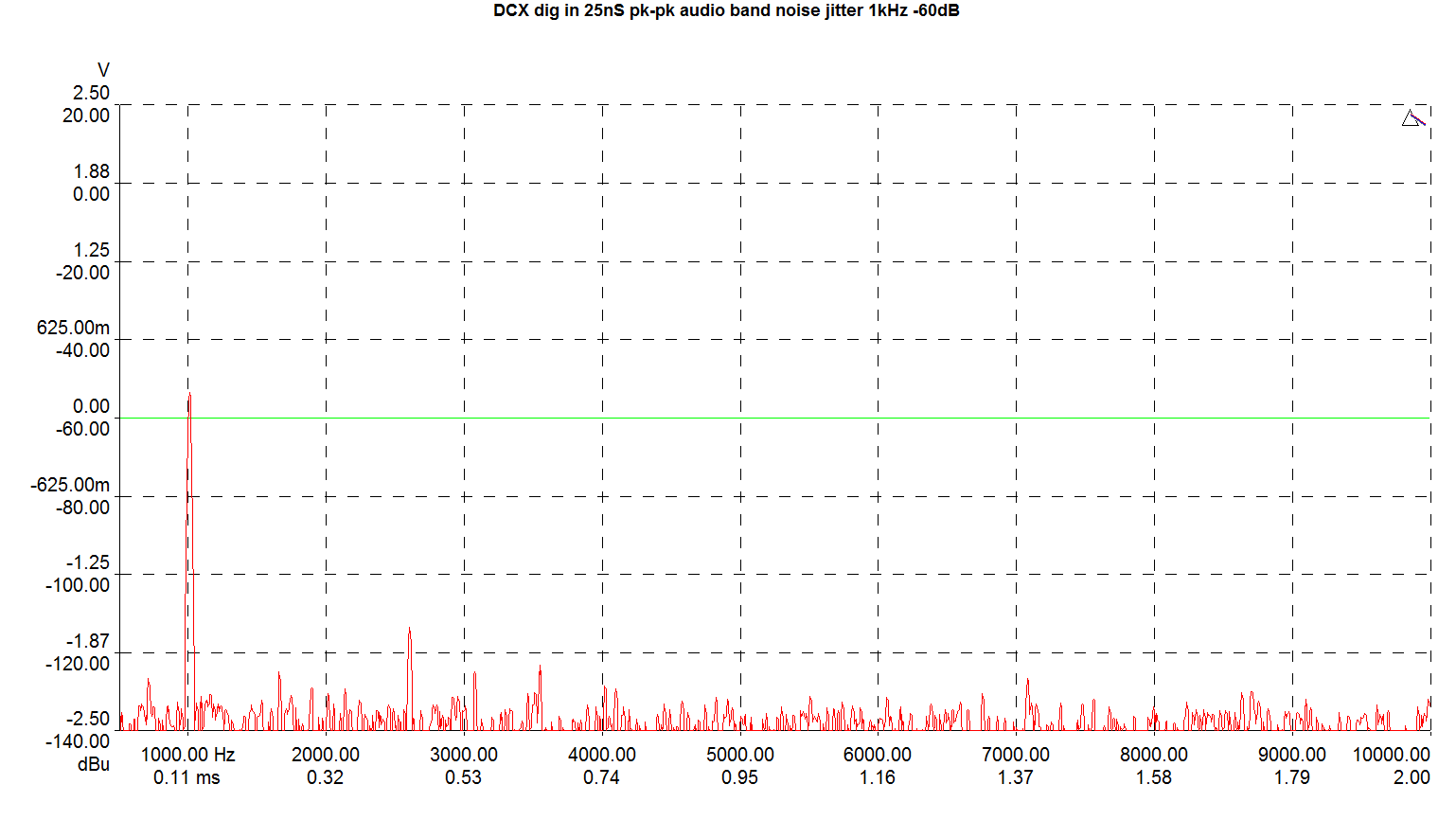

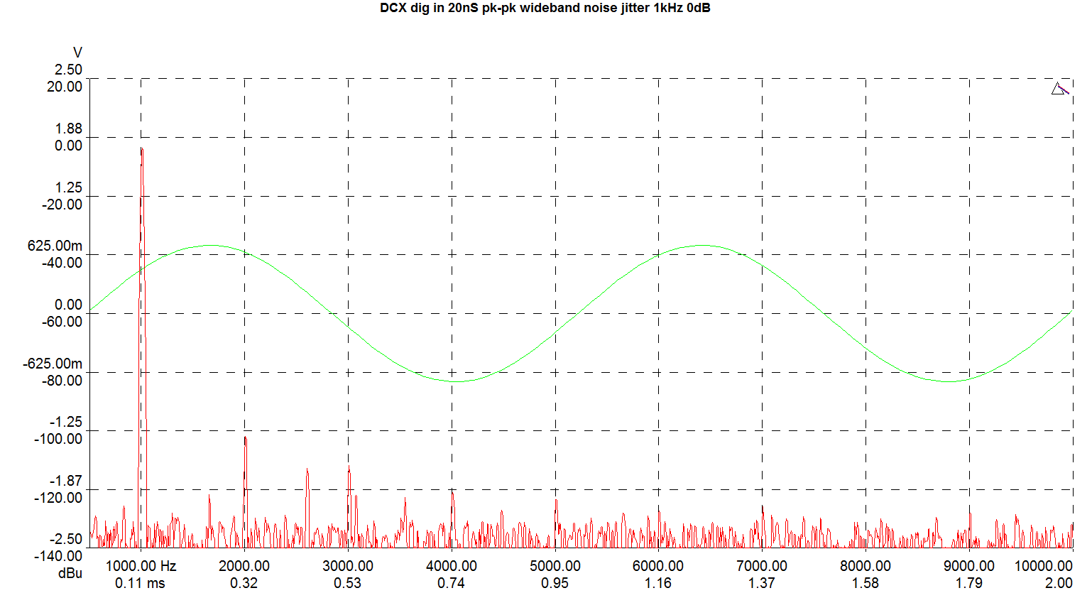

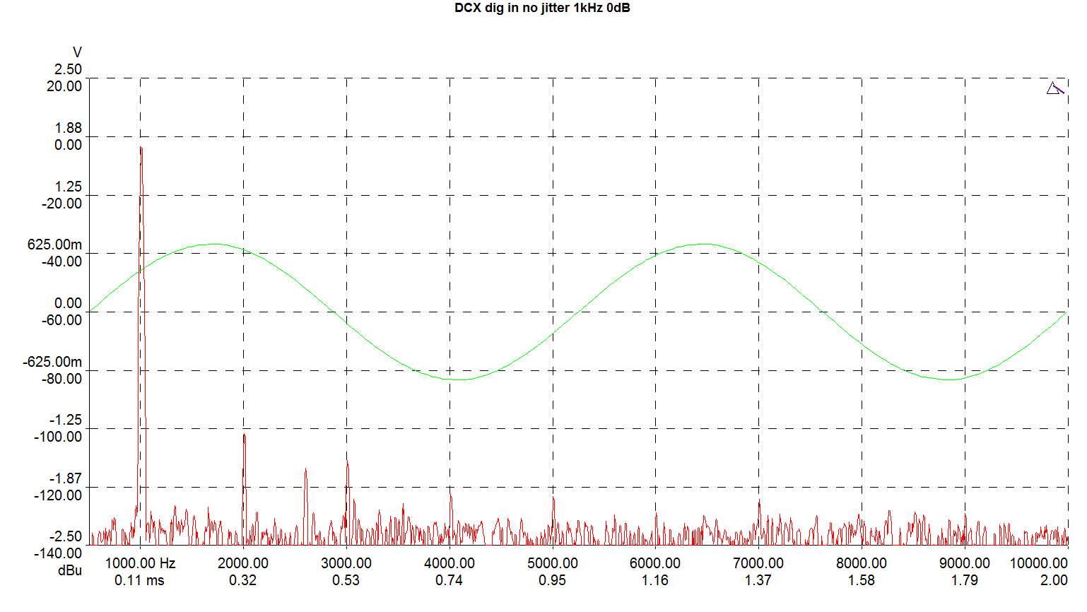

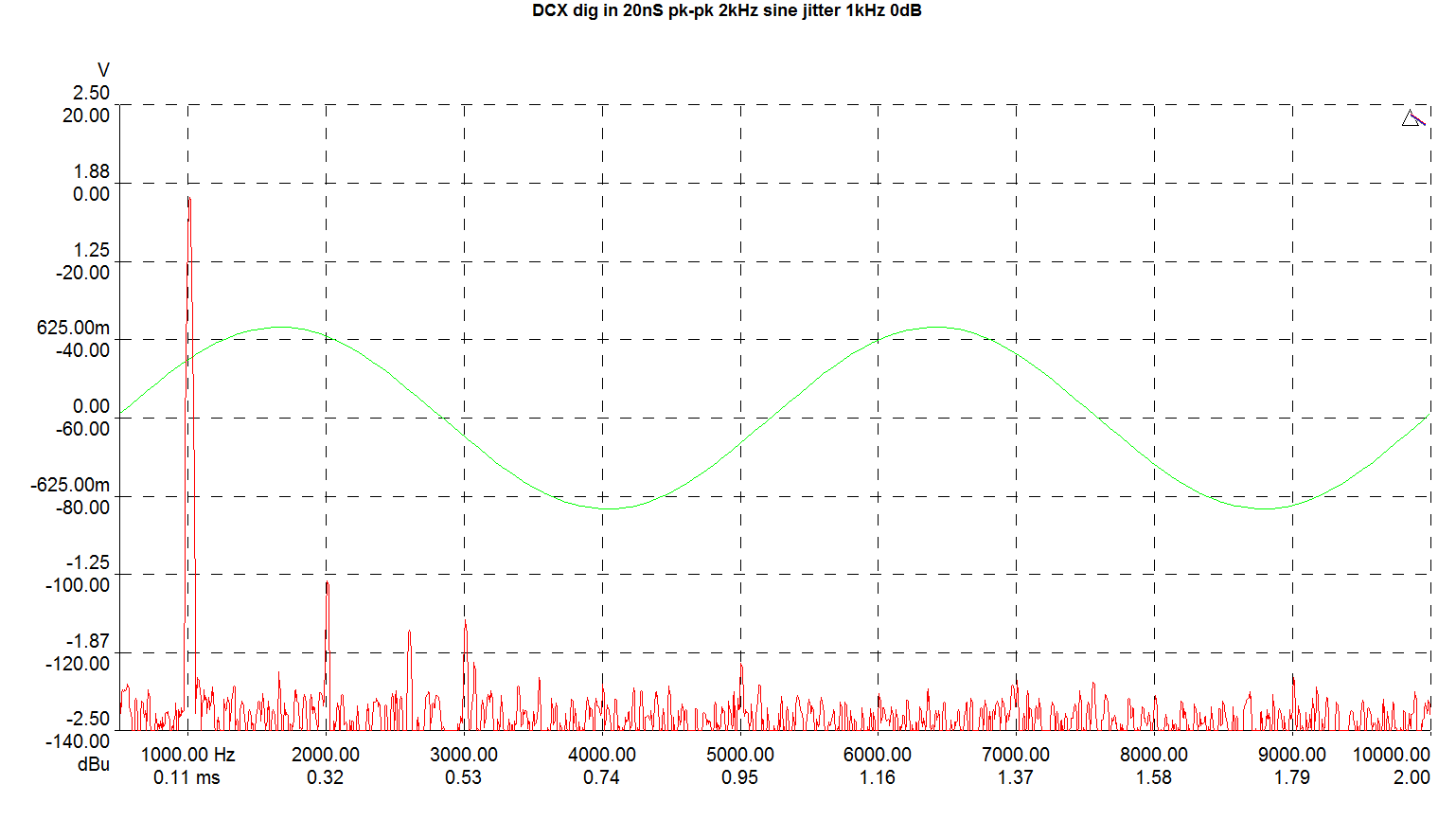

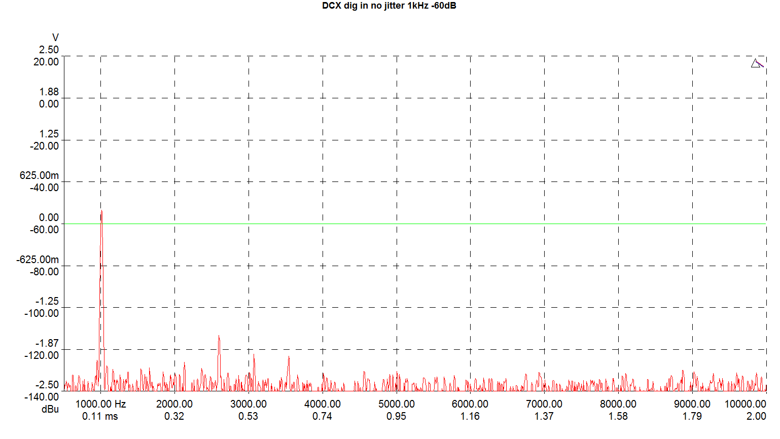

Onwards in the jitter saga:
I did some measurements on the impact of digital source jitter on the analog output of my trusted DCX2496 crossover/ 6 channel DAC. This unit has been modded with a new Frank Oettle clock with low noise psu, my own analog active output stage and a linear power supply in lieu of the stock switcher.
I recorded the analog output with a 1kHz digital input signal with 0dB and -60dB level, and various types and levels of jitter.
See the attached. My conclusion: source input jitter does not have an impact on the analog output quality, as theory predicted. The analog output jitter related quality is determined by the jitter performance of the DAC clocking system. Up to a point - when I do increase jitter to 50nS pk-pk or so, the DCX gives up and outputs garbage.
Comments?
Jan

Do you mind repeating the tests with full scale (ok, make it -0.5dBFS) test tone that is as close to the output FS/2 of the Behringer as practicable and, instead of showing h2; h3 etc; zoom in on the test tone to display sidebands and/or raising noise floor?I did some measurements on the impact of digital source jitter on the analog output of my trusted DCX2496 crossover/ 6 channel DAC.
