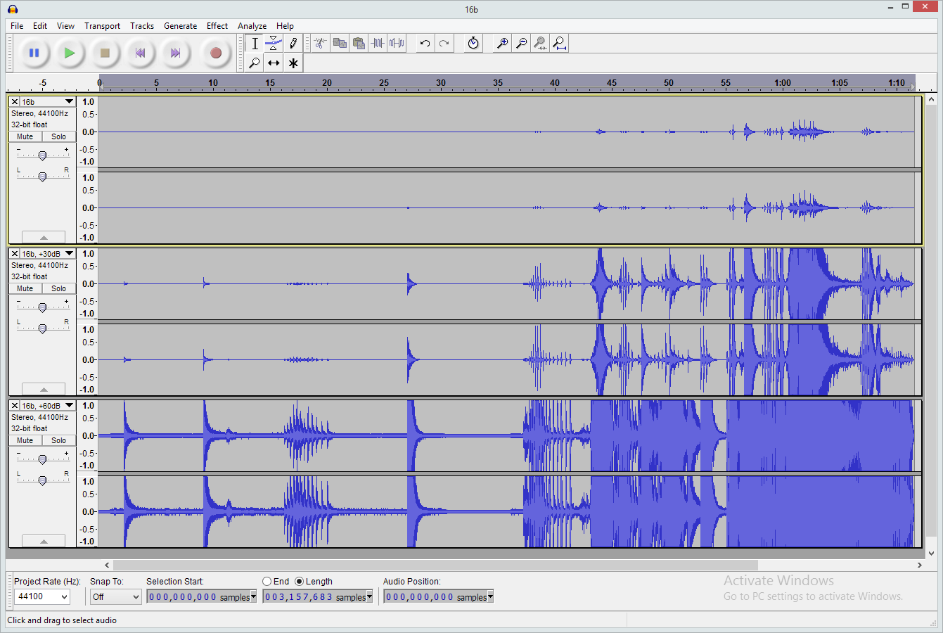

If people want to see what the fuss is about, here's Pavel's 16 bit file, then a copy amplified by 30dB - note the normally audible signals now ferociously clipping, then another copy amplified 60dB. In the latter you can see the steps of quantisation noise, along with clipping galore, 🙂; note at the 30-36 sec interval the noise has dropped a bit - this is digital silence inserted.

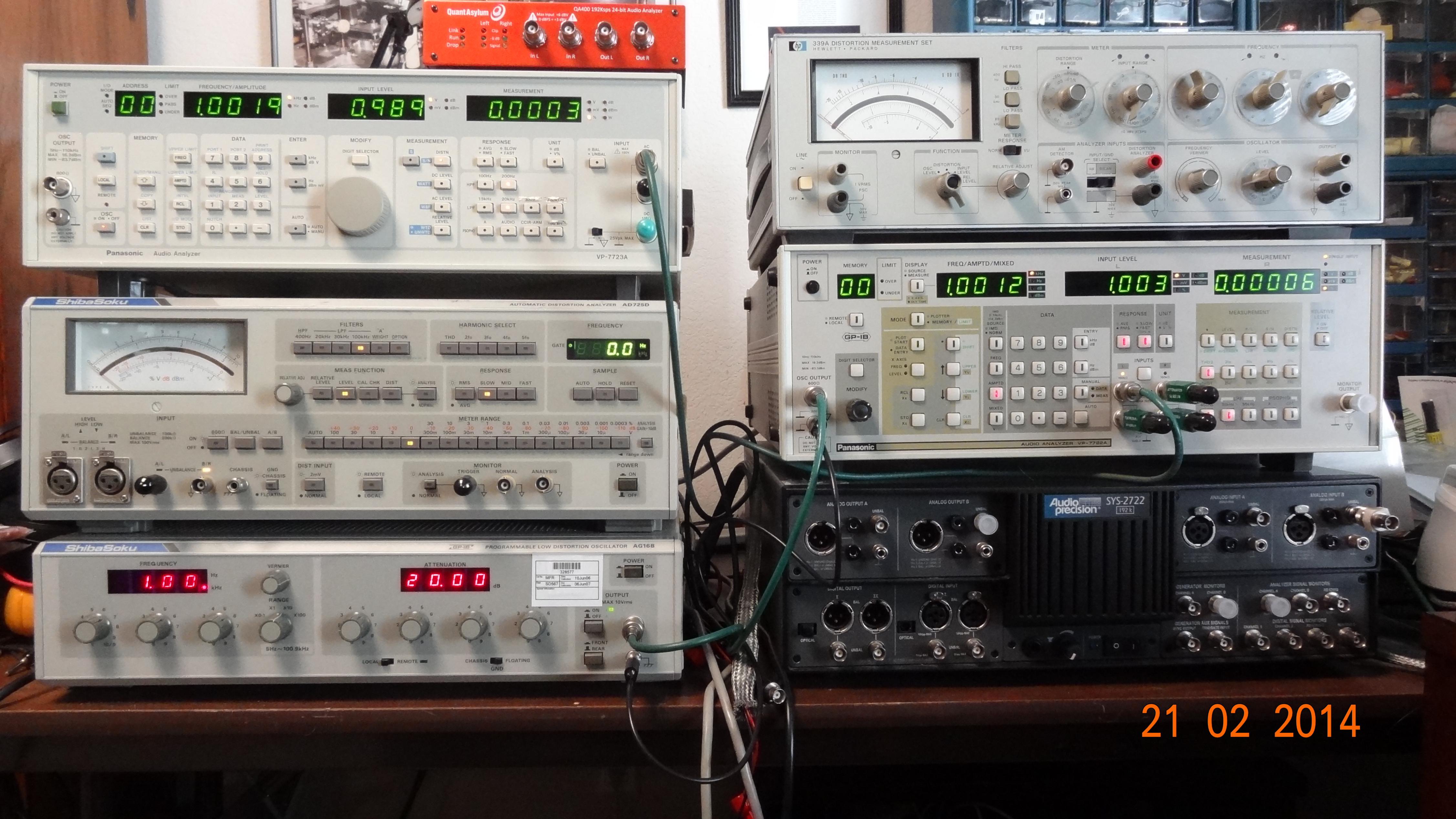

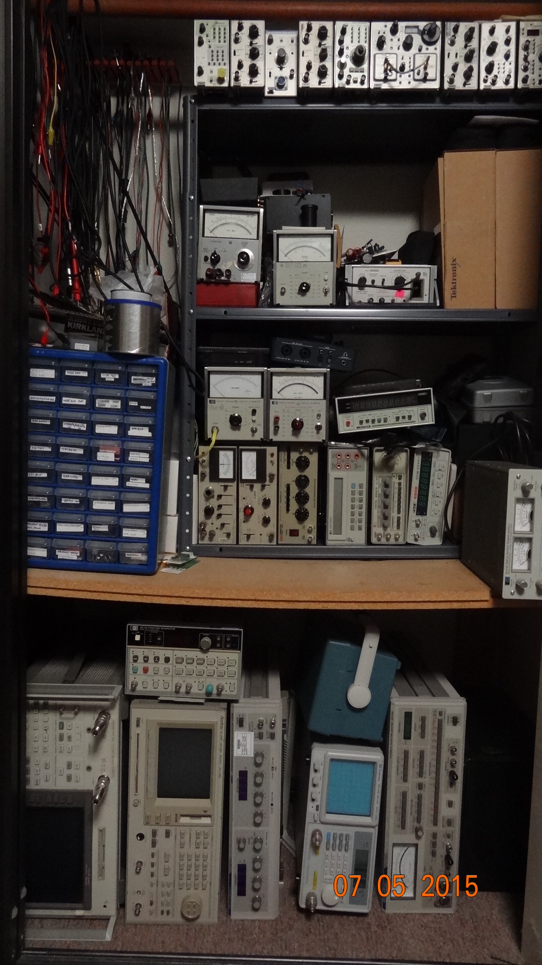

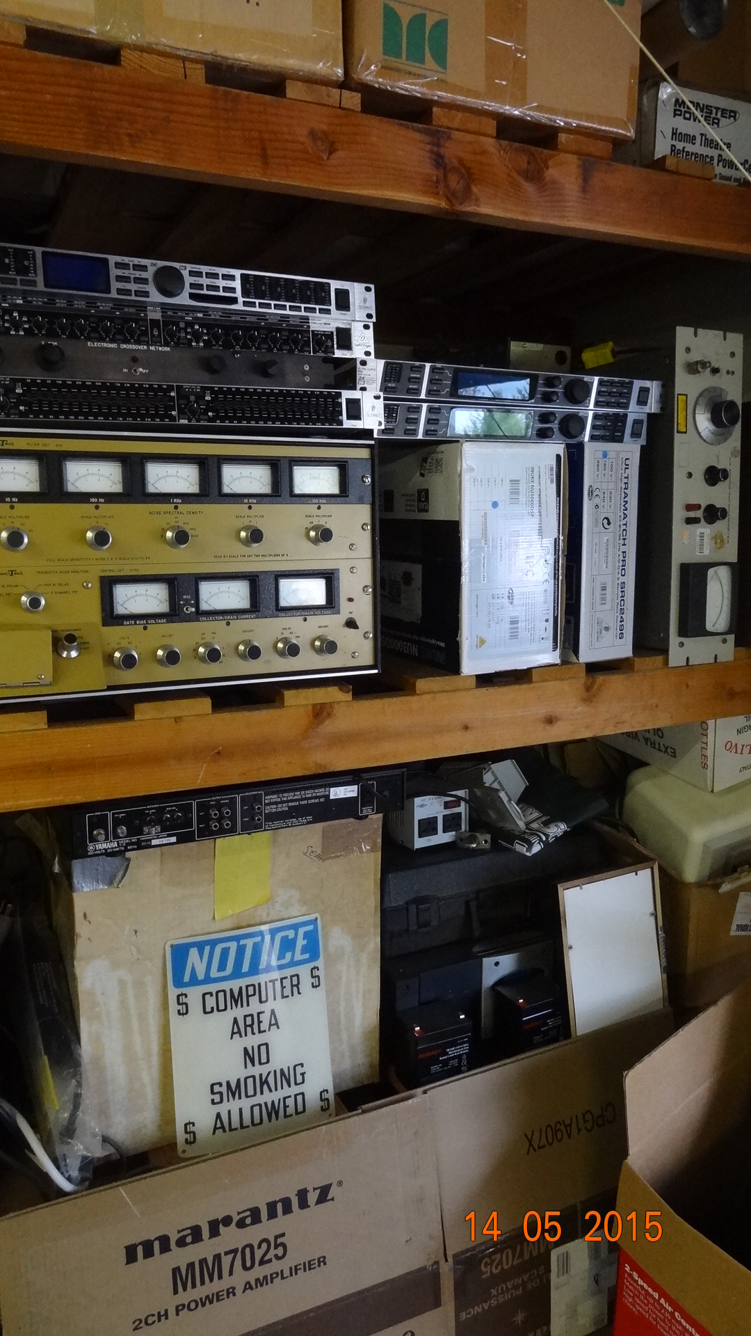

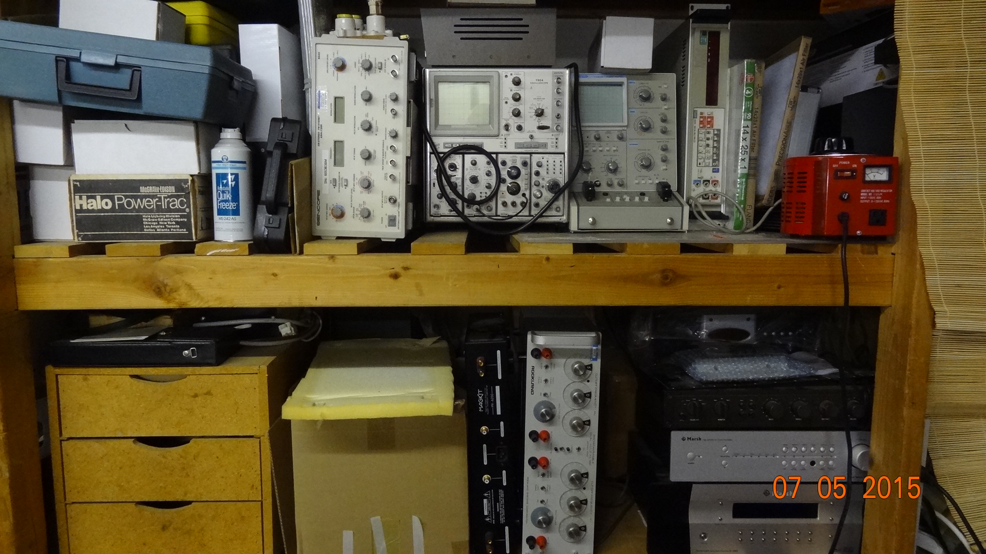

Too bad Waley doesnt live next door to me... what he could do with all these racks and shelves full of test equipment. Every few years I do a purge to make room for the next batch of instruments. I'm in that purge process now:
Making room for jitter testing and some other new items.
