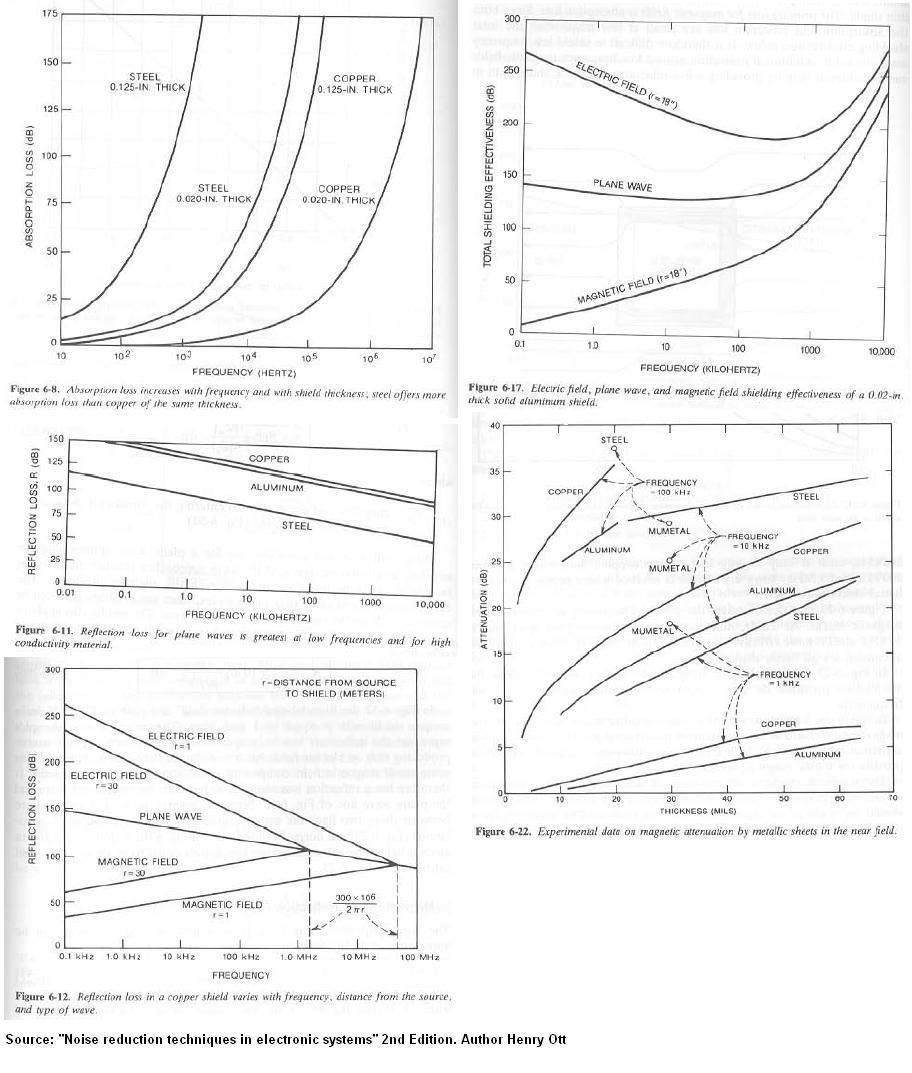

I have tried the experiment of an amp running on my bench with no top cover fitted.
Then drop on a timber top cover, or aluminium top cover, or steel top cover.
Four different sounds........and of course the resident naysayers said this is not possible, or needed DBLT to prove it 🙄.

.......Steel enclosure reflects back almost all the magnetic field that is generated internally, so, inside this steel box, attenuation of the magnetic field with distance, change drastically from the free-field case.
Geometrical details become very important as to the strengths of direct vs reflected field.
Within a magnetic field, strong coupling occurs with low impedance circuits.
George

Dan, in a power amp, any magnetic box or chassis near the high current wires induce distortions you can measure. But i doubt you could hear any differences between copper and aluminum, apart from huge EMI RFi outside, or currents in the chassis earth.Observations can be enough evidence to start a formal investigation.
All this is well known. That's the reason why most prefer Aluminium (light and non magnetic).
If you cannot avoid steel, keep the wiring far enough from the panels of your chassis.

Dan, if the issue is back reflection of magnetic fields generated inside the amplifier, either a steel or an aluminum thin top cover reflects back all the magnetic field (they differ past some decimal place of a dB) that impinges on them. With a timber cover or no cover at all, there is no back reflection.
Then it is the important issue of shielding effect from sources outside the box (see attachment for a rough picture).
And of course there is the vibration (microphonics) behavior of the top covers depending on their mechanical properties.
George
