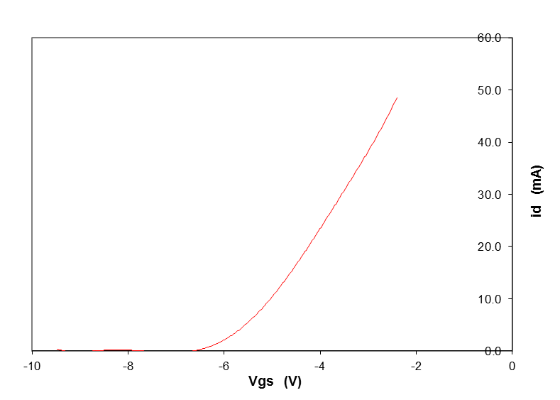

> = what degeneration resistor you will need to get the necessary degeneration to get 25ma? And then try 40ma .....
25mA Vgs = -3.9V; R degen = 156R; Yfs = 14mS
40mA Vgs = -2.9V; R degen = 72R; Yfs = 15mS
Patrick
