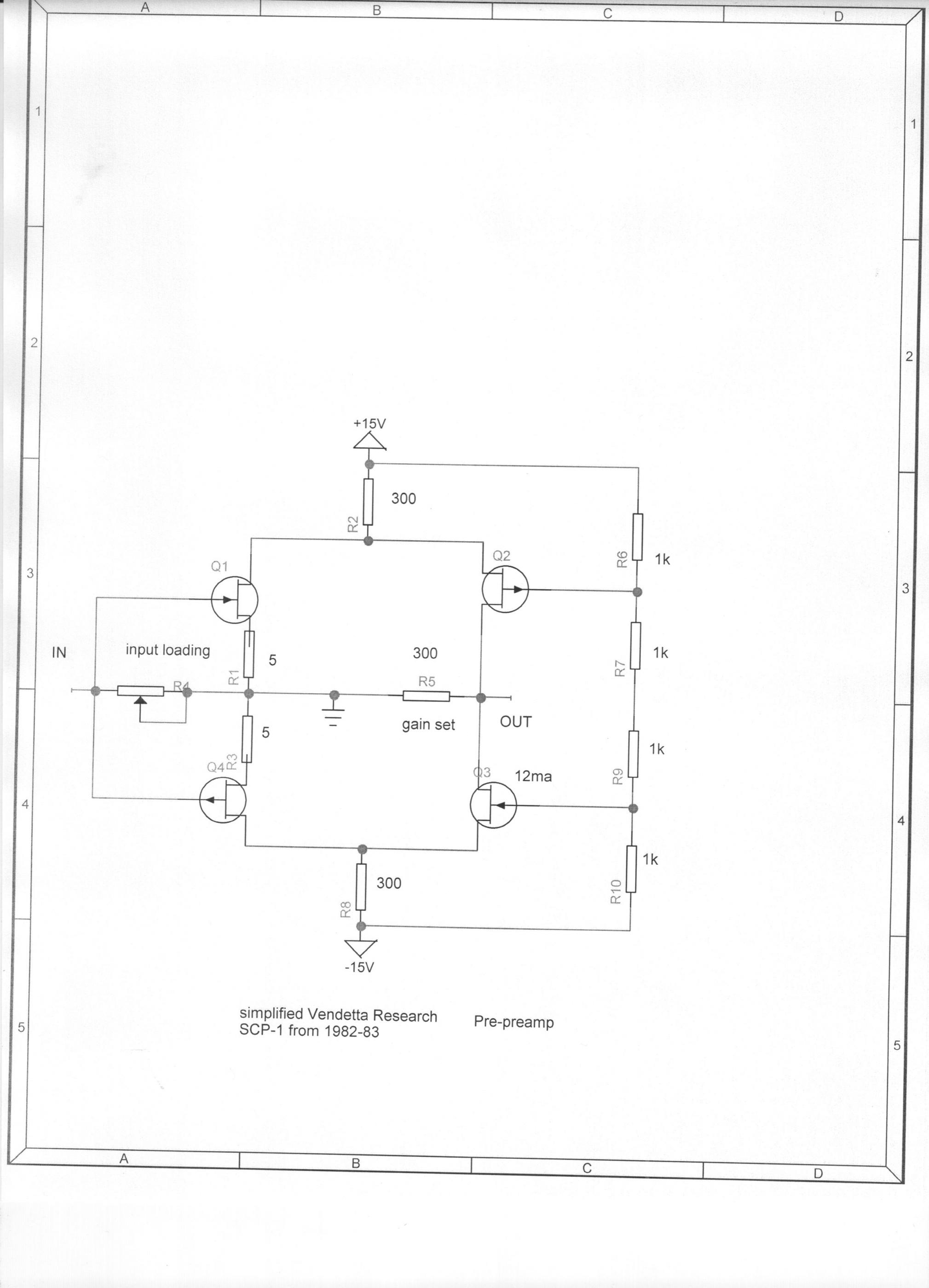

I think you, guys, are on the wrong track. Those have way too high transconductance to be used as current sources in JC's folded cascode MC stage.
It's interesting that before later parts appeared, process 51 (2N4391/2/3 etc.) was the device of choice for vidicon preamps. Then people started really shortening the channel to get higher transconductance-to-input-capacitance ratios, culminating today in parts like the BF862.
However, shorter channels also means higher output conductances, and these parts usually need to be cascoded for various reasons including lower composite output conductance and reduced lower device dissipation.

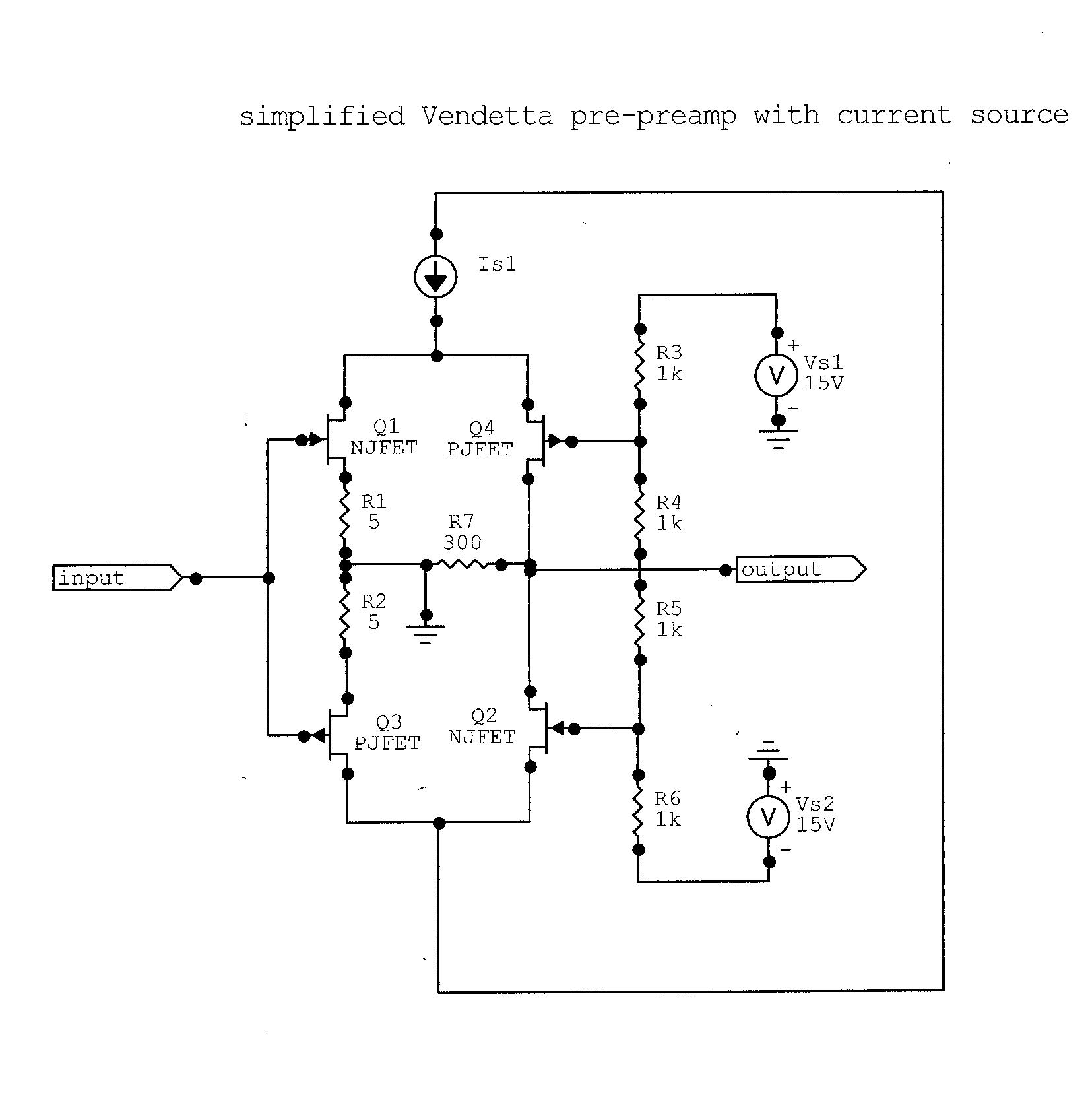

Only one floating current source, which has to be powered from a sufficiently high voltage. But one end of the resulting composite circuit attaches to the Q3 Q4 junction, and the other end to the Q1 Q2 junction. Both ends thus are anchored to the voltages on each of those nodes, in turn determined by the cascode device gate voltages of around 7.5V for JC's simplified examples.Don't think so, but let's wait for the clarification of bcarso. One thing is certain: without a return path from supplies (CCS?) to ground, there is no way to drive the output, you can just bias the transistors.
During normal operation the load current doesn't flow through the current source resistors. Think of it like a bridged class A amp - the PSU current is constant even while the load is driven. The current flowing into ground from the input sources is the same current flowing into the output from the load.
Can you post a schematic?Only one floating current source, which has to be powered from a sufficiently high voltage. But one end of the resulting composite circuit attaches to the Q3 Q4 junction, and the other end to the Q1 Q2 junction. Both ends thus are anchored to the voltages on each of those nodes, in turn determined by the cascode device gate voltages of around 7.5V for JC's simplified examples.
We are technical guys, and we thus know every detail counts: coincidentally, that's precisely where the devil generally hides...
To properly assess something, I need to have it in full details in front of my eyes, and a simple verbal description doesn't convey the information adequately.
Maybe I am just thick, but so far I do not see how it can work...
Something like JC's simplified sketch would do, we just need to check the fundamentals
Can you post a schematic, or even better a sim of what you think is happening?During normal operation the load current doesn't flow through the current source resistors. Think of it like a bridged class A amp - the PSU current is constant even while the load is driven. The current flowing into ground from the input sources is the same current flowing into the output from the load.

Where is the current into R7 coming from?BTW this is pretty much what EUVL does with batteries (or floating supplies) and a matched set of JFETs, and has an article in Linear Audio about it as well as a thread in here. It works just fine, both in sim and in real life. It's not fully complementary like the Vendetta, however.
I only see the input, or Vs1, or Vs2 as possible sources, but that would be problematic
I will show a practical example, but remember that the power for Is1 is from a floating supply of whatever voltage compliance we need. Although looking at the schematic for such a current generator we typically identify one terminal as the high-Z node and the rest of it low-Z, in this case as it is floating both ends are high Z.Where is the current into R7 coming from?
EUVL has one version, Sen, of his I-V converters (which can be described as current conveyors with resistive output loads) which has an upper JFET as a common-gate config and a lower device as a current sink. Then a floating voltage source ties from the upper device drain to the lower device source, and there is a divider across that sets the output voltage to about half of the floating supply voltage. That center tap gets loaded with a resistor, which determines the conversion gain, amps in to volts out. The overall polarity is non-inverting. If you consider the lower device and the battery as functioning like Is1 on my schematic, you can see how it works.
So we know the top of the battery sits at about 7.5V, and we know the drain of Q5 sits at about -7.5V. If Q5 and R8 need another 15V to work well, the battery voltage needs to be 30V so that the gate of Q5 is at -22.5V. As noted the impedance of the I source thus realized could be raised appreciably with a cascoded JFET, but we'll need still higher battery voltage.
Brad

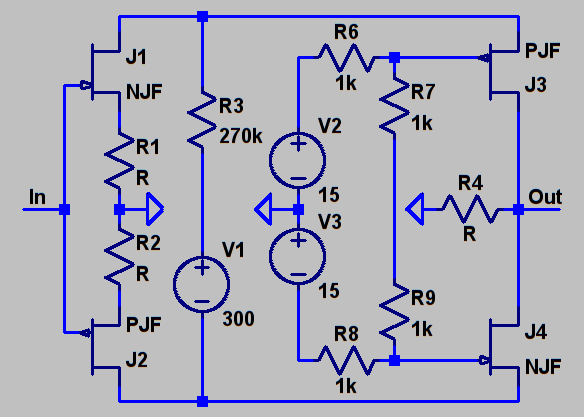

Elvee, the second two Jfets are cascodes, with their drains at the output. So the output current comes from the input Jfets, not from the resistors.
Here is what I'm thinking.
Isnt this a 'folded' cascode... complimentary version. gain set by R7/300 Ohm....making cascode also like transconductance stage.
-RNM
and the noise
Put an additional I gen across the floating I source and observe the output voltage on the 300 ohm load. As mentioned earlier, owing to the imbalance of capacitances and to some extent conductances, the nulling is not perfect but dramatically better (lower) than the noise gain to the output from independent I sources.
Yep. It's JC's simplified circuit, with just the 300 ohm pullup and pulldown resistors replaced with a single current source.Isnt this a 'folded' cascode... complimentary version. gain set by R7/300 Ohm....making cascode also like transconductance stage.
