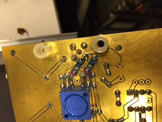

Tacked on resistors at the input should be OK. It is impossible to say for sure, because the A was converted to a B, by rewiring the second stage board on the bottom. All resistors should be Resista (banded) or Holco (black).

Thanks, John, you saved me a lot of time tracing things out. The jumpers on the back look like wire-wrap wire (don't know what it actually is). If this looks normal to you, I'll proceed assuming that it follows the schematics.

Now I do, after replacing one pair of pass devices (on the minus rail of the first stage, I used J271). Cap on the output seemed OK, but I replaced it anyway, just to be sure (polypropylene). I'll do signal tracing next, once I get back down to my lab. I basically needed to know if what I had and the schematics were pretty much the same. Since they are, you've saved me a bunch of time tracing out what some modder did.
There's a lot of modders out there who assume they know things that the designer didn't; it's rarely true. So that's why I'm being perhaps overly cautious.

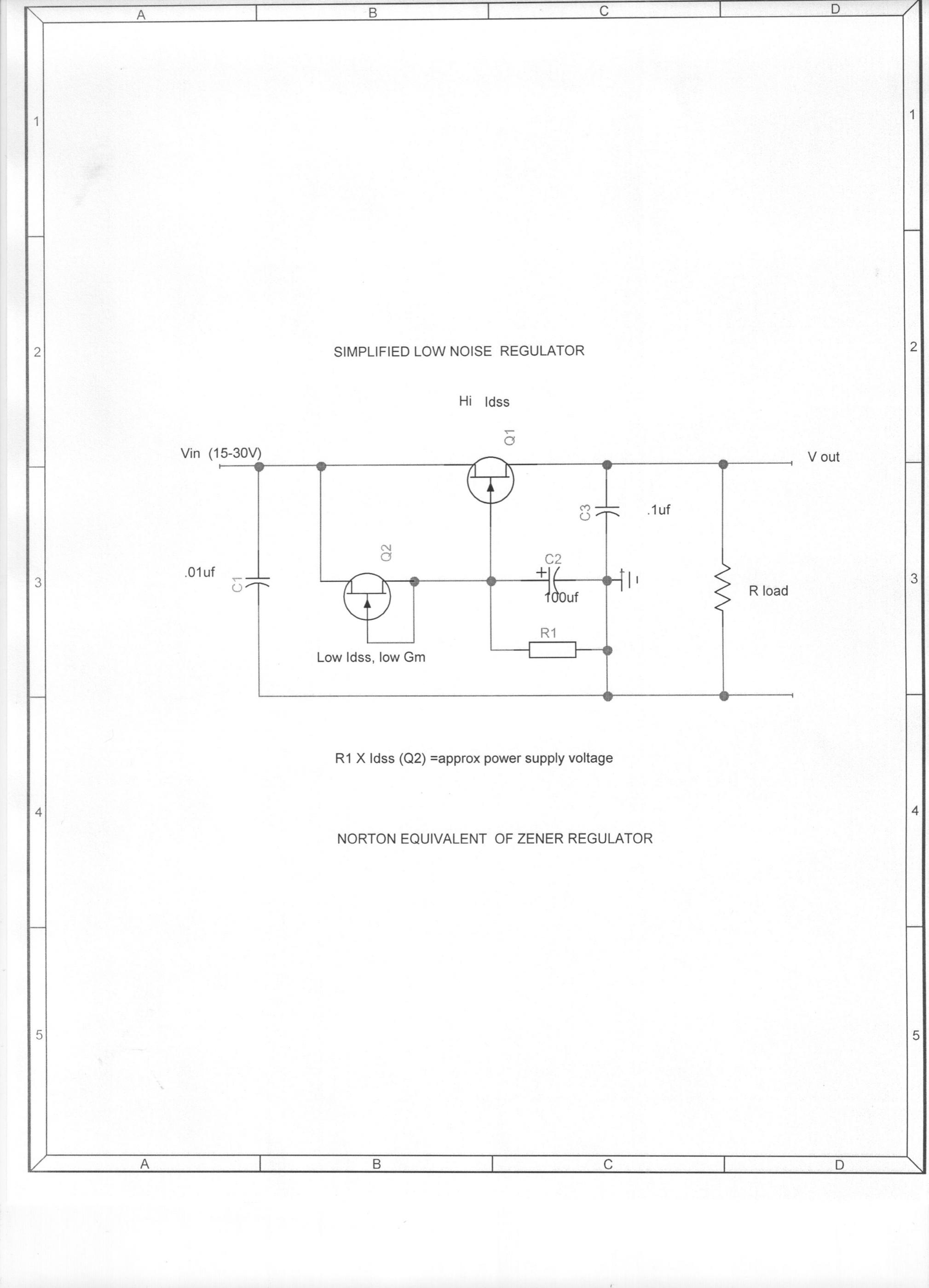

BTW a couple of drafting errors: C2 is reversed, and Q8 is labeled J203 but is shown as a P part. I guess it could be a J203 if it were turned upside down.
On the schematic posted earlier for the SCP-1, what should the regulated voltages be?Question 1, SY. Do you have regulated voltage for each gain block, AFTER the individual cap multipliers?
Thanks John.The supply voltages should ideally be +/- 18V. This is because the servo IC is on this line as well. IF I did it over again, I would separately supply the servo with +/- 15V.
Yes I figured the AD711 would be one guide to what the voltages are.
