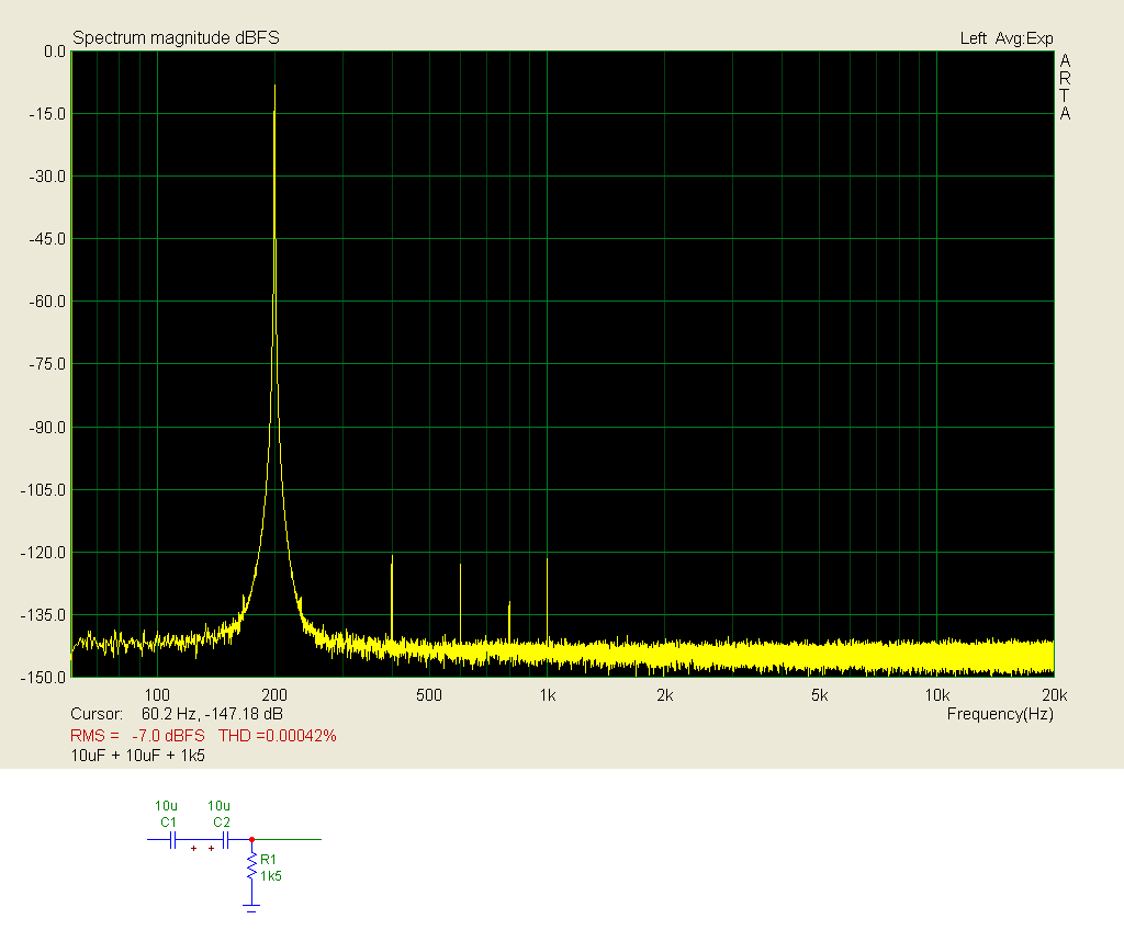

Polar capacitors
I am sorry but I am not able to find harmonic distortion in a standard, 10uF/35V electrolytic capacitor. Two in series, no bias, resistor load, pls see the image with circuit shown. That 0.00042% is a sound card distortion.
P.S.: input AC voltage is 1.55Vrms
C.Bateman measured high distortion of polar caps in his writings.
THx-RNMarsh
Yes but he specifically noted that DA does not cause audio distortion. I posted that article fragment a few days ago.
Also, note that when Bateman talks about polar caps he does not mean electrolytic polarised caps but capacitors build with polar dielectric. Completely different.

I also do not find the idea to apply AC voltage across unipolar electrolytic capacitor to be the right one. At least, a series bipolar combination of electrolytic capacitors should be used, as in my measurement in a post above.
yes. BUT that wasnt done and still isnt done univerally.... look at most any reciever... polar caps for coupling.... with zero bias on them. I have a new Marantz I looked at because it use CFA topolgy.... polar electrolytic coupling caps...... still. And 2-4 of them in series (Bal/unbal on I/O of opamps). 😱
