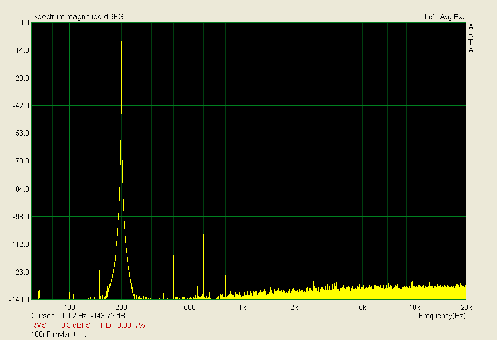

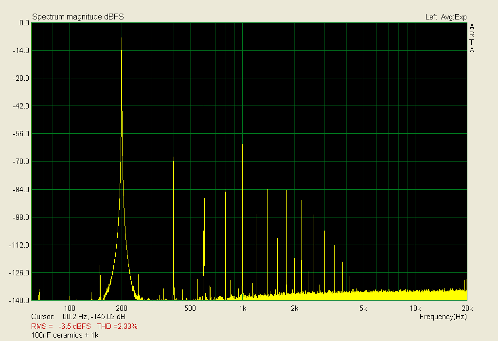

Look, this is the ceramic cap (I have shown yesterday distortion plot), C-R 100nF+1.6kohm, above any words. Input is clean sine.
Voltage excursion across the cap is significant, and distortion looks symmetrical.
I suspect this distortion is due to voltage-dependend capacitance reduction on a MLCC with no DC-Bias applied
Please could you give the exact type of cap, or at least its blocking voltage?
Tesla TK683, 100nF, 32V. The type probably does not help much.
This is the distortion plot at much lower voltage. The distortion is only roughly symmetrical, from scope screen. Spectrum shows it has all components.
