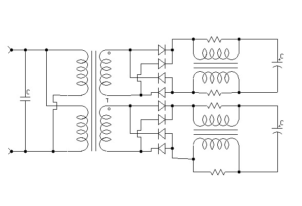

I was going to go on about power supplies if the OPINIONS on DA are done.
Attached is a basic power supply as JC sort of has shown here.

You raise a good issue. Standard practice is to put capacitors across each diode. I have seen 10 nF suggested as the value.
JC of course uses a diode that has low switching noise.
I forgot to make one thing clear, this discussion is about low power supplies as would be used in preamps!
There are so many places to start the discussion.
AC mains noise?
Avoiding unbalancing the transformer?
Diode noise?
Transformer noise?
Surge currents?
Ripple?
Filtering vs frequency?
Circuit theory components not shown in the schematic?
