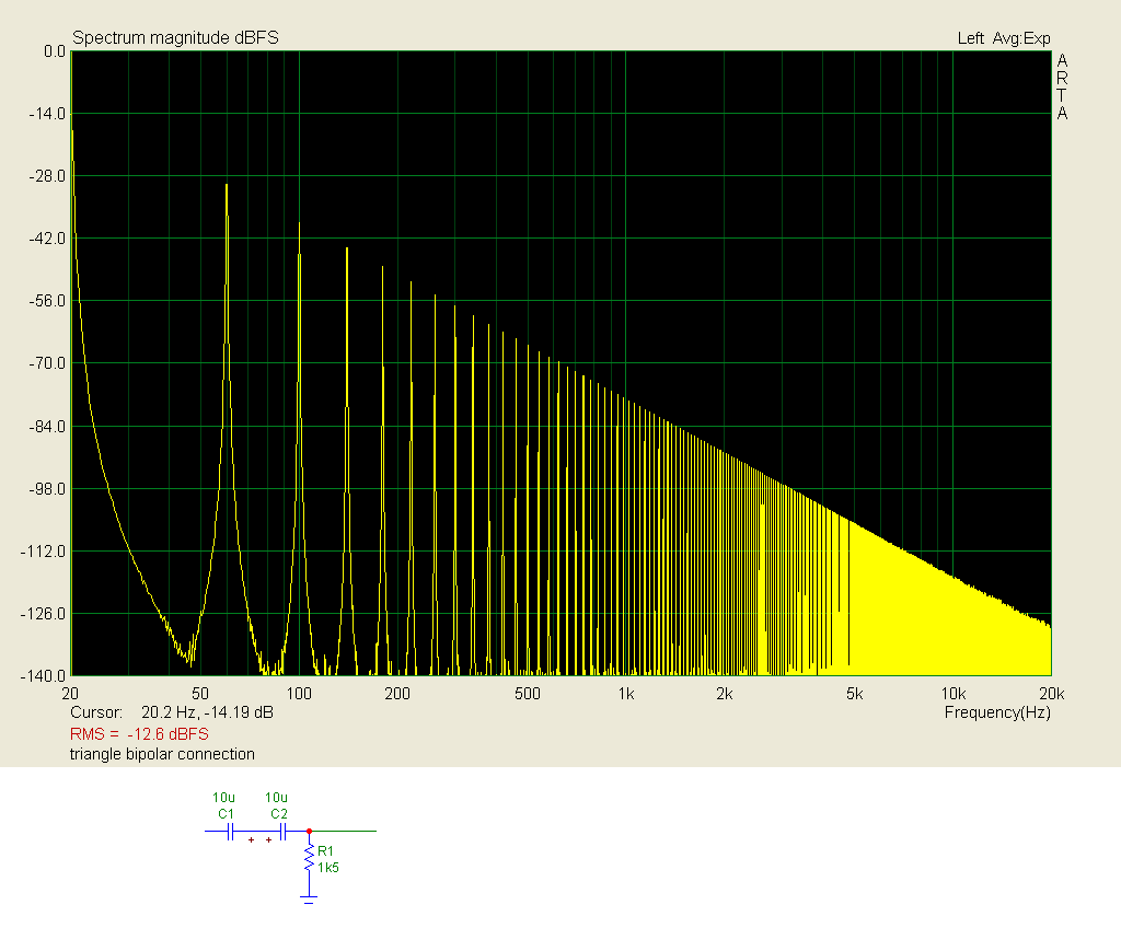

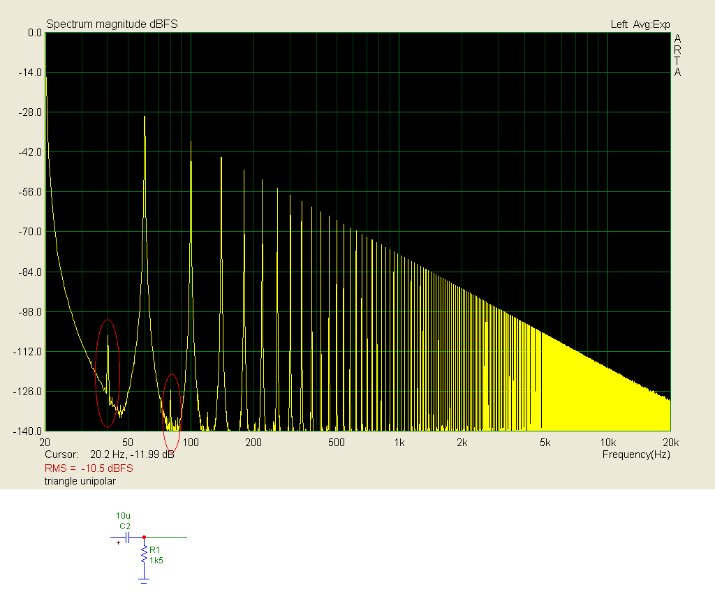

LTspice. In the above, if compression is turned off, and the Maximum Timestep is set to 1u sec then the distortion goes away ...

For bi-polar -- sorry yes that cancels very well the non-linearity.
RNM

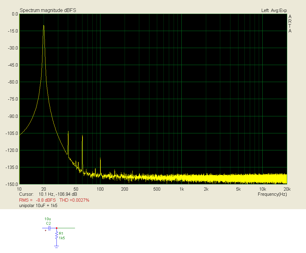

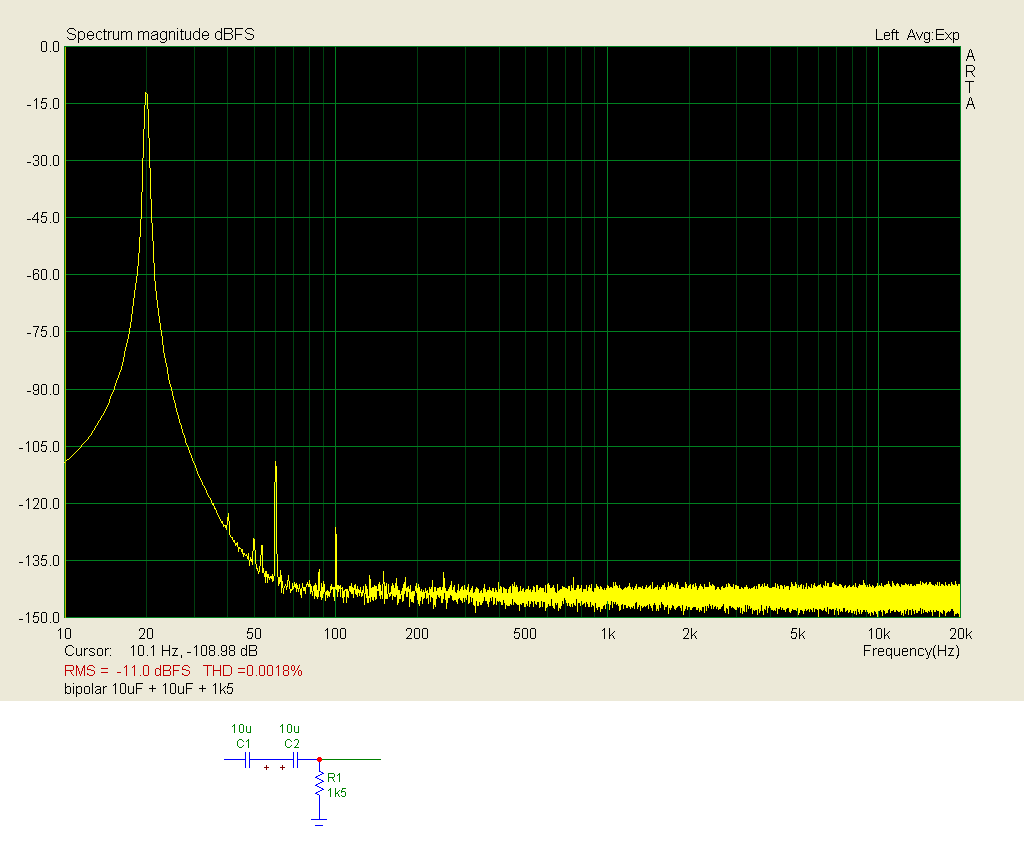

Yes, it cancels even harmonics (in this measurement the H2), in case there is more significant voltage across the capacitor terminals. Pls see the comparison unipolar x bipolar cap circuit test. At 200Hz, I had the same result for unipolar and bipolar. But, at 20Hz and component values used, we may see the difference.

I agree, in electrolytic capacitors the 2nd appears when we have notable AC voltage across it, that said, the cap is also inversely polarized and it reflects in asymmetric distortion (the 2nd). Take two caps in series, bipolar connection, and the 2nd is canceled, in case we drive it from zero DC component generator.
Lets go. (I'm not the king of the simulation, so if anything wrong, please tell-me):
