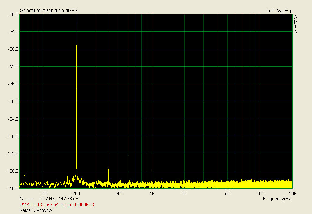

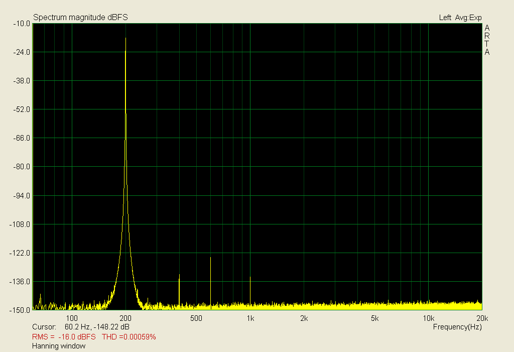

Pavel,
I see a lot of fundamental base spreading, is this an increase in noise or just due to the FFT?
ES
What exactly do you mean, Ed. Would you please explain in simple English, thanks.
If you speak about width of the 200Hz line spectrum, it reflects FFT resolution + Hanning window shape. At 2kHz, it will be narrow. At 20Hz, it will be even broader 😉
You got it! If you try a film cap under the same conditions and the spreading at the lowest levels of the fundamental do not change, it is the limit of the signal processing. When the skirts widen up a bit at lower levels this can be noise modulation. Often worth doing band limits near the fundamental to look for this.
With all respect Ed, this is a nonsense. Please try to learn about FFT and windowing basics. If I used more points in the FFT record, the line would be more narrow. If i use something like 2K FFT, the width will be over several hundreds of Hz. Please let's not waste time with fundamentals.

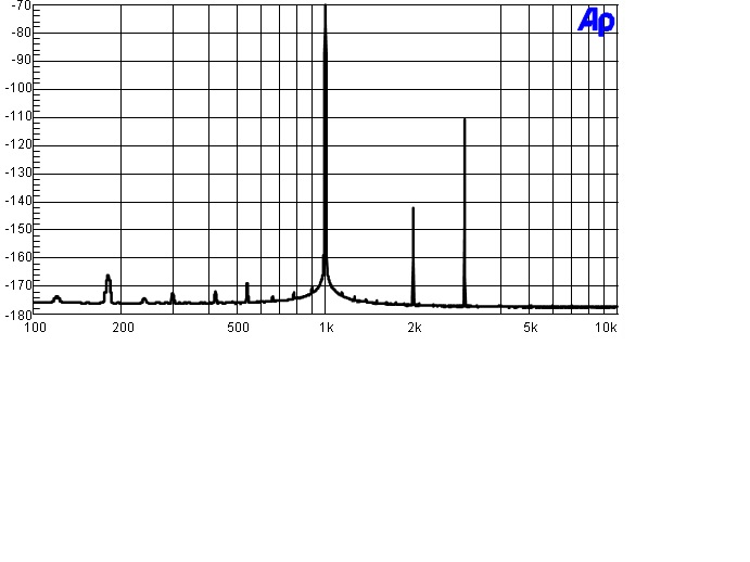

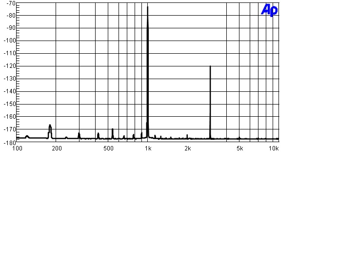

Attached is an example of noise induced low level spreading. The first shows the noise, the second is the FFT limit.

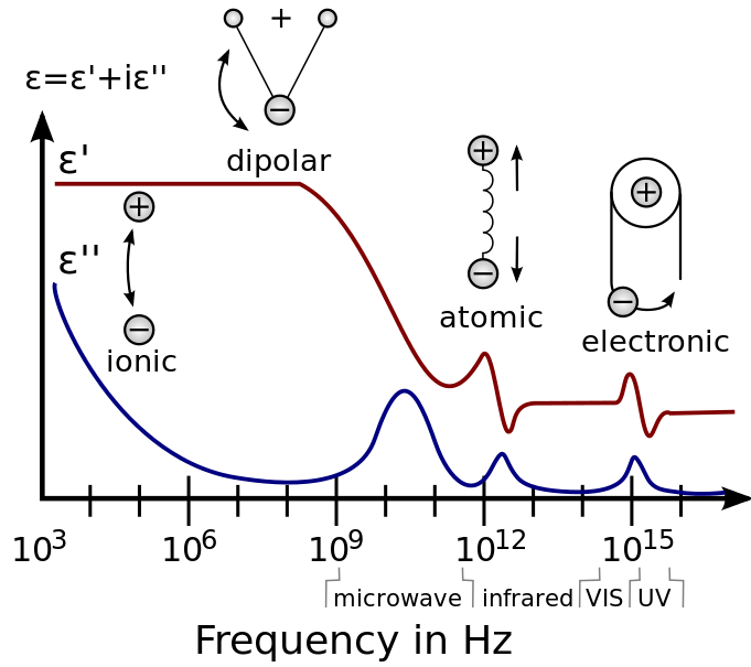

Dielectrics are not necessarily perfectly linear, and with multiple dependencies.
Charging or discharging a capacitor (dielectric assembly) is not simple, certainly not a simple as the spice models proposed.
A dielectric permittivity spectrum over a wide range of frequencies. The real and imaginary parts of permittivity are shown, and various processes are depicted: ionic and dipolar relaxation, and atomic and electronic resonances at higher energies. From the Dielectric spectroscopy page of the research group of Dr. Kenneth A. Mauritz.
