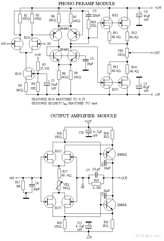

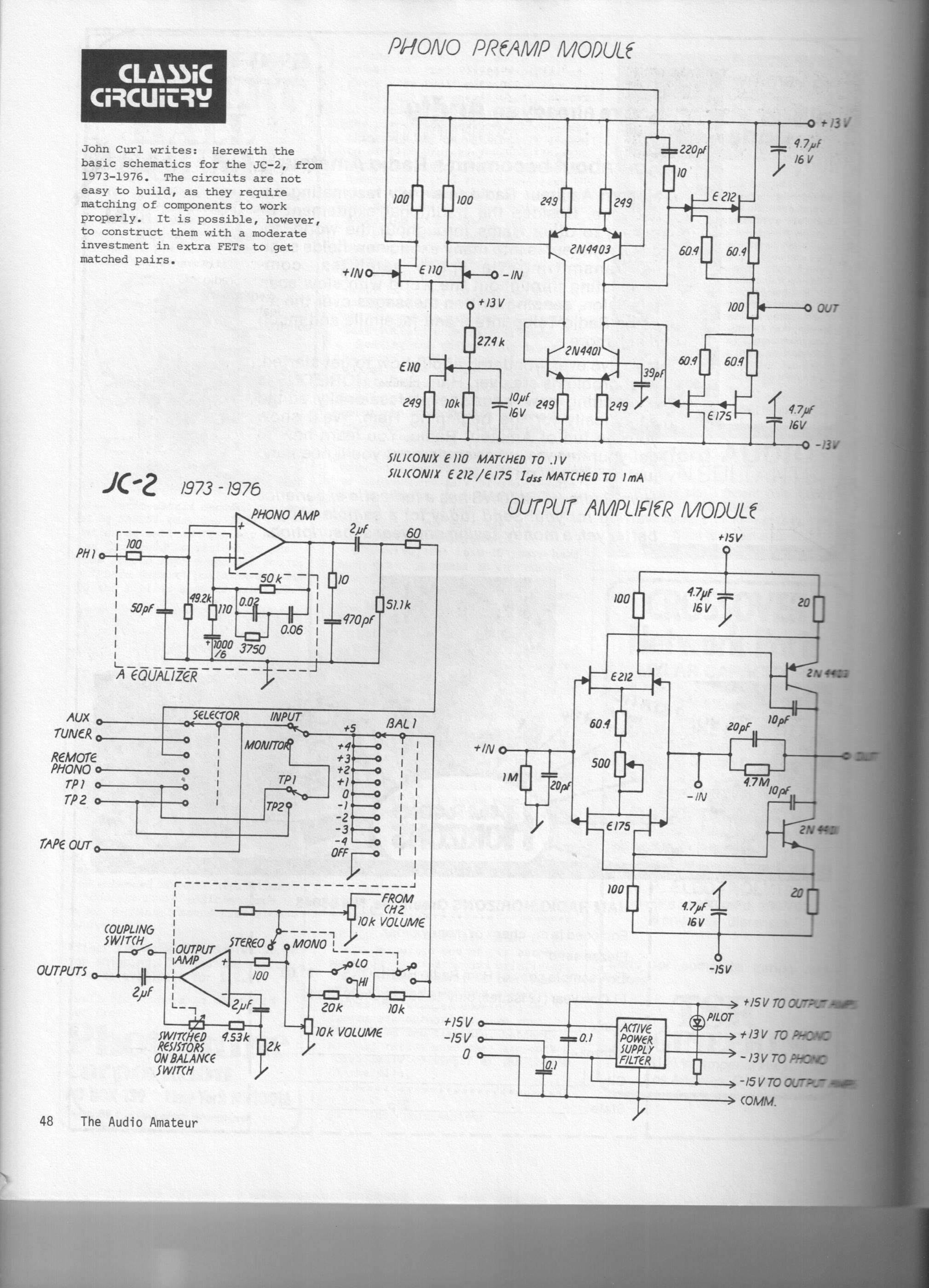

Combined Levinson JC-2 schematics.
Note: There are several typos on these schematics, so please contact me before thinking I made a serious mistake.

In a preamp as it is evolving, with, I hope, high-end performance and sonics for a quasi-mid-fi price, following some old designs but with a twist, the first section is active feedback with the 75us pole, with 40dB gain at lowest frequencies. Then the following stage supplies a shelf with the gain at low frequencies another 20dB, falling to 0 dB at high frequencies. So the overall gain is 40dB at 1kHz, with an accurate RIAA characteristic. The first-stage "a.c. integrator" helps the high frequency overload a lot, and also works well after an inversion to drive the synthetic termination components.Given that a lump of muck can give you a nice transient out into the 50KHz region and the first stage hasn't got that nice 20dB of HF attenuation (or even 40dB if you are entirely passive) you need a significant OL margin even if the output never goes above 2V worst condition.

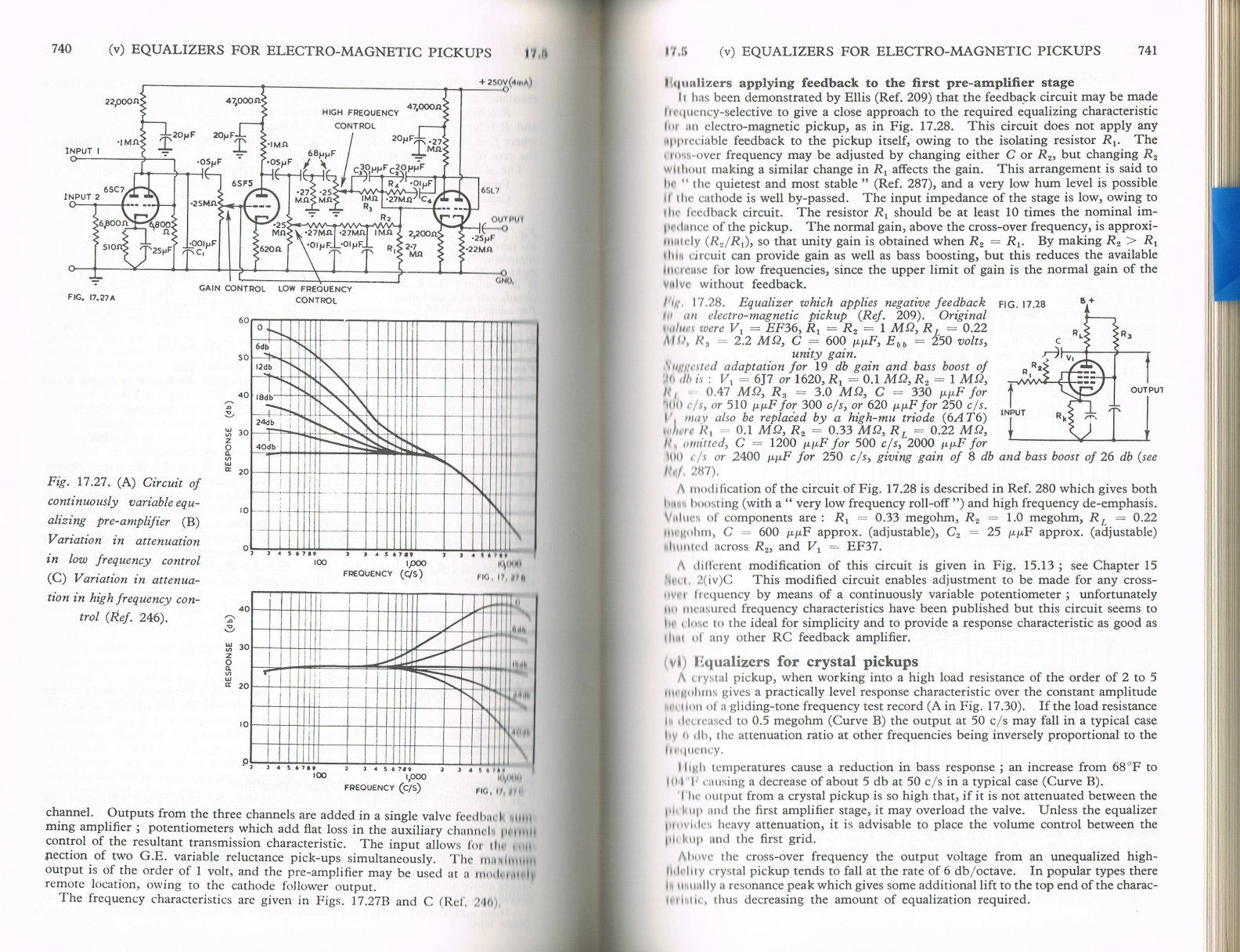

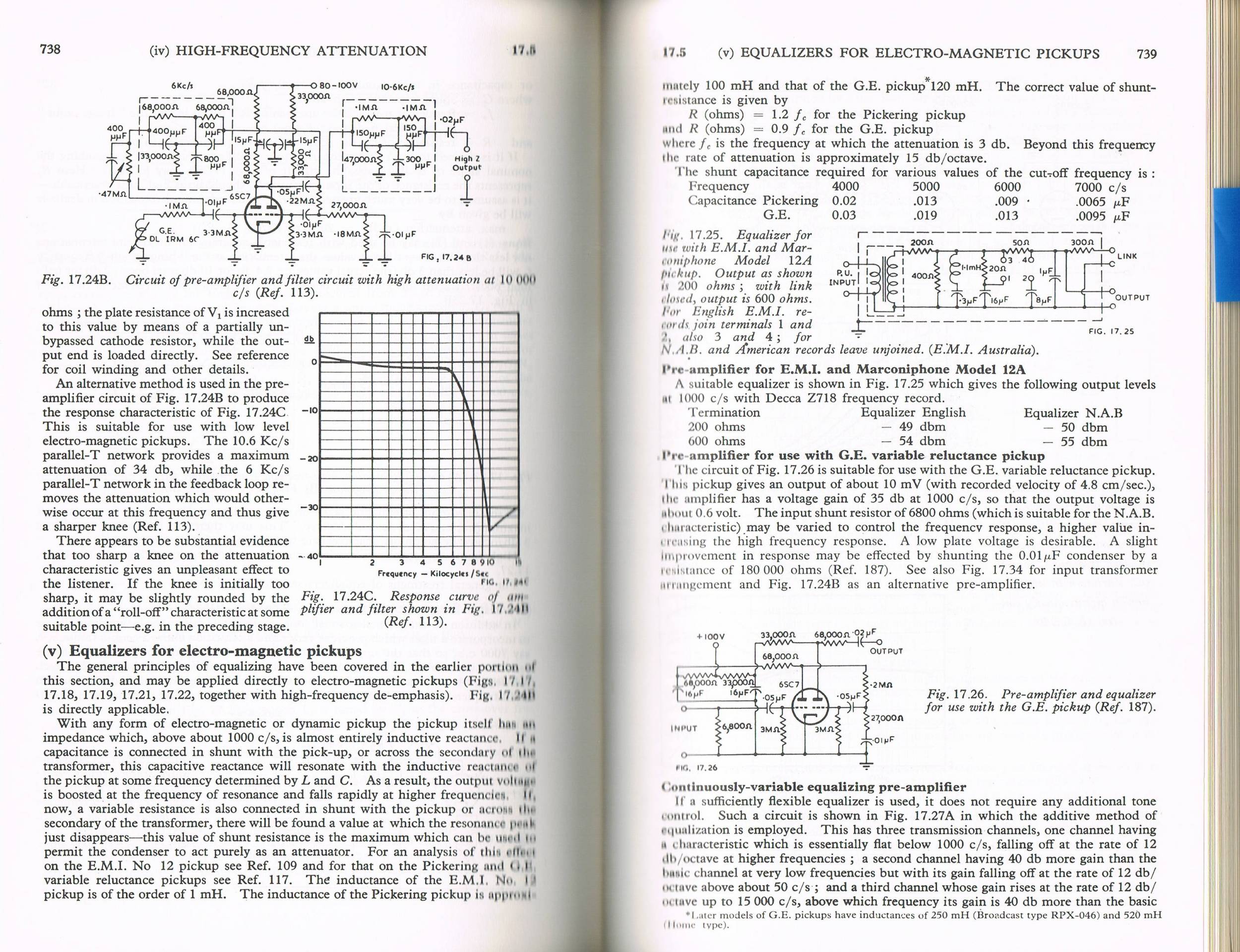

@ Richard and other's...I can post a couple of pages from the
Radiotron Designers Handbook, they have some tests and circuits
from the 1952 publishing date.
If you have it, chapter 17 might be of interest are the published
test records from the industry. These go from 78 to 331/3 LPs.
They are all in written format so one has to read the specs.
I am unsure how to interperate it when some of the cps ranges
are +8dB etc. Are they to test the boarders of the EQ for the
preamp/cartridges recommended by each manufacturer/recording
company: for example, R.C.A., Colombia, etc?
I'll post them shortly

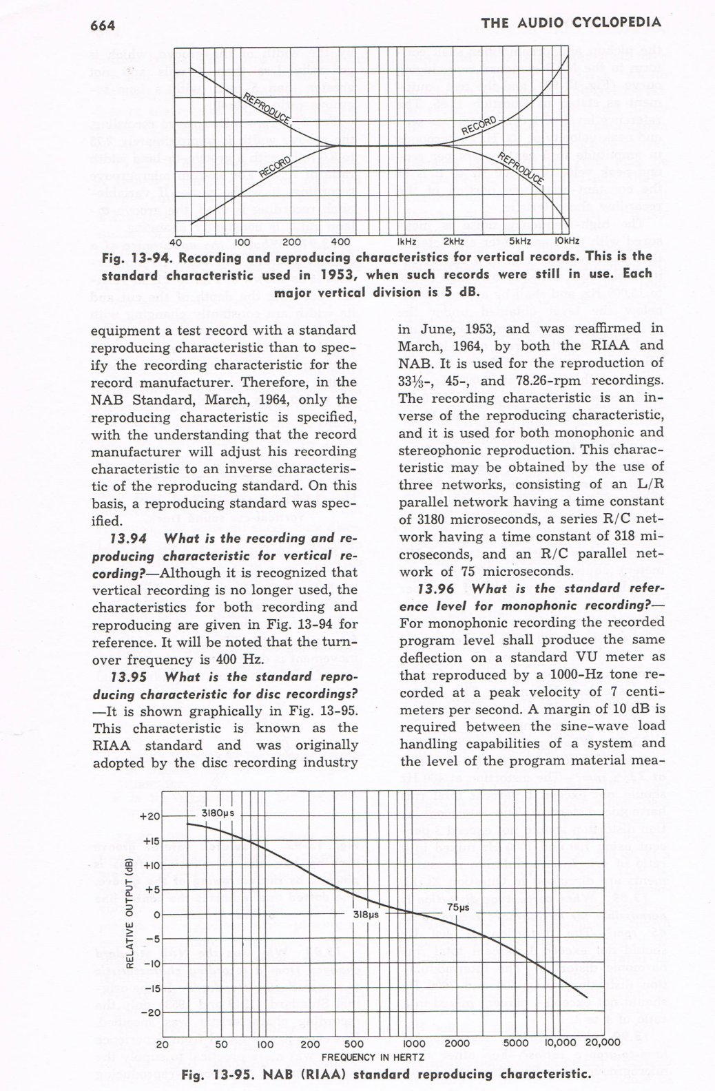

Also-
Howard Tremaine's Classic book Audio Cyclopedia goes into phono EQ curves in great detail.
