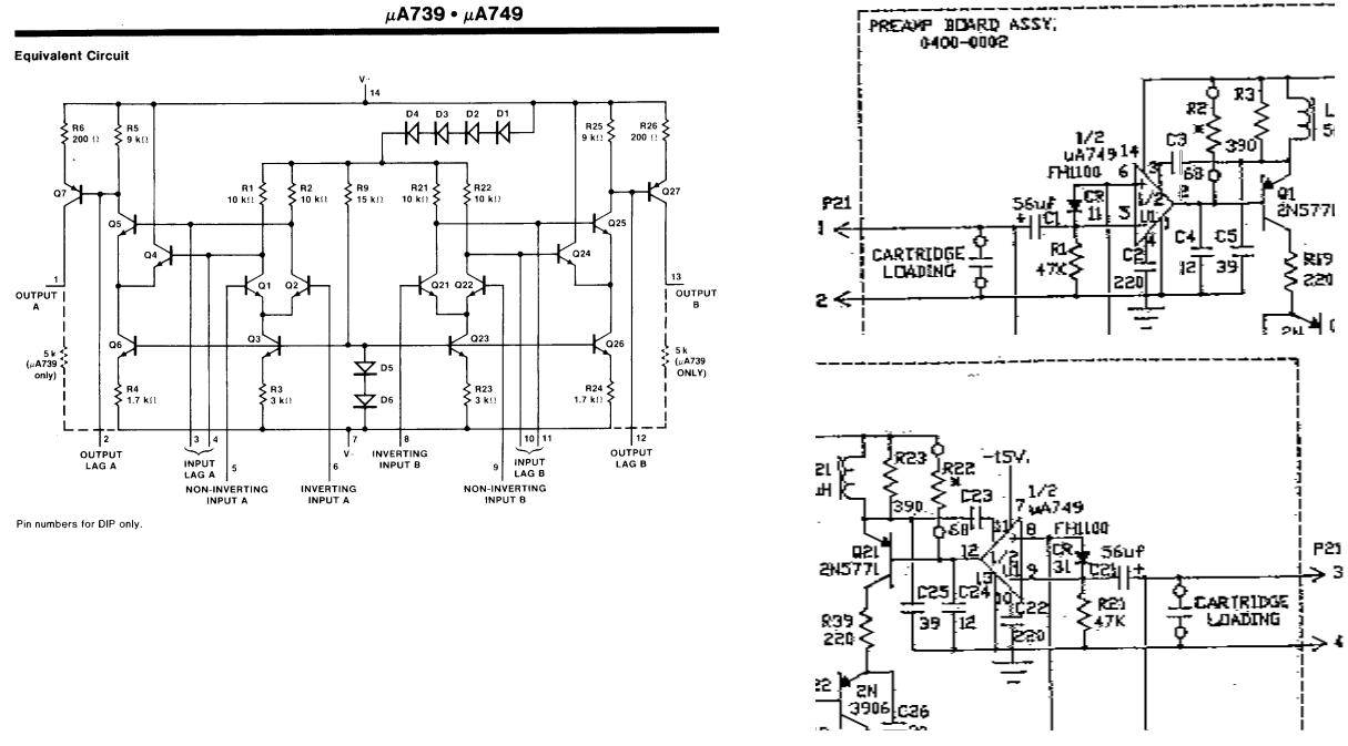

I am reading the AG511 schematic.
Aren’t there any problems when directly grounding pins 1 and 13 of uA749?
(output is taken from pins 2 and 12)

Those are current outputs so it doesn't really matter where you load them, as long as it is within the voltage rating.
Jan
Thank you Jan and Scott.
I will simulate the circuit to see what is going on because I don’t get it (not your fault).
George
