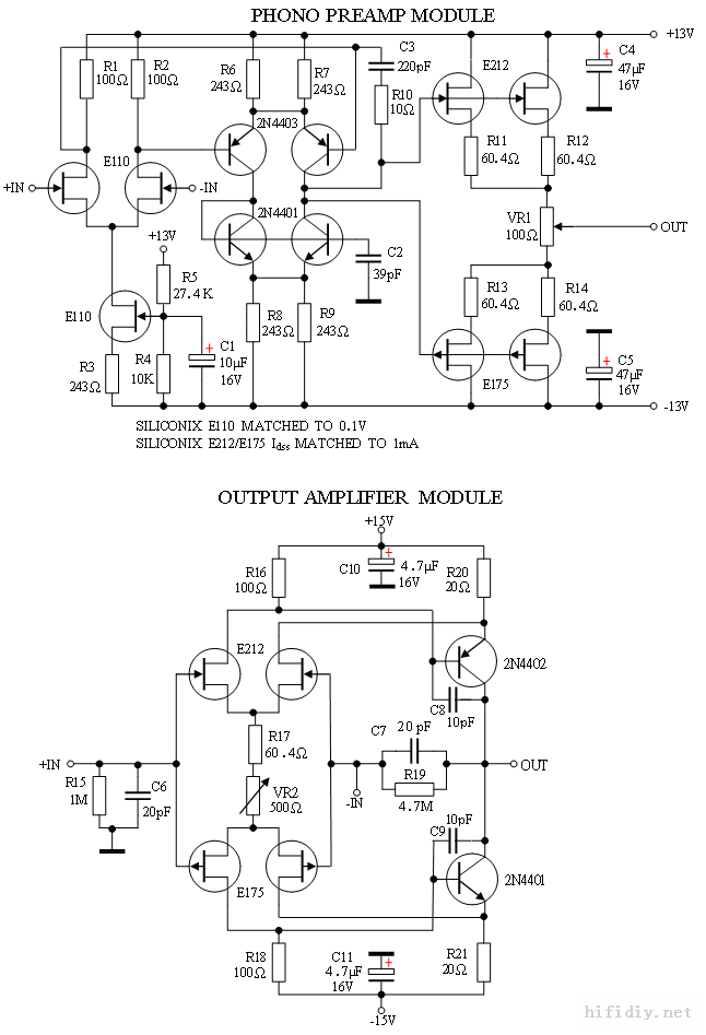

I will simulate the circuit to see what is going on because I don’t get it (not your fault).
George
Look at it this way: that output delivers an output current. If you connect a resistor between that collector an ground, that current will develop a voltage that you can use as output voltage.
As you lower that resistance, the output voltage gets smaller and smaller of course. Until the resistor is zero and the collector is effectively at ground, and Vout is also zero. But as far as that collector is concerned, it's all the same. It will faithfully deliver that current, into the ground node, and consequently its collector voltage is thus zero.
Jan
Thank you Jan and Scott.
George
He simply used each half as two LTP's and took the output from the compensation node. You can do that with the AD844 or AD744 too. The noise in the BAS article was exemplary, even better than the JC-2 but I could not find a spec on the data sheet (was there a graph?)
Using only the npn's would make the speed much better, at first glance this looks like a nightmare to stabilize.
Ah yes from the days of lateral PNPs.

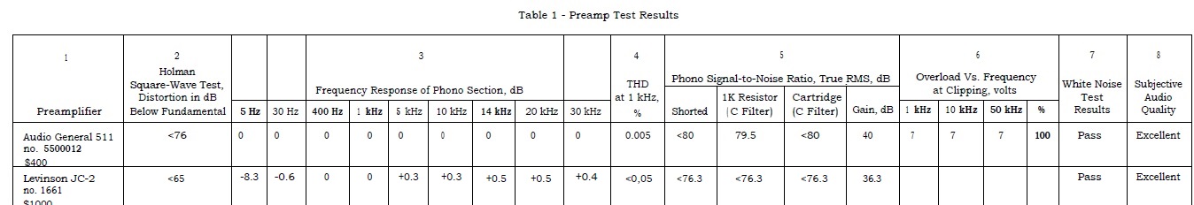

I have to go back and read the BAS article again, as yesterday I was in a rush to get a friend's dog to the vet, yet couldn't pry my eyes from the piece. In particular I did see something about the "white noise" generator going out to a MHz or something, and an inverse RIAA network, and the criterion being that the preamp output still sounded white?
It would be interesting to determine the correlation between that perception of noise, and the DUT's overload margin measured in a conventional way. Also, as Otala's TIM was the big new thing around that time, was it really involved?
The AGI 511 was a seriously engineered product, but it could not be very quiet. The final feedback resistor limits the minimum noise to 4nV all by itself. We used 60 ohms. However, the AGI was FAST! Faster than the JC-2 phono stage, for sure. Was it necessary? It did help, but it was probably 'overkill'. The JC-2's phono stage had a slew rate limit that was lower, mostly because of the difficulty in driving the RIAA network (60 ohms) rather than 1000 ohms like the AGI 511.

It seems a trifle strange that the S/N doesn't change more with a 1k source impedance. And although a cartridge was used for some of the tests, what would have been interesting would have been an inductor in series with the 1k of order the same value as the cartridge, since this would increase the high frequency noise from the termination R and input parallel noise. Of course the weighted measurements would conceal this to a great extent.

JA has gotten the notion from somewhere that the most demanding test for noise of an amplifier or preamp is to short the input and run at maximum gain. I have no idea where this comes from---the only situation I can envision would be where the input stage has a first resistor going to a summing node, so you get the voltage noise of the stage amplified as much as possible, and of course the resistor's thermal noise. But a more likely input is just the initial active device's control electrode---a bipolar's base, or a JFET's gate, or some paralleled combination of such.
If a bipolar, the base current noise is being ignored with such a grounded input. For JFETs the parallel or current noise is small.
With MM, or high-inductance MC (rare, and an example the Ortofon X5-MC) the parallel noise is important, as is the thermal noise of the cartridge damping resistor. So for phono preamps we need to assess this noise, as well as the series or voltage noise. It should be sufficient to measure with an open input and a shorted input, and determine what the parallel noise contribution is for a given cartridge, knowing the latter's inductance and resistance. The preamp would have to be stable with an open input.
Out of this we should be able to accurately estimate the overall signal-to-noise ratio of the system, including the thermal noise of the cartridge, the latter which one hopes will dominate. Of course surface noise adds a bunch, but I don't think excuses poor performance of the electronics.
Another approach would be to synthesize a cartridge of some roughly representative L and R, and to make life easier use a synthetic resistor for the bulk of the R, with much less than thermal noise.
I agree. Many of these are important issues. I address many of them in my VinylTrak preamp article published awhile back in Linear Audio.
Bob
I noticed the subjective ratings did not follow S/n or thd... some better specs than JC got rated Good while the JC was Excellent.
Nothing has changed since then in the measured vs sound quality debate, it appears.
However, over time, JC designs have been consistent in their subjective ranking by a wide variety of people and groups. Could it be then, JC actually does know what else is needed but we arent listening or asking the right questions?
