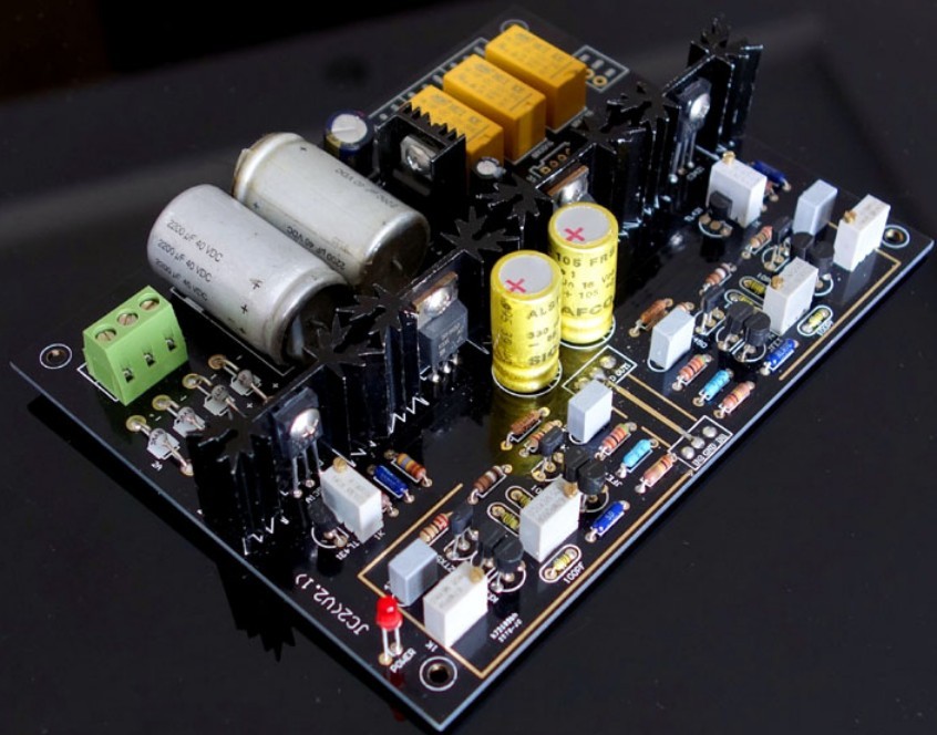

Well guys, I have been shown a REAL FIND in audio preamps and I actually have one to test. It is made in China, called a JC-2, because it has copied the original Levinson JC-2 line stage, sometimes talked about and built here. It has an R-core 30W transformer AND some sort of regulated power supply,(more later on that), 3 double pole quality relays for line switching, and multiple multi-turn pots for offset, and bias adjust. It also has a 2 channel Alps (blue) pot. WOW! There is NO WAY we could make and sell this for under $1000 or so. Guess what? It costs $126+$30 shipping. The case is well made, (not Blowtorch quality) but very nice, with a milled front panel and off-on switch in front with an led indicator. (more later)
It is the right preamp, but a different vendor, apparently. We paid $30 for shipping, I am pretty sure. There IS a 110V version as well. That is what I have. It has what appears to be 2sk170-J74 differential pairs in each channel. All discrete. No obvious problems.
Here's a close-up of the PCB, its selling quite well over here (36 shifted in recent weeks) on Taobao, price about $100. PCB alone, go here ($25) - ·ÂJC-2ǰ¼¶Ì×¼þ ºÚ½ðÖÕ¼«°æ±¾ ´ø3λÊäÈëÑ¡Ôñ-ÌÔ±¦Íø
I thought it would have more compromises. OF COURSE, it is compromised somewhat in several ways, but they would be subtle, and usually fixable, if someone found it important enough.
