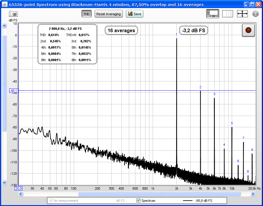

The distortion in speakers gets lower and lower with decreasing level, just like analog tape. At realistic listening levels, the distortion may be fairly low. NO Xover distortion!
OK, but we need some numbers. Well designed power amplifier will have almost no measurable distortion above -100 dB at say 2Vrms output voltage. I have done quite a lot of distortion measurements with speakers. Typical midrange, 5", at 2Vrms, measures like the one attached. Yes, 2nd and 3rd harmonics dominate. But it has higher harmonics as well and they are huge compared to distortion of well designed amplifier.
Though I agree with you that amplifier's sound may be quite easily distinguished through speakers, harmonic distortion of the amplifier is definitely not the case of perceived difference.

The loudspeaker distortion curves are interesting. The issue is how much is the microphones contribution. If I got those curves I would check for dust in the microphones grid or on the diaphragm. (Typical of a used precision microphone!). You might want to measure a hot wire to see what harmonic structure you get.

No reason for underestimations, Ed, I have cleaner measurements of different drivers as well. However, it makes no sense to exaggerate amplifier distortion and to argue with crossover distortion. I am more and more disappointed here. Would you show some speaker distortion measurements with same resolution as I did.

The measurement, small diaphragm microphones have considerable distortion at very high pressure level only.
No reason for underestimations, Ed, I have cleaner measurements of different drivers as well. However, it makes no sense to waive with amplifier distortion and to argue with crossover distortion. I am more and more disappointed here. Would you show some speaker distortion measurements with same resolution as I did.
My common measurements are of noise level, frequency response and intelligibilty. If I get the chance I will measure a small driver and send it to you for comparison.
