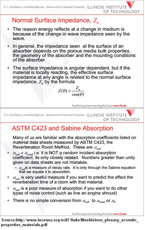

Most of the acoustic modeling programs only use one number for the coefficient of absorption. Most material is rated for a single number. Does anyone here know what that number is supposed to represent?
Interesting questions Ed. Please expand on this.
ASTM C384 Standard Test Method for Impedance and Absorption of Acoustical Materials by Impedance Tube Method
1.1 This test method covers the use of an impedance tube, alternatively called a standing wave apparatus, for the measurement of impedance ratios and the normal incidence sound absorption coefficients of acoustical materials.
Estimates of the random incidence or statistical absorption coefficients for materials can be obtained from normal incidence impedance data. For materials that are locally reacting, that is, without sound propagation inside the material parallel to its surface, statistical absorption coefficients can be estimated from specific normal acoustic impedance values using an expression derived by London. Locally reacting materials include those with high internal losses parallel with the surface such as porous or fibrous materials of high density or materials that are backed by partitioned cavities such as a honeycomb core. Formulas for estimating random incidence sound absorption properties for both locally and bulk-reacting materials, as well as for multilayer systems with and without air spaces have also been developed
ASTM C423 Standard Test Method for Sound Absorption and Sound Absorption Coefficients by the Reverberation Room Method
1.1 This test method covers the measurement of sound absorption in a reverberation room by measuring decay rate. Procedures for measuring the absorption of a room, the absorption of an object, such as an office screen, and the sound absorption coefficients of a specimen of sound absorptive material, such as acoustical ceiling tile, are described.
