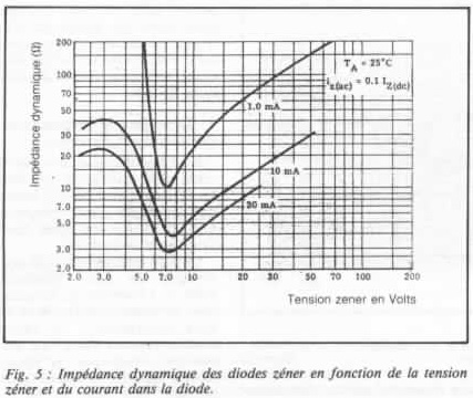

For clarification, a Zener diode, while available in a continuous range of voltages, actually operates on two principles: Zener and Avalanche. At about 5-6V these two effects cancel their relative temp coefficients and are the most stable under temperature changes. On either side of this range we get Zener diodes (primarily) below 6V or so, that can be very quiet, but have a significant tempco and fairly lousy regulation.
Above 6V, we get primarily Avalanche mode, with LOTS of extra noise and even again fairly high dynamic impedance (see Dimitri's graph). It is the NOISE that is almost overwhelming and it usually has to be filtered down to some reasonable amount like DVV's power amp schematic showed. ( By the way, I do all my power amps like that schematic. )

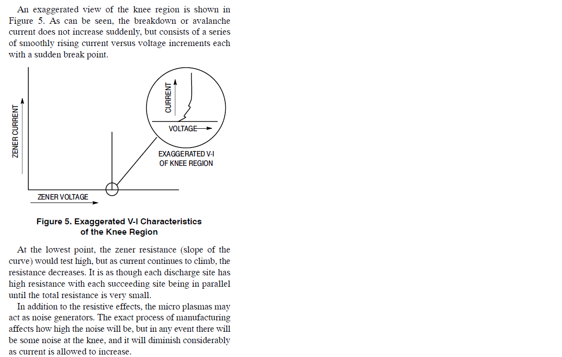

To be fair, you should really test them for noise when they are well into their avalance region, i.e. carrying appreciable current.
Depending on fabrication method a bit, but they are very noisy around the transition; sort of intuitive I think.
Intuition OK: see attached.
Moral: don't starve your zeners....

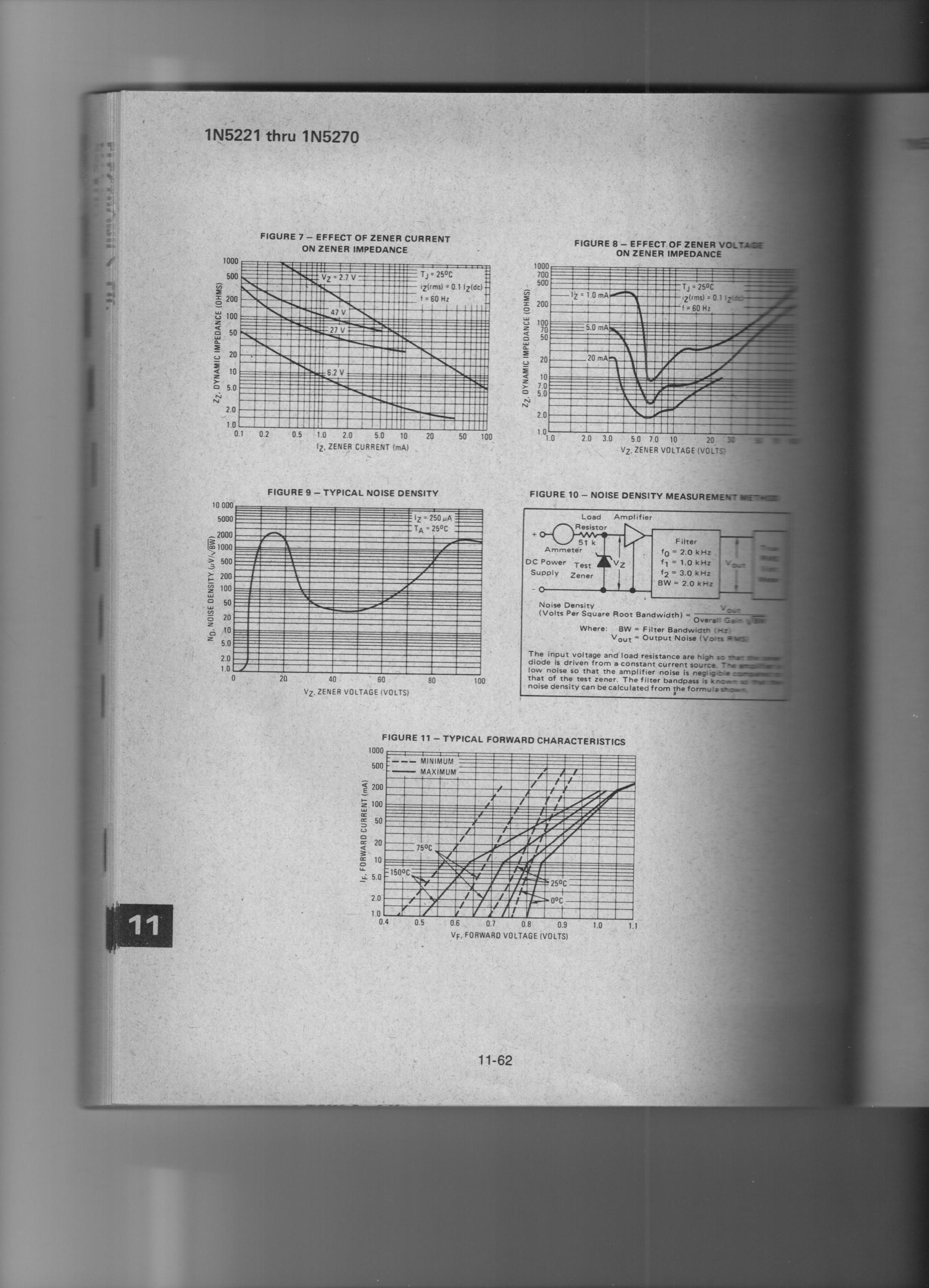

Sometimes people don't react because nothing new is told, or what is told is known to be wrong ...🙂
The minimum at around 6.8V in dynamic impedance is quite well known.
That at that voltage, also the noise is minimum, is not correct I believe. But I could be proven wrong.
Jan

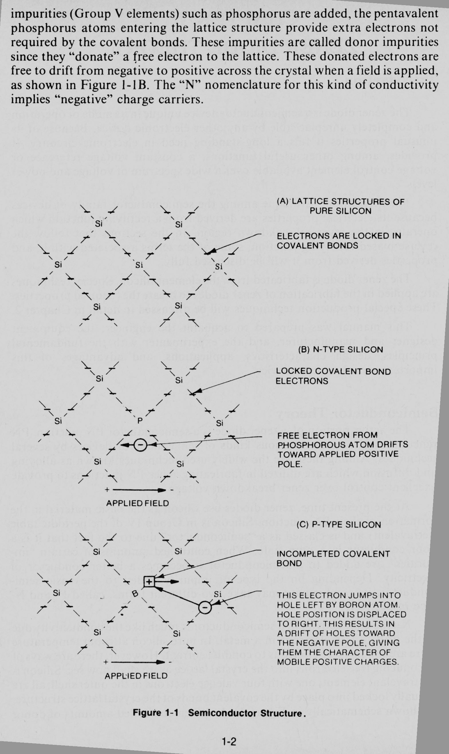

So this took a while. One of those old books (you know) is tittles 'Motorola Zener Diode Manual' and has a nice article about how it functions. Here it is (sorry about the quality this is the maximum file size that I could upload).
