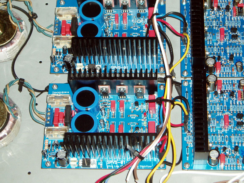

Anyway, here's the small shunt I use, and yes, there is a bigger one, much better but also much more complicated and far more costly.
One are its schematics with a Vout table, second picture is a detail of it in real life and the third is how two of them actually look inside the case, for a true dual mono. Not seen but present nevertheless are two custom toroidal transferomers, rated at 50 VA each. All that for a headphone amplifier, also usable as a preamp, if you're happy with just two sources.

Here's what I use as a stabilizer for power amp input, VAS and predriver stages. Not the most sophisticated you ever saw, to be sure, but in my view one of the best sounding.
It is scaleable, however bear in mind that the more current you want from it, the bigger the local star shaped heat sink will need to be. After 60 minutes of normal operation in a 25 deg C ambient the heat sink should not exceed 10 deg C more.

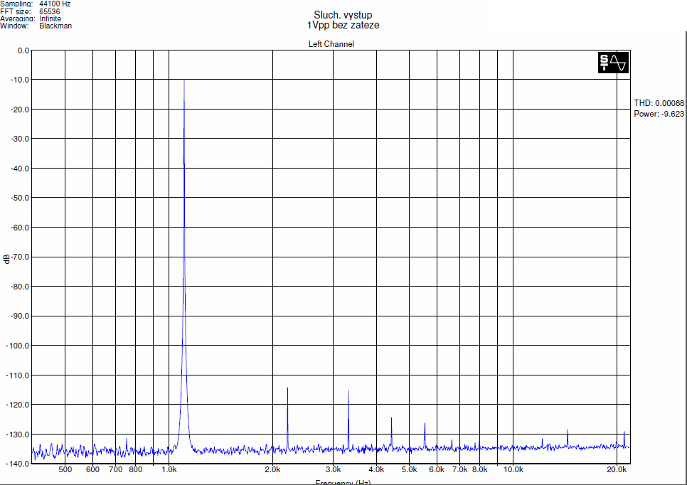

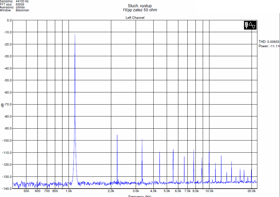

Few weeks ago, we discussed opamp loading and shown some examples of good behavior. Today, it happened to me to measure a conventional headphone output with NJM4565 opamp. 90% of consumer electronics would have it inside. Please see measurement without load and with 50 ohm load, at only 1V peak-peak (0.35Vrms). With 50 ohms, you may see purely crossover distortion - and it sounds exactly this way - sterile, aggressive, gray, harsh sound. I often wonder what the guys who make listening tests directly from PCs with headphones will hear.
