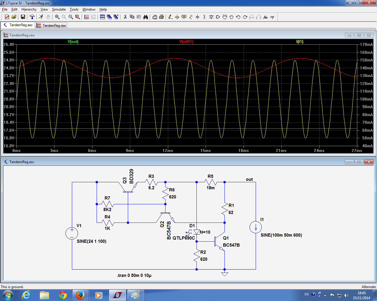

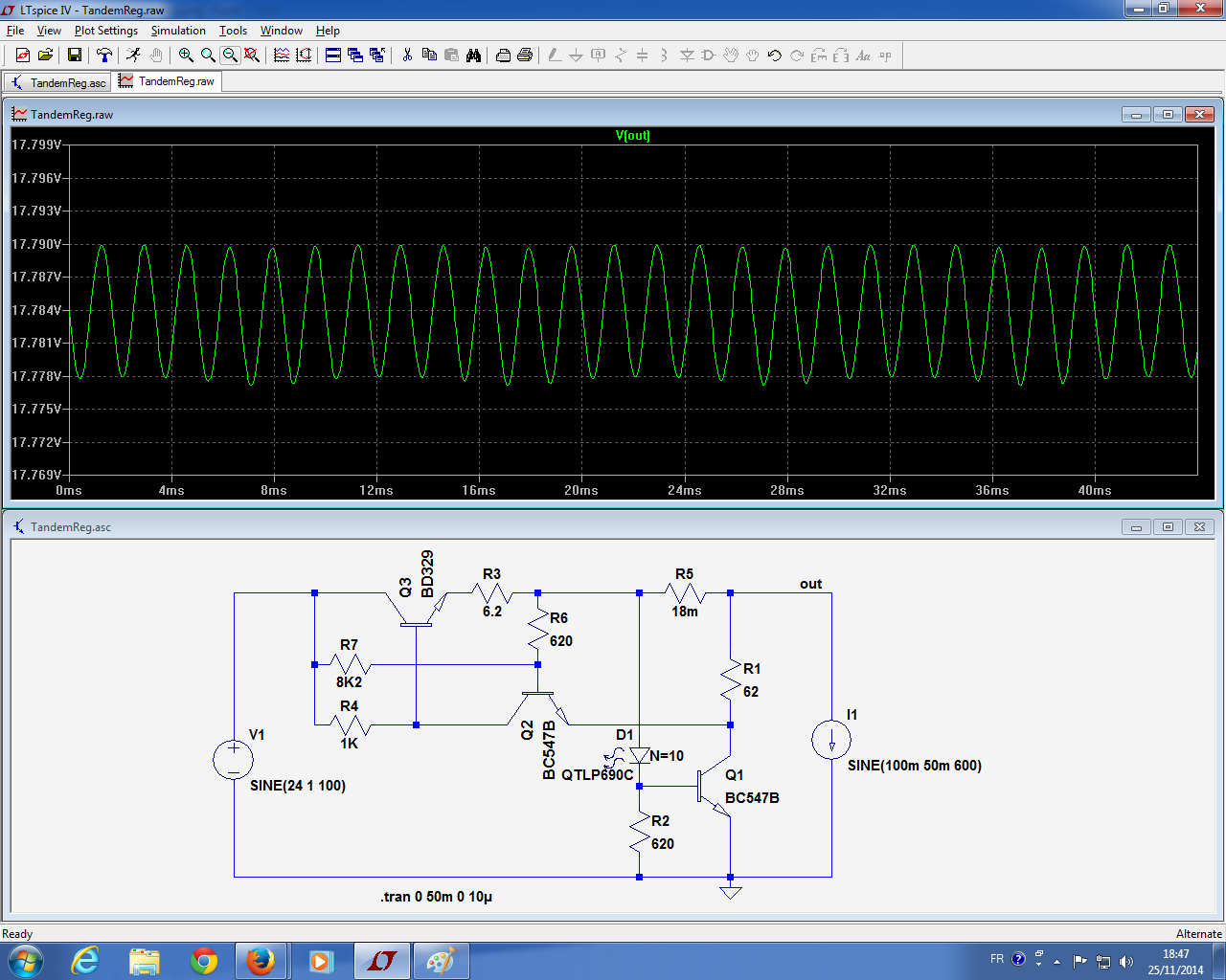

Why not something a bit different and original for a change?
We always see the same old rehashed shunt regs fed by a CCS, but if they work in tandem instead of independently, it brings many benefits: reduced dissipation, better rejection, lower output impedance.
I tested the concept with this circuit: the shunt reg formed by D1 and Q1 works at ~10mA, and the CCS is servoed to keep this current constant.
Here, the sim shows the behavior with combined rippled input and an output current varying between 50mA and 150mA.
Performance looks interesting, even without any optimization or additional bypass caps
It has probably already been invented twice (at least) anyway....

Works fine at 30mA. If you need lower output impedance, you have a pretty poor signal circuit.
Poor output impedance -> poor regulation Ro = dVo/dIo For 10x red 5mm leds in series, that would be about 50-75ohm (according to a typical red led datasheet). That would be a 1-1.5V drop for a 20mA load. Really, anything that requires a better regulation is "poor signal circuit"? Those guys (TI, Linear, Analog) designing and manufacturing ultra low noise LDOs must be stupid, right?

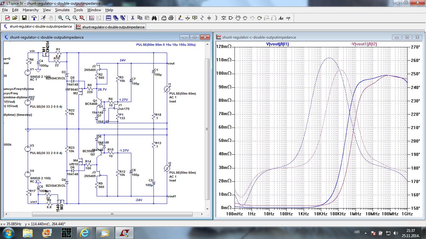

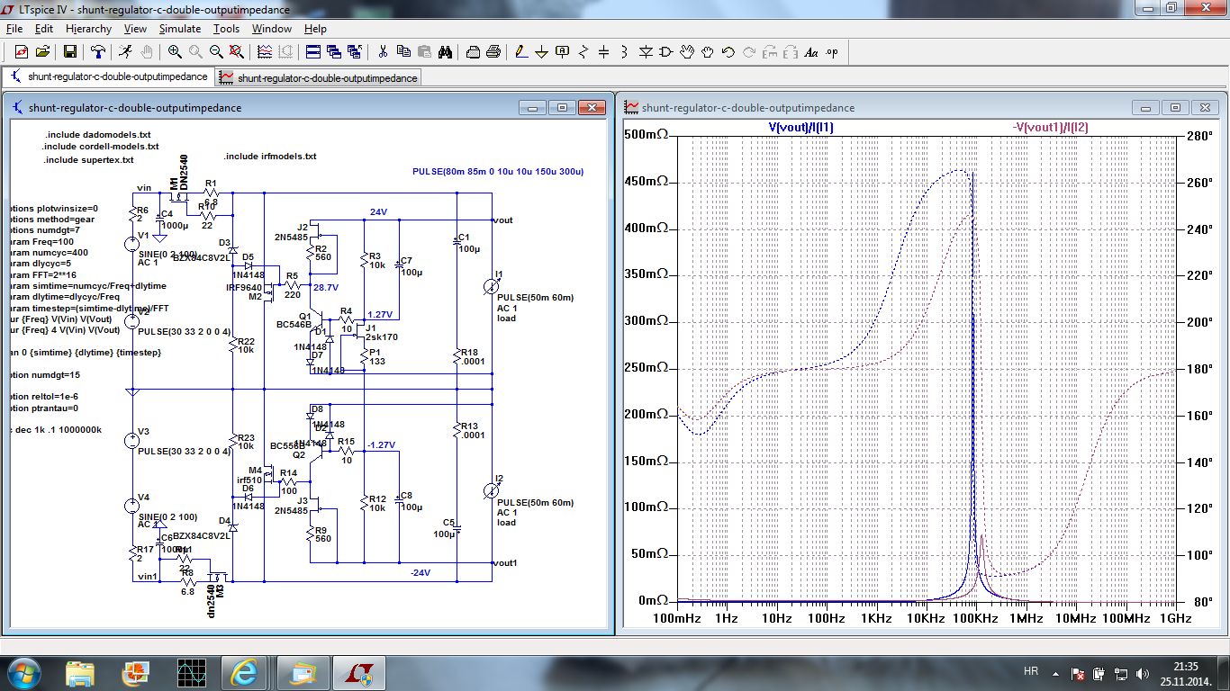

What we definitely do not want are resonances in bypass capacitors. L and C and ESR play the game. L means PCB track inductance as well. So, for someone maybe paradox, higher ESR or even resistance in series with bypass capacitor may help (R > sqrt(L/C)). Depends on real circuit and real PCB design!
This is example of my PS shunt regulator (I would like to see more practical examples, not just small doses from established audio designers, it will help us amateurs) where a low ESR bypass capacitor could show very narrow peak in the output impedance, but adding small series resistor(0.1R) show very nice output impedance. The caps in question, C1 and C5.
