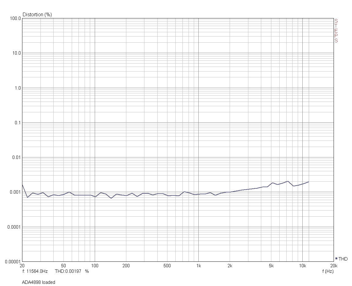

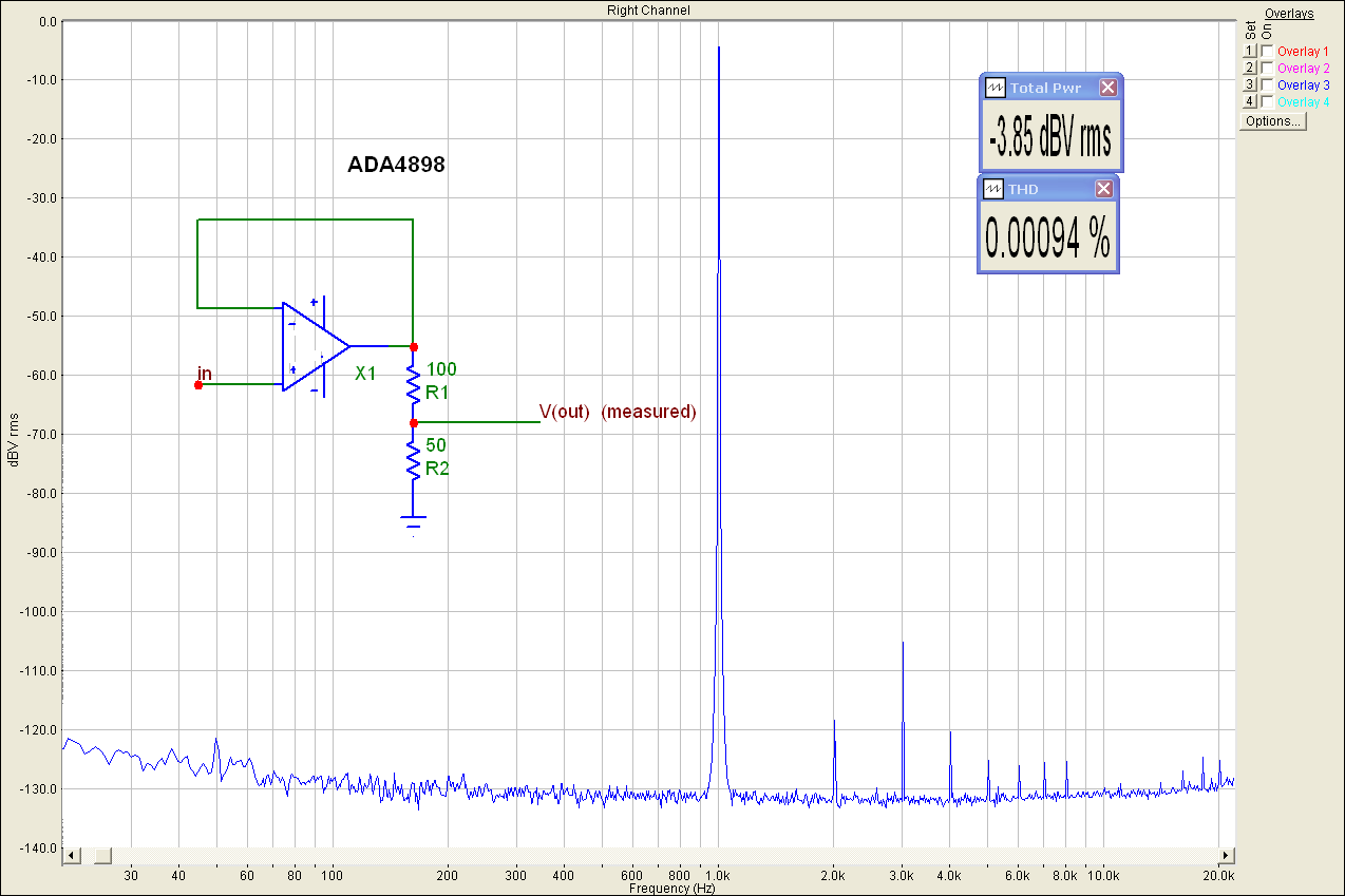

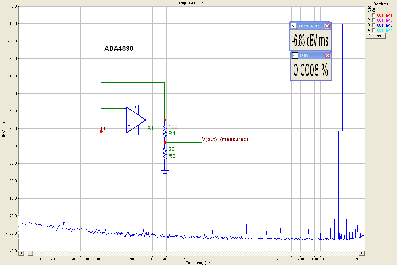

Just a brief measurement of loaded ADA4898 (100 ohm + 50 ohm), schematics is in the plot. Please compare with Mooly's 4562 (and do not forget to read Y axis).

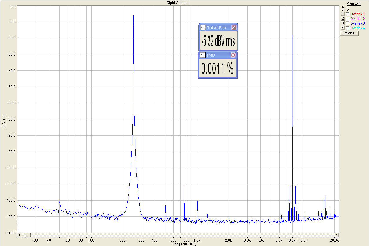

The measurement that I have shown yesterday was to illustrate that we have a choice of some opamps that are able to drive difficult loads. But it was affected by the resolution of the direct method.

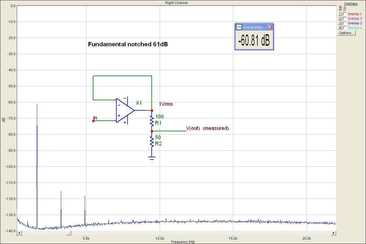

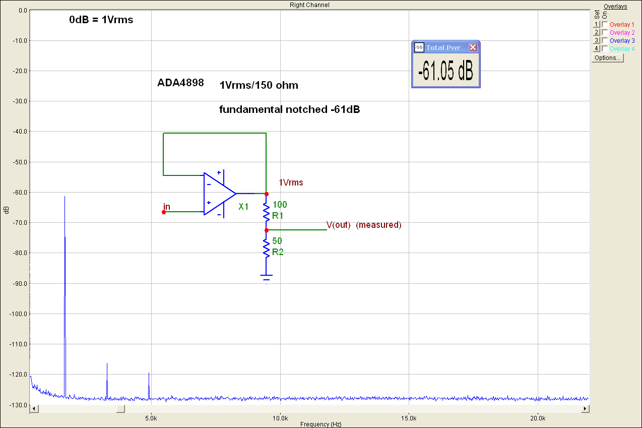

Today, I would like to show a measurement of ADA4898, loaded with 150 ohm, at 1Vrms, with a notch filter and different HW. I am able to measure much lower distortion then. As you can see, behaviour of ADA4898 at 1Vrms/150 ohm is perfect. Unfortunately, I cannot get more amplitude from this method.
Correction to filter frequency response is to be done, so 2H result is in fact 11dB worse and 3H result is 6dB worse. Even so it is perfect.

Edit: I am adding one at beter Y resolution, same conditions.

Any comments? You guys just have to make a choice of the part that fits to your application, not to overload the improper (unsuitable) part above its limits. As far as I remember I have recommended the ADA4898 at least 5 - 10 time here - without anyone interested.
