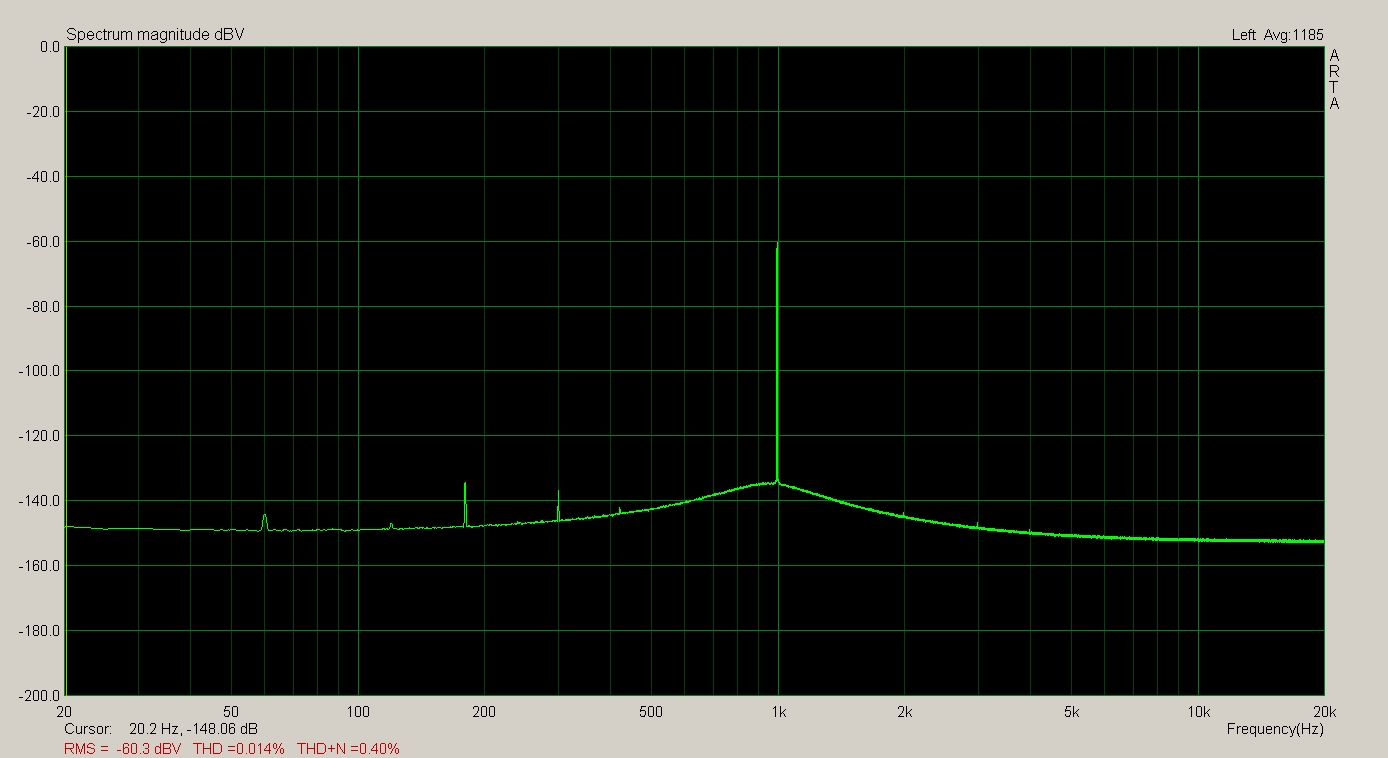

The opamps shown lately for buffers are not close to being good enough in distortion. I guess you need to design a discrete circuit that exceeds this result ? ; Check out the 2H and 3H level of 1KHz fundamental which needs to be buffered:
THx-RNMarsh
1) what was the amplitude of the fundamental
2) what would be the load resistance
Please always provide complete information.
I already gave that information plus referred to David's complete spec info on another forum. Here it is on line #57469.
This particular test shown, I found from david, was at 100 Ohms and 2.7v rms. Looking for double that level, if possible.
Showing pretty good IC amp performance at -110-120dB at moderate loads doesnt get here. I could do discrete that good, myself. You guys are my experts. My hero's. What can you do for him?

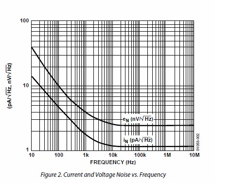

The AD8022 looks like an interesting part, even for audio. It uses the standard (AD797 like) topology, but has a 20KHz open loop bandwidth. It is fast as well. I don't know how much crossover distortion it has, and the maximum power supply voltage can be a limitation, but I would consider it potentially a pretty good part.
With its high BW and very low distortion even towards 1MHz, I'd think xover distortion wouldn't be an issue.
But the graph PMA showed shows a high noise crossover frequency.
The '797 crosses over at around 100Hz, the AD8022 at a few kHz.
