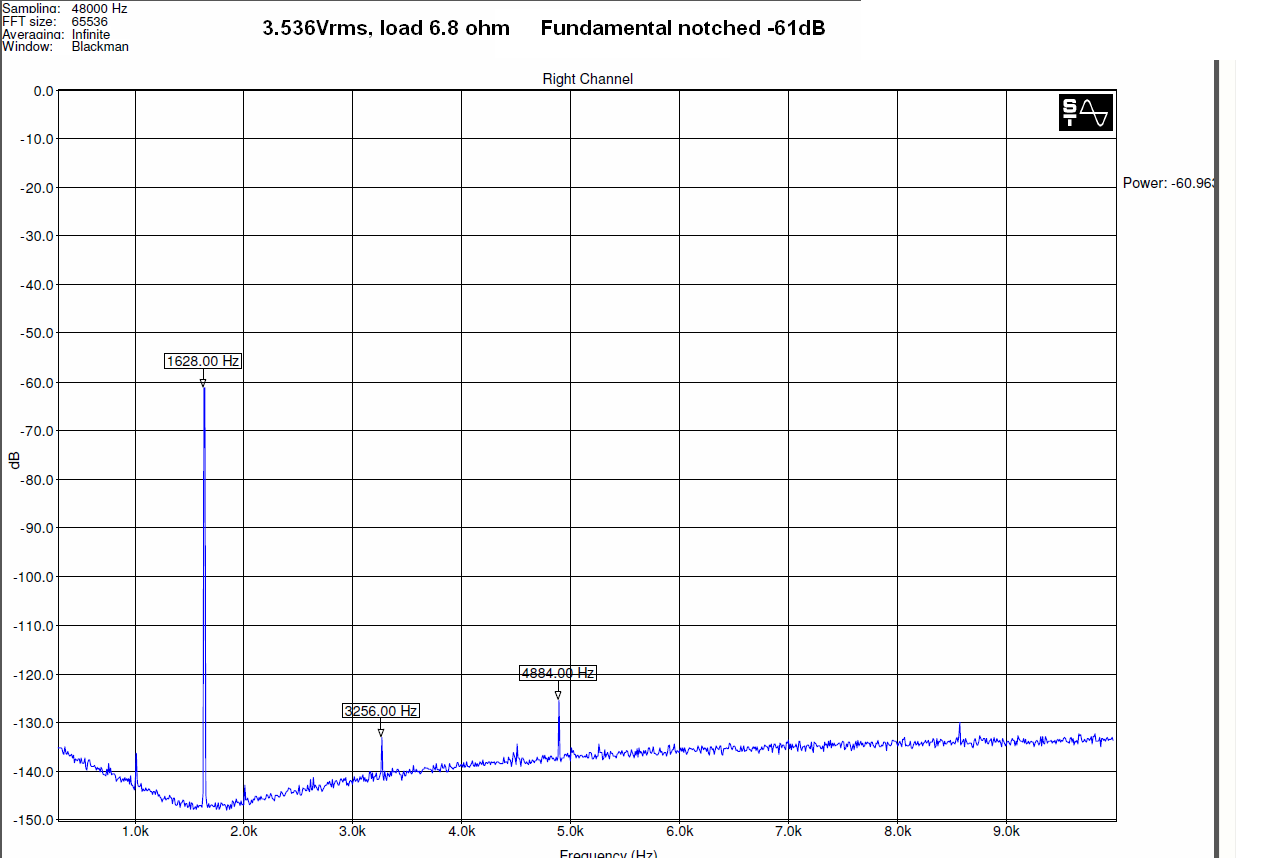

Regarding 2.7Vrms/100 ohm, the "best" measurement I have at similar level of any amplifier I have is at 3.536Vrms and 6.8 ohm load. Unfortunately, the measurement is affected by distortion of the method itself, which is almost same as the result measured. The result is for OPA627 with "some buffer"

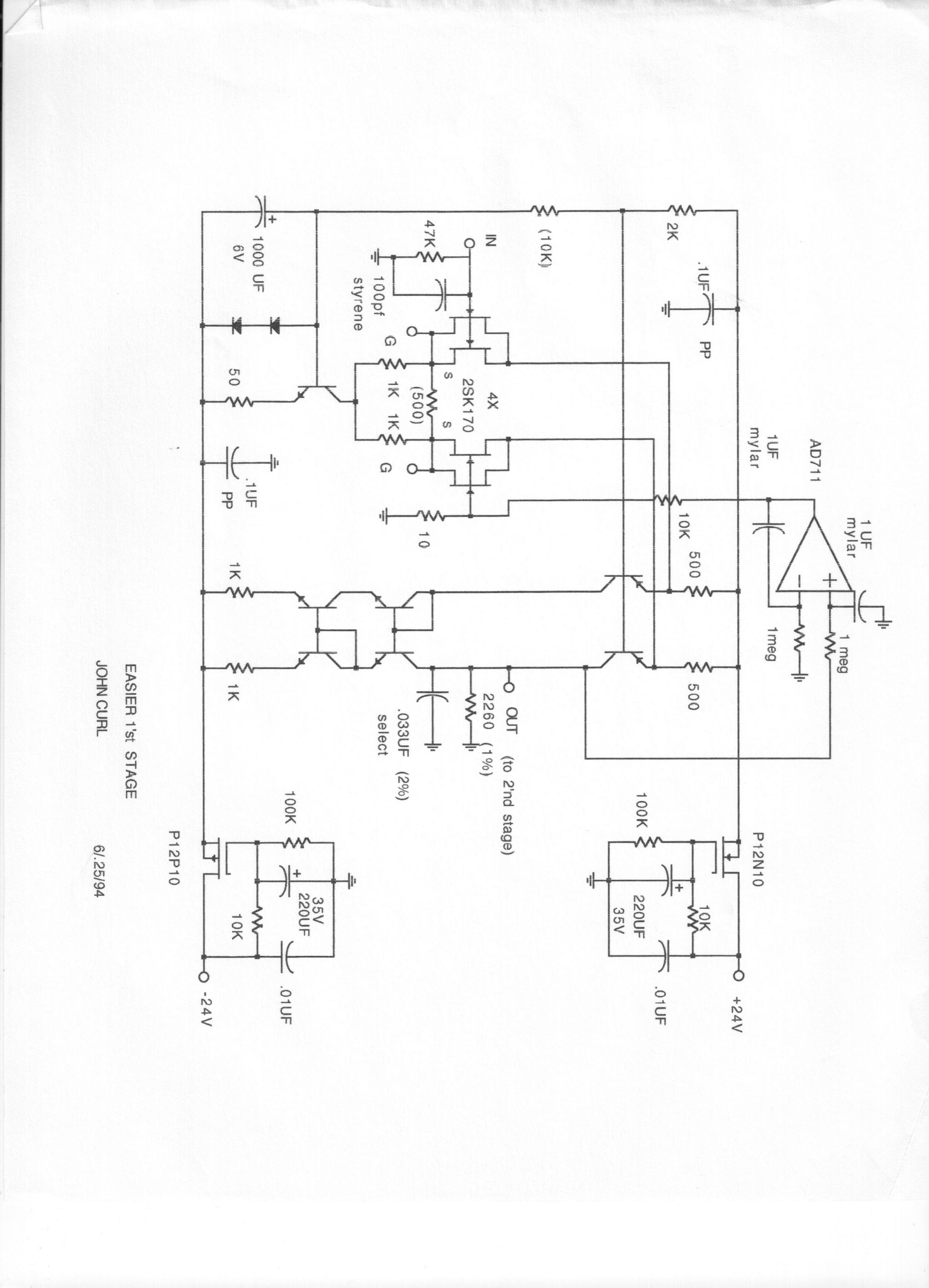

Here is my discrete version of this topology from about 20 years ago.
I thought we were talking about a line stage? This is a phono stage with the 75uS correction - better be low noise!

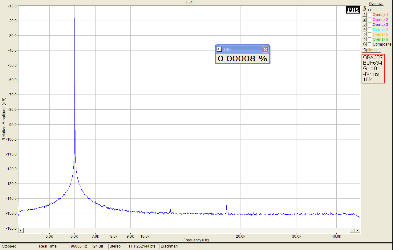

the best measured result obtained at a colleague of mine, who has better measuring equipment, is this one. Conditions are written in the red rectangle at the right side of the image.
BTW, David has already contacted me.
10K load is a problem what about driving low z loads?
