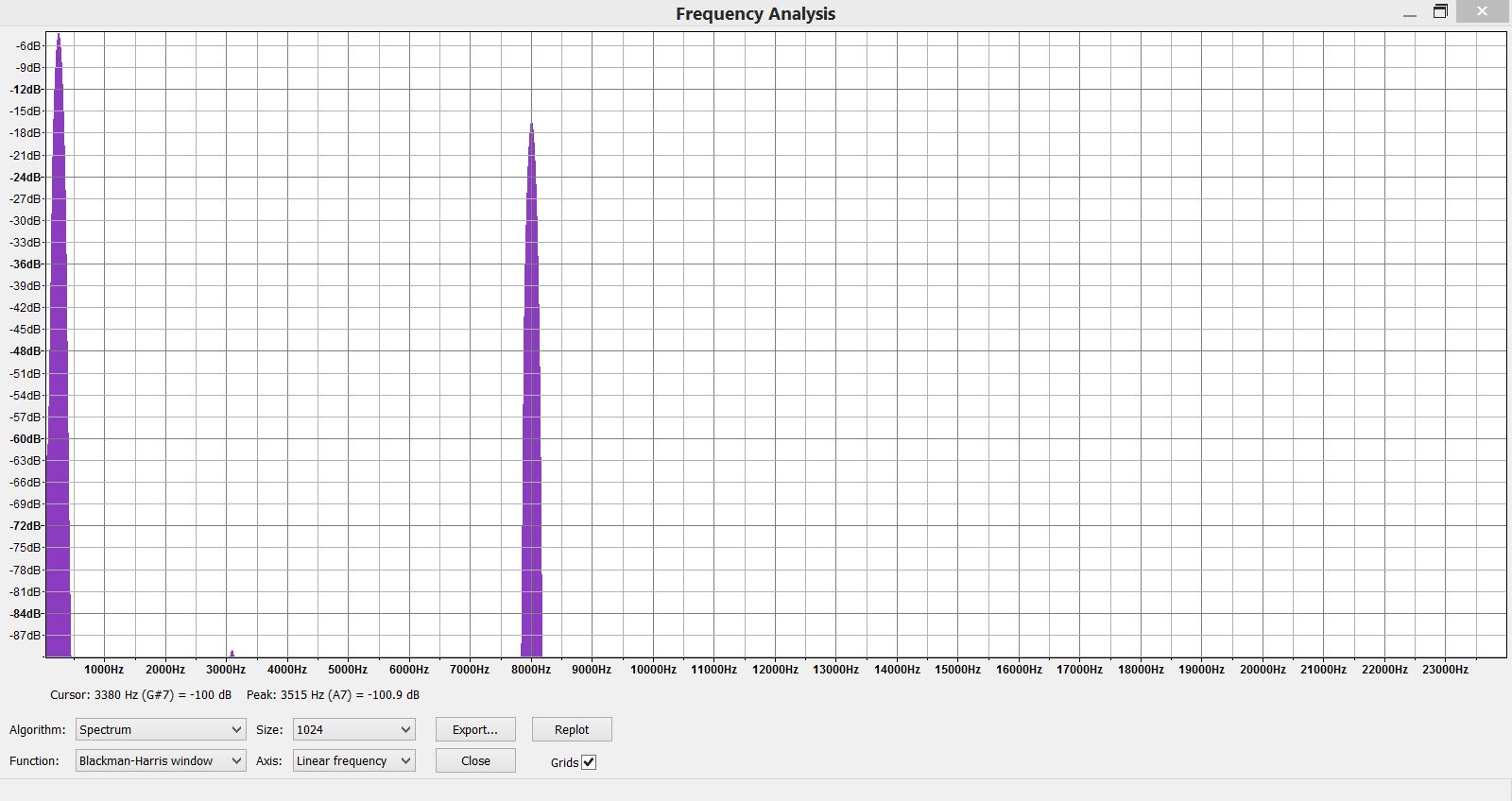

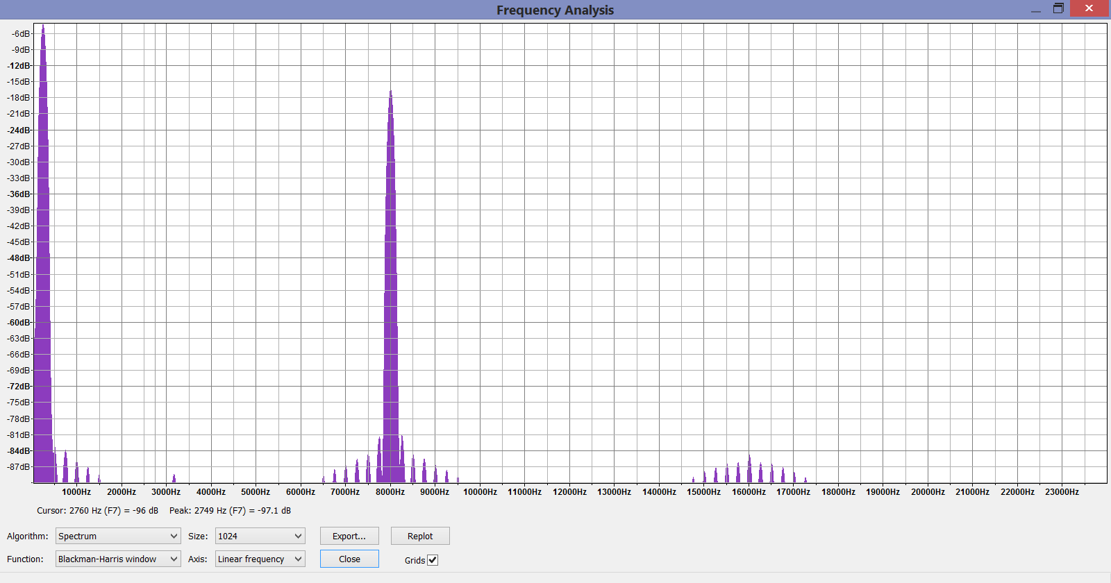

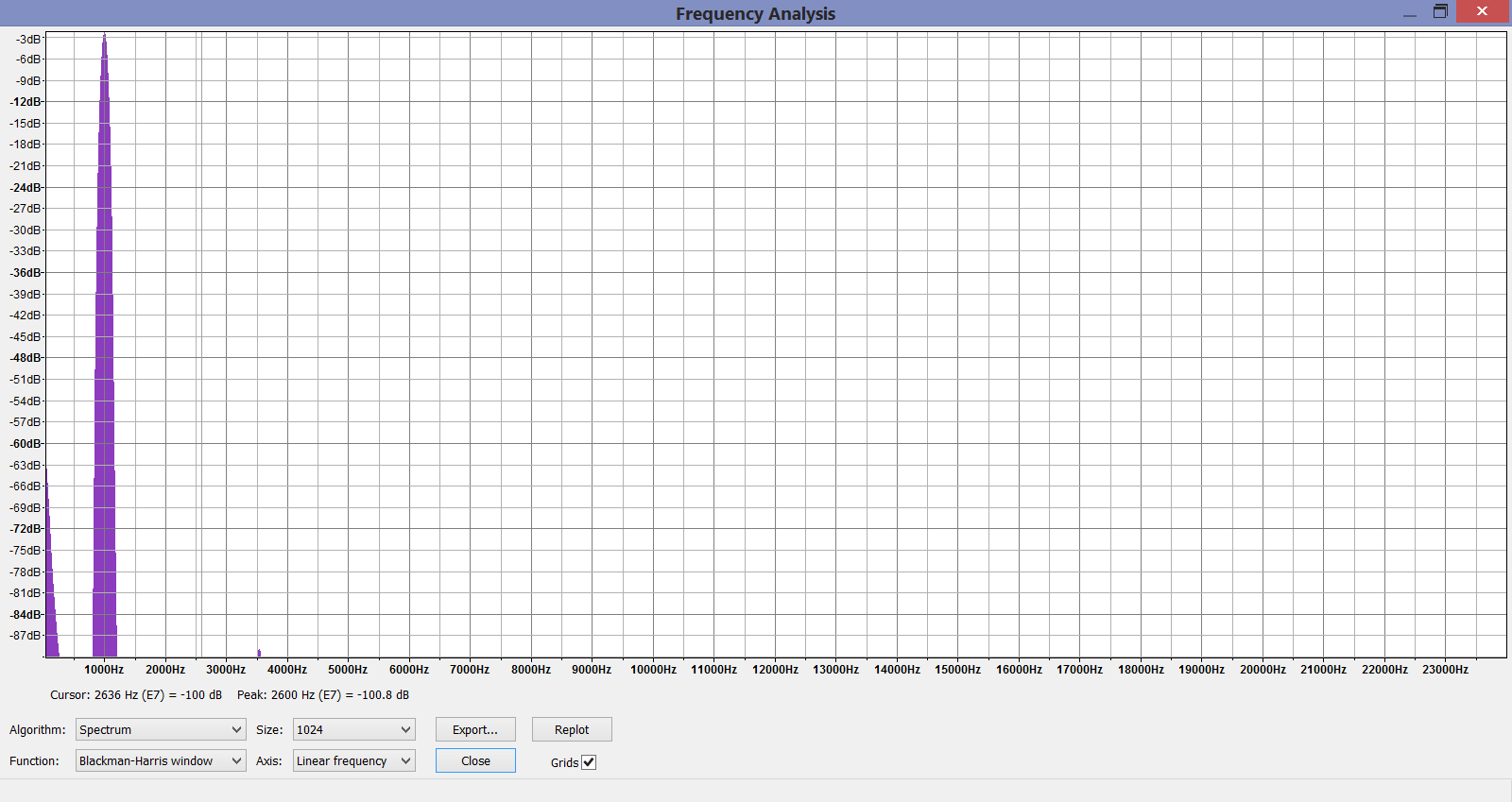

The new test has two music pieces. File size might be an issue for some though. One piece was kindly provided by SY (thanks 🙂) and its proved a tough one to get the best from it. Originally a 24/96 master, there is one very brief section that's a killer with dynamics. I suspect my ADC is the limiting factor here. Non the less its a cracker. Lots of detail, very quiet for the most part. The other files are shorter and a different piece.
This is just a quick sampler of the differences between loaded and unloaded and one opamp type against the other. The differences are real and obvious... but are they when listened too.

This listening test is similar to the earlier one but has the added bonus of two high quality devices under test. These are also single opamps and not duals.
OK, here we go 🙂
Firstly, I don't want to discourage anyone from taking part and so this test can be as simple, or for those that like analysing files, as complex as you wish, but I also want it to be as interesting and fun as possible. All things considered, its easy to get a perfect Foobar score simply by adding a spoiler/s to the tracks and picking those out. I hope if you listen, you do so as "just a piece of music" and base your comments accordingly. If we are to learn from this then its important just to be honest and report what you hear.
The circuit details are similar to the earlier one with the exception of an added input filter (a 470pf cap to ground after the 2k2 input resistor) and a 22pf cap across the feedback resistor. This was needed for one device and so it was only fair to keep the circuits identical for both. These small value caps were high quality polystyrenes. Each opamp was decoupled at the supply pins with a 100uf quality commercial grade cap. The PSU was a fully charged 12 volt 7Ah V.R.L.A. battery.
The source for all these files was a Marantz Pearl-Lite SACD player. This player is "opamp less" and uses discrete FET/Bjt stages.
So the files... and they are really easy to use, are complete in themselves and are "zipped".
LT1
LT2
The downloads. Folder LT1 and LT2 both contains spectra images but beware of the total download sizes. LT1 is 143mb and LT2 is 32mb. For those on a limited allowance or slow connection I would advise just using folder 2. The picture names (A1, A2 etc) relate to one device and B1, B2 etc to the other. Each folder has an identical set of images. Its obvious that one device produces way more distortion than the other and its not giving anything away to say that the higher levels are when loaded.
The audio files within each folder are random in order and there is one each for each opamp, both loaded and unloaded. So four audio files in each folder.
The big question... can you identify or have a preference for one any one file in each set ?
