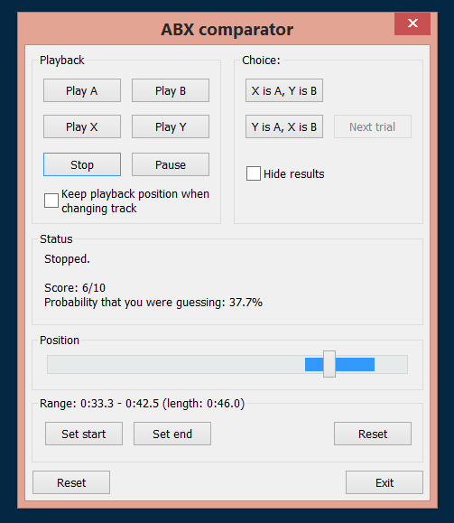

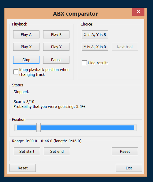

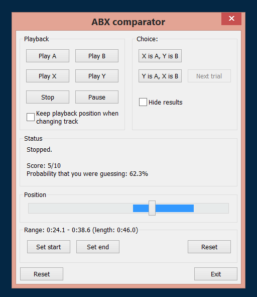

I've just given the files a Foobar listen via Sony MDRV-7 phones. Results for me at this point speak for themselves :D

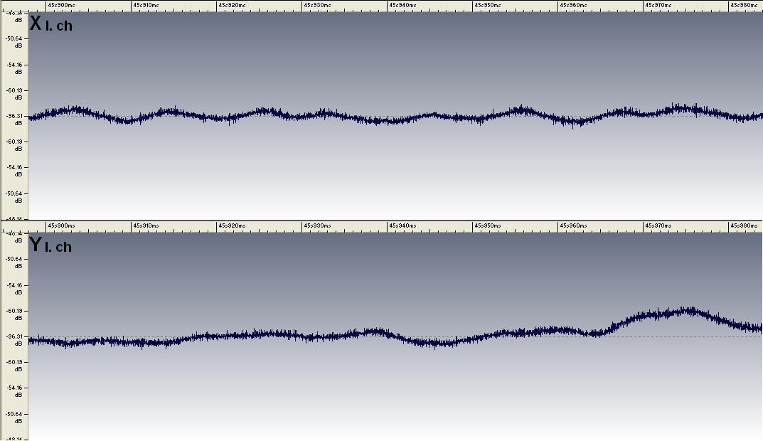

Joined 2002
Attached below is the spectrum of the difference between the 2 files. Look at the levels.
Note the scale on the left, the difference waveform is being shown at x100 zoom, meaning only 40dB down ...
When I see some amount of such low subsonic freq in a spectrum from a file that is the difference btn two digital recordings, my mind goes first to misaligned files.
After Pano’s and Frank’s posts, I looked deeper into the X and Y files as uploaded by Mooly.
They are not that aligned for to do this nitpicking. They need some trimming for better time alignment.
On Y file, music is time shifted 8.729ms compared to X file.
Thus the first 8.729ms have to be trimmed off from file Y. This way the two files will be time aligned .
Then file X has to be trimmed off by 8.729ms at the end, for the two files to be of equall length (45s991.271ms)
Alas, time alignment to 21us (due to original sampling rate of 48k)is not good enough. See attachment 1
Mooly’s files may be OK for listening tests but not for applying on them such elaborate differential techniques.

Next think to consider after proper alignment of files is power supply LF noise. This can not be synchronized btn the two recordings by any means and so phase & amplitude differences of psu noise will show up in the difference file. I have attached such a noise fingerprint seen at the end of the two synchronized files.

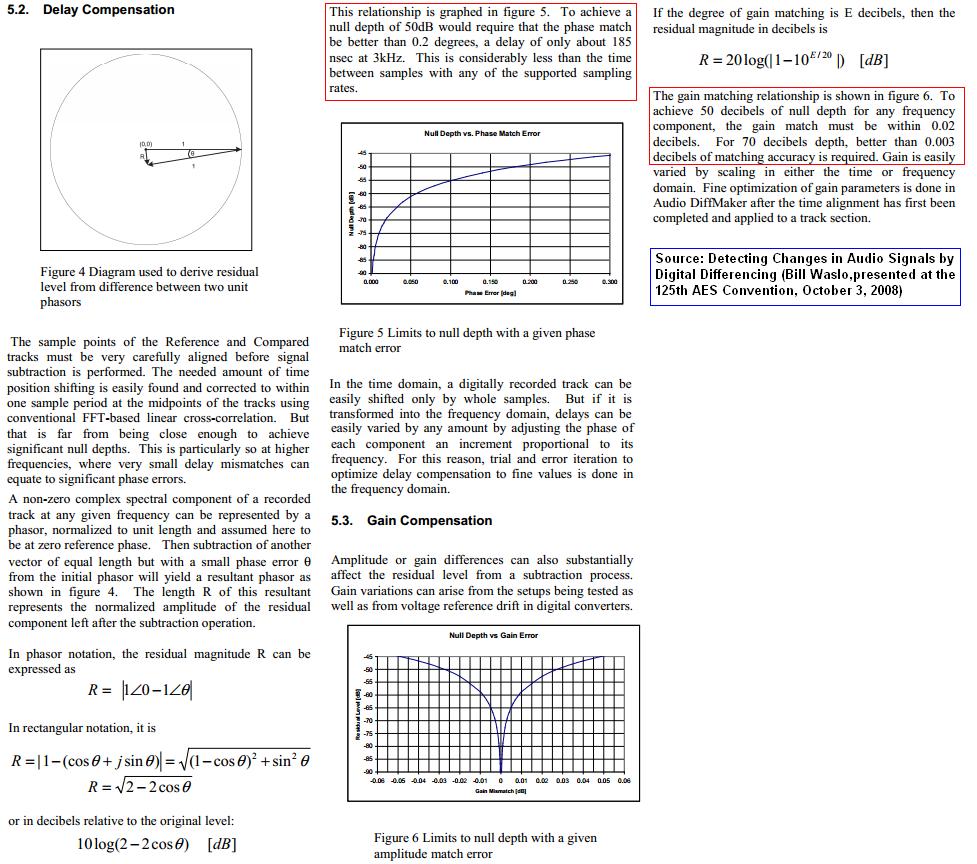

George, the the waveforms as I presented them were aligned to a single sample accuracy. And, within that they are aligned to at least a 20x greater accuracy - I filtered out all below 10kHz, selected the area with the highest average amplitude, and zoomed in - without getting anal about it, the time alignment is easily within 1us. The "new" frequencies within the difference file are what's significant, as abraxalito points out.

The differences could be there for all sorts of reasons - but the point is, that they are there. The waveforms are different, beginning and end of story - and, those differences may, or may not be audible.
