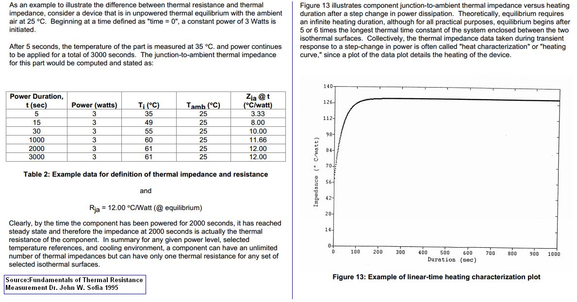

dW/dT is not constant for each ΔT above ambient.
I agree.
The primitive calcs were for steady state conditions (thermal equilibrium) with a small temp rise. To the best of my knowledge, under these conditions, thermal resistance (Rth) is a constant.
Thermal impulse calc, where thermal impedance (Zth) concept should be applied, is for knowledgeable guys.
