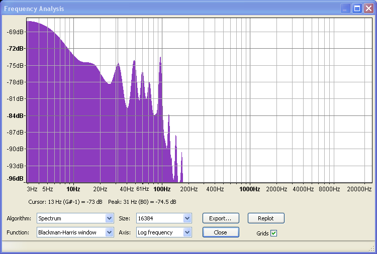

Having looked very closely at the two files I can tell you they are almost identical. The differences are:I'm looking forward to that because I have no idea what Pano is going to show on this.
- Gain. A difference of about 0.02dB between the two files, maybe less
- Noise. What remains in the difference is mostly noise. Some hiss and some power mains noise. Pretty much what you would expect. Noise would not be correlated, so would remain as a difference.
Differences are 65 to 70dB down
- Frequency response
- Phase
- Harmonic structure
I think there were some lucky guesses. The files are just too similar for it to be anything but luck. Of course you won't believe me, but I would bet money on it.
Attached below is the spectrum of the difference between the 2 files. Look at the levels.
Oh, the power of the human ear to hear differences where conventional test equipment fails! '-)
Interesting info, Pano. Thanks for that. I think I'll retest, moving from choosing R6 to blind ID'ing X and Y.

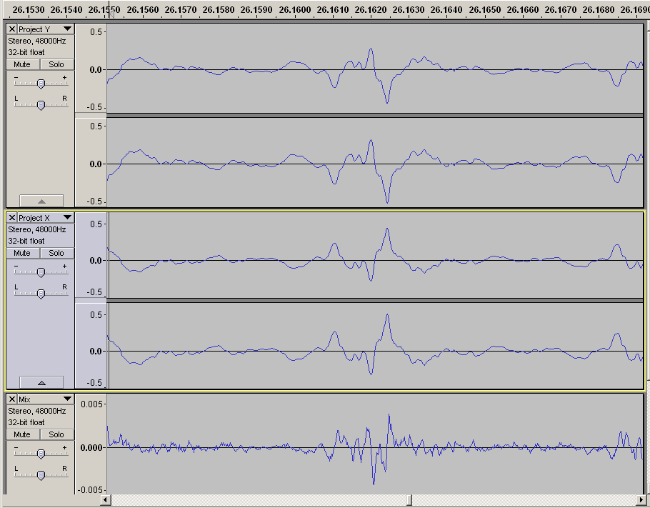

Okay, I'm purely using Audacity, and there the files are most certainly not nulling to that degree, when perfectly aligned. For a start, at the very least, there are amplitude variations through the length of the track - an excellent nulling at one crescendo point means a strong crecendo in the difference file elsewhere in the track. If the software you're using is fudging, smoothing out the differences - where's the "truth"?
Okay, if people want to get a feel of what's really going on, in Audacity here's a time domain view of things:
Project Y is the unloaded
Project X is the loaded, aligned to Project Y, and inverted
Mix is as the term implies, effectively subtracting X from Y. If X were a perfect replica of Y, but only differing in amplitude then the waveform would look the "same". Note the scale on the left, the difference waveform is being shown at x100 zoom, meaning only 40dB down ...
