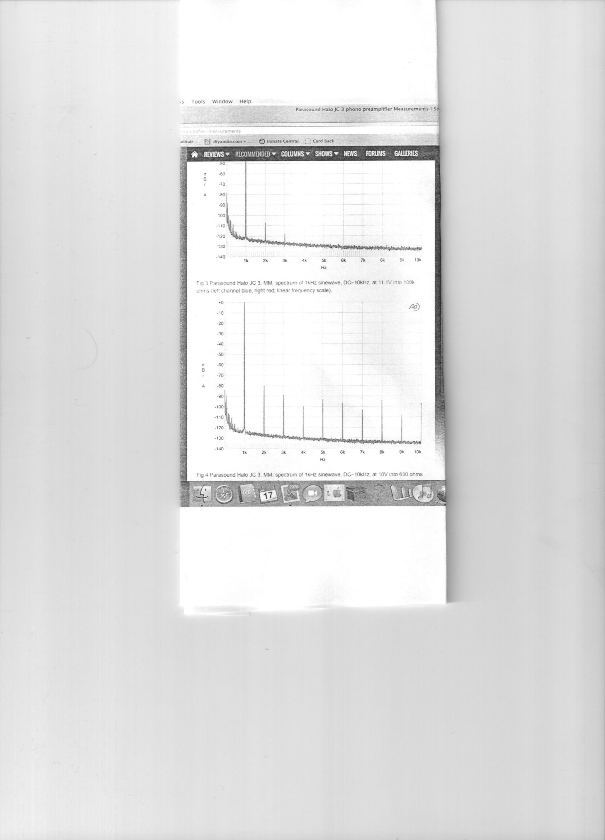

I said I thought the differences I heard every time I compared was Y - which is a no load condition. This isnt a guess for me. Nor luck. If you have tested/measured IC opamps before and listened to distortion before of loaded stages -- that is what it sounds like. The OPS in IC opamps is their sore spot. JC knows it. We all know it. When current thru OPS goes up, so does distortion. So whats all this dancing around for?

One hundred ohm loading is extreme. I have, however seen 300 ohm loading, and even that is too much, I think. Many other IC's that are more popular here are not designed for 600 ohm loading to the extent that when you load them with 600 ohms, they get very unhappy. 100 ohms would be overwhelming for typical IC's. The 4562 is a notable exception, actually. For example if you want to see what the 2134 does, just look at the Stereophile review of the JC-3.

JC-3, Stereophile review, 600 vs 10K load
