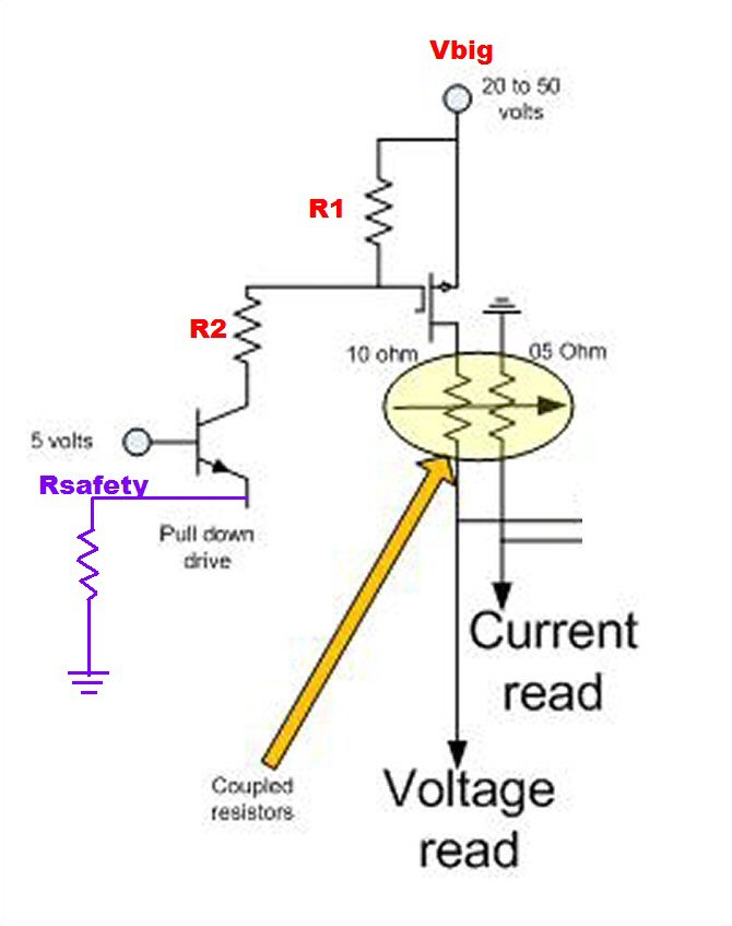

Question. I'm designing a microwire edm system, so need pulses for the spark gap which are 20 to 30 nanoseconds wide, to the tune of 20 to 50 volts. Attached is the rough scheme I'm thinking about. I believe I'll be potting the powerfet, some cap energy storage and the two resistors into an assembly that I put in the liquid just below the wire pulley under the work. The power resistor and the CVR will be my low inductance style, with 20 by 1 ohm resistors in parallel, interleaved through 20 by 200 ohm paralleled array, for net inductance in the dirt. I'm connecting to the work and wire with a very small loop to lower inductance, and I'm keeping all the current path under the liquid surface to take advantage of liquid damping to reduce wire resonances (any mode)
My question is, any suggestions on how to draw a pair of resistors on the schematic to reflect "magnetically interleaved for low inductance" geometry?? Has anybody seen that before?
Also, you circuit guys..I'm using a common base to turn the p fet on, with maybe a 100 ohm resistor to turn it off, and pulling the emitter with a resistor/fet combo such that the transistor never saturates. Any obvious problems or comments would be much appreciated. (edit: other than the wrong polarity fet of course)😱.. I'm interested in seeing risetimes at the 1 to 2 nanosecond level..

If you switch to a MOSFET you can use a trivially simple gate bias circuit {hard-connect to +5 supply}, and you can drive the source directly from logic gates {even open collector gates!} with no current limiter/voltage limiter mechanism.

If I pull [down] the source [of an Nchannel cascode] using an open collector, is it possible for [either] device to pull the source [of the Nchannel cascode] well above the 5 volt rail and pop the gate insulation?
Short answer: no.
Long answer below.
Case1: The open collector puller-downer logic gate cannot pull up the cascode source to +Vbig. It's just a 5V logic gate. It has no way to drive any of its pins beyond 5V. {if it were me I would probably choose the 74F06 for highest speed and greatest output current}
Case2: The Nchannel cascode device cuts off when its gate-to-source voltage falls below its threshold voltage. It cannot pull up its source voltage Vs above (Vg - Vthreshold). If the source Vs rises even a millivolt higher, the MOSFET cuts off and pullup current ceases to flow. In your case, Vg=5V and Vthreshold=1.5V (varies a lot, see datasheet). So when the source rises above 3.5V, the MOSFET cuts off and prevents further rising. The pull-up mechanism cuts off when Vsource exceeds 3.5V.
If you are blessed with irrational paranoia, you can always connect a "safety resistor" in parallel with the logic gate: between the open collector output and ground. Size it for ~10X datasheet leakage current; 330K would be a decent starting value (10 uA). This ensures that the MOSFET cascode device's source sits right at Vgate-Vthreshold (3.5V) and doesn't mysteriously creep upward. Those taking Phenothiazine medications may wish to reduce Rsafety yet further, but be certain not to violate the keep-em-off inequality
- Vbig * (R1 / (R1+Rsafety)) < 0.15 volts

Thank you. I was actually thinking of drain to source capacitance and drain to source leakage.

I just realized I don't really know what problem the coupled resistors are intended to solve, even though I thought it was pretty clever from the beginning. I think you're on to something with that gut-reaction stuff Jn!
Would you explain the resistors for me?

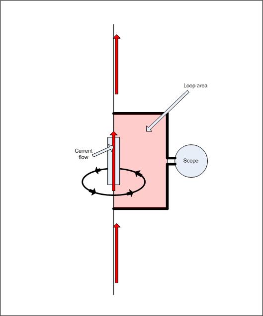

When you try to look at time varying current through a resistor, you use a pair of wires. Those wires form a loop next to the physical body of the device, and that loop will intercept the magnetic field that goes around it.
At DC, this is a 4 wire, or kelvin connection, and give good accuracy. But when the current changes, the loop area can generate a voltage based on faraday's law of induction, V =-db/dt (b-dot) times the area. (the actual field falls as 1/r, but that's not important to this discussion).
No matter what you do to a resistor internally, there will always be a physical distance between terminals, and that's where the voltage pickups have to go. I have drawn a diagram to illustrate this. The loop area is the pink hilited area, it is formed by the resistor and the wires to the scope.
My interleaves resistor design brings the current back through the body in the same path as the original current, so the magnetic field will be of the opposite sign, which causes a cancellation of the magnetic field that will be trapped in a loop.
For this EDM thing, I realized that I do not have to electrically connect the two resistors at one terminal as per my original design, but can make both to interleave nonetheless.
The result will be, both the .05 ohm and the 20 ohm resistor will have it's magnetic field cancelled by the current of the other. edit: this reduces the error I will see in the very low value current viewing resistor, and as an added bonus, it reduces the inductance of the overall loop between the fet switch, the capacitor, and the edm device, which will allow the current to rise that much faster.
The only caveat I see is any current which flows from the mechanical equipment to ground will not cancel through the resistor. This means I have to keep the capacitance to ground to a minimum.
edit: This problem is most apparent when the resistor being used is very low resistance. Then the IR drop is very small, and the b-dot error can be large with respect to the actual IR. If the resistor has a high value, then the b-dot error may be insignificant. At first blush, one only needs to know the value of the resistor's inductance to calculate the basic b dot error, v = L di/dt, then review it's level with respect to the actual IR drop.
