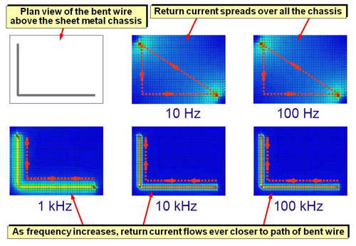

Do you know where your currents are going?
Learning a few 'actual' things from measuring the assumptions shows this:
Why? How could this happen?
What does this mean in terms of inductance and fields? Using this 'real' knowledge would produce better SOTA audio designs, IMO.

The source, IIRC, is Texas Instruments. Maxim shows same results. But, as spacing between wire and ground plane and width of wire or trace etc all changes the freq but not the characteristic effect. Reason given is: as freq increases, the mutual inductance between the wire or trace and the ground plane beneath it make the ground path of least impedance directly under the trace.
See Dr Archambeault who ran the electromagnetic simulations for signals of different frequencies to see what paths the current would flow.

Learned that the hard way roughly 25 years ago. I thought a wire over a ground plane should be quite immune wrt to stray fields from a power transformer located a couple of inches under the ground plane.
I was surprised at first to see a lot of 50 Hz and multiples coupled into the loop even with a free running transformer.
Sometimes it is better to do a calculation first (ok, ok, today, running a multiphysics simulation first).... :eek:
I seem to recall jn reminding us of that in another thread where the context was mains leads: the signal return current may use the mains wiring grounds at low frequencies (where resistance dominates) but the interconnect screens/shields at higher frequencies (where inductive coupling dominates).

as I mentioned in my fastHenry post - the thickness of the Cu plane is critical in how far down in frequency that proximity effect dominates over the simple least resistance path - the proximity "image" AC current confinement local to the trace is not strong at low-mid audio frequencies with 2 oz or less Cu plane

I doubt if you will find 1-2 oz copper used in any audio/video gear from Asia companies made for low-mid level consumer use. Its much thinner. BUT --- Anyway --
It is NOT the copper thickness that influences the freq via mutual coupling --- it is primarily the thickness of the dielectric between the two conductors. Then trace width etc. Copper thickness has little to do with this.

sorry but you are wrong there - the resistivity of the plane is critical in determining the balance between the least resistance/DC current path and the inductance reducing proximity effect "trace following"/ "image current" confinement of the current at very high frequencies
if the plane resistivity is high it "costs" more to bend the current path to reduce the inductance - a superconducting plane would have even "DC" current follow the trace since there is no added resistance loss
a thicker Cu PCB plane has lower resistivity and the current follows the trace down to a lower frequency than the same geometry with thinner plane Cu
once the conductor is considerably closer to the plane than the length of the trace the exact PCB dielectric thickness/layer spacing has little influence on the low frequency loop inductance of a bent trace over a gnd plane current return path - it is then well approximated as the 2D loop area in the PCB plane

I agree with most of this ... it is consistant with others writings. But still not convinced the affect of thickness is very great. Its there but its influence is something fully covered else where. I was quoting excerpted text of others who are 'experts' in the field. But, to just note the affect on current signal paths changes with freq which have impact in many ways which should be discussed and bad layouts practices noted and how to do it best way.
