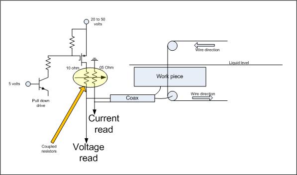

Question. I'm designing a microwire edm system, so need pulses for the spark gap which are 20 to 30 nanoseconds wide, to the tune of 20 to 50 volts. Attached is the rough scheme I'm thinking about. I believe I'll be potting the powerfet, some cap energy storage and the two resistors into an assembly that I put in the liquid just below the wire pulley under the work. The power resistor and the CVR will be my low inductance style, with 20 by 1 ohm resistors in parallel, interleaved through 20 by 200 ohm paralleled array, for net inductance in the dirt. I'm connecting to the work and wire with a very small loop to lower inductance, and I'm keeping all the current path under the liquid surface to take advantage of liquid damping to reduce wire resonances (any mode)
My question is, any suggestions on how to draw a pair of resistors on the schematic to reflect "magnetically interleaved for low inductance" geometry?? Has anybody seen that before?
Also, you circuit guys..I'm using a common base to turn the p fet on, with maybe a 100 ohm resistor to turn it off, and pulling the emitter with a resistor/fet combo such that the transistor never saturates. Any obvious problems or comments would be much appreciated. (edit: other than the wrong polarity fet of course)😱.. I'm interested in seeing risetimes at the 1 to 2 nanosecond level..
thanks,
jn
ps. eventually, I'd like to go with a double pulse scheme, with opposite voltages to counteract electrolysis. But for now, I'm keeping it simple.

An ultrasonic array I helped work on a while ago used logic level fets driven from an FPGA directly with about 2nS rise and fall for 500 Volt pulses, that was confirmed using the spectrum Analyser and a very fast scope to calculate the same risetime using both techniques. so smaller fets driven carefully should give good results. It was all SMD carefully boxe shielded on the PCB to keep stray fields under control.

500 volts is way outta my league...😱 With microwire edm, surface finish and gap kerf are determined by the voltage and how much material is eroded with every spark. I'm trying to get the kerf down to about 1 or 2 mils (.001/.002 inches), so the voltage will be in the 20 volt range with DI water. But yah, smaller fets is the name of the game so I don't have to drive a gate so hard.
jn
jn
my simple point was that if a high voltage, slower fet could manage about 1Kv per nanosecond with just an FPGA driving it then a smaller fet should do it quite easily

You mean like wire wound resistors do to lower inductance? Cross cancelling fields?
-RM
