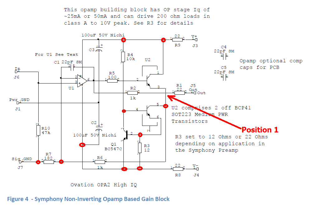

I think Figure 4 really needs a solder-dot in Position 1. I've noted a few other places where solder-dots might be nice to have, but IMHO it's mandatory for Position 1.
