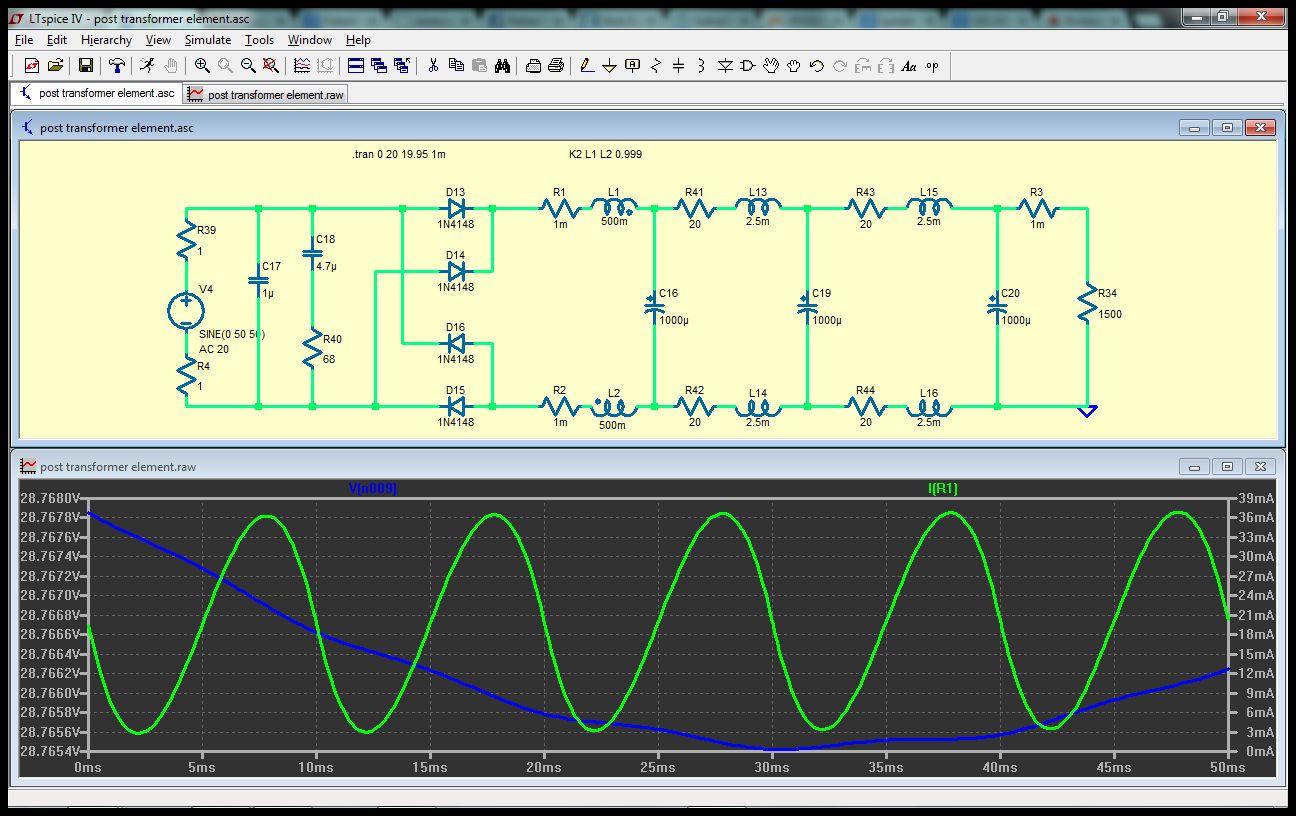

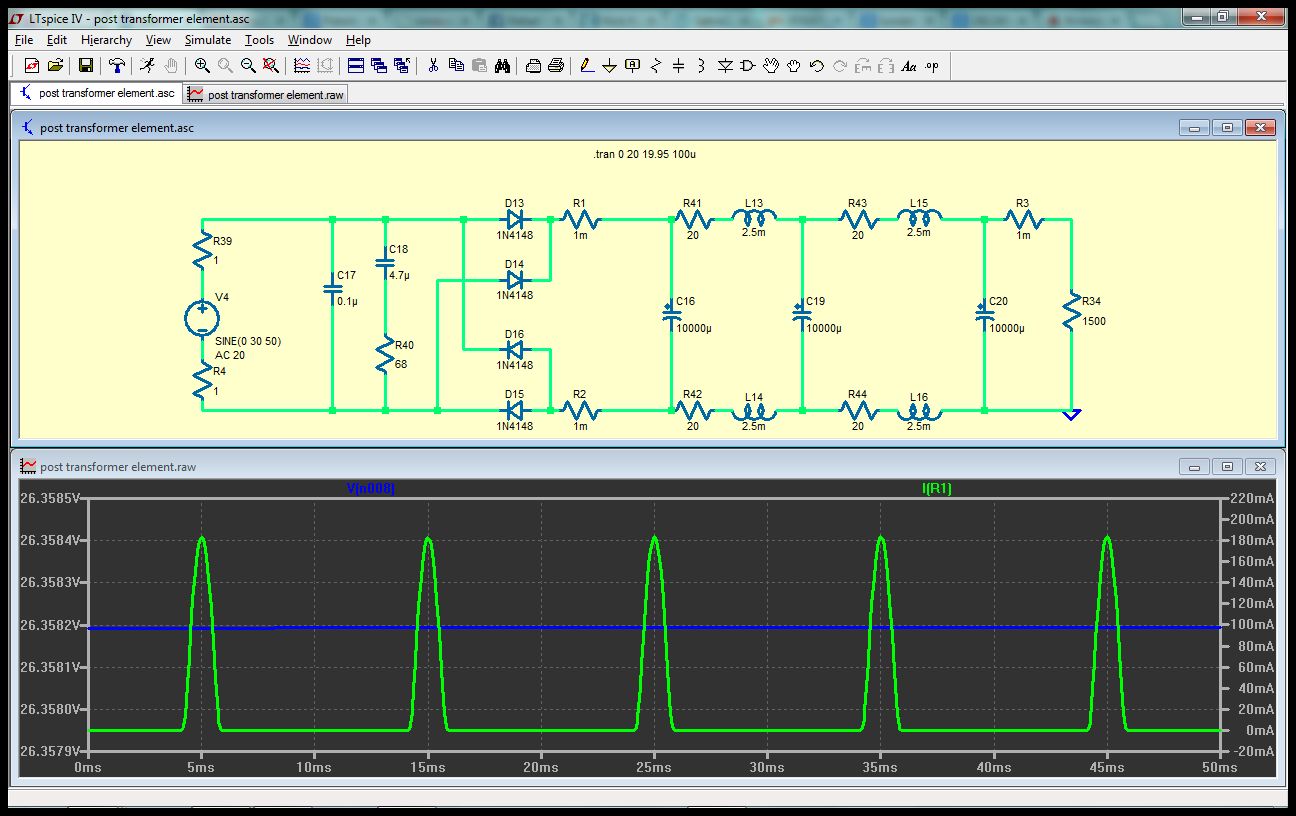

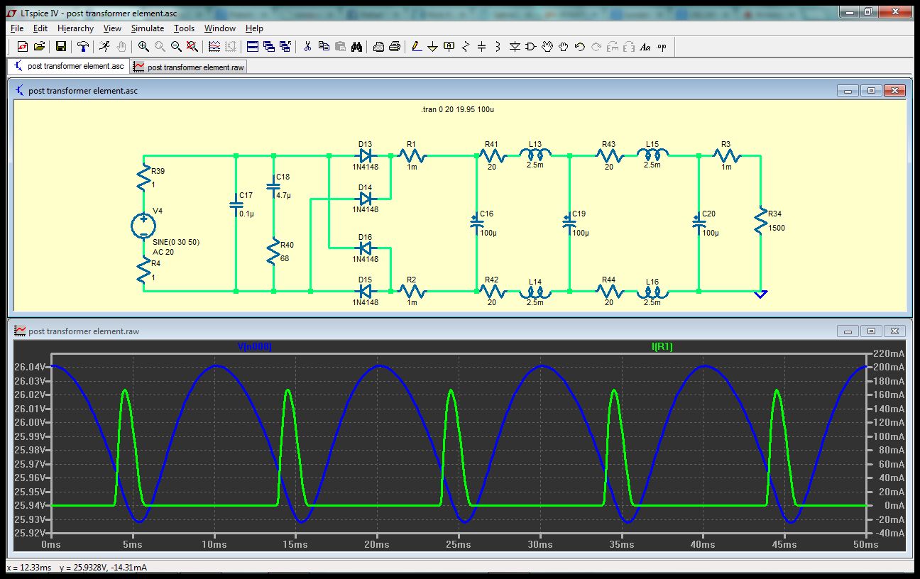

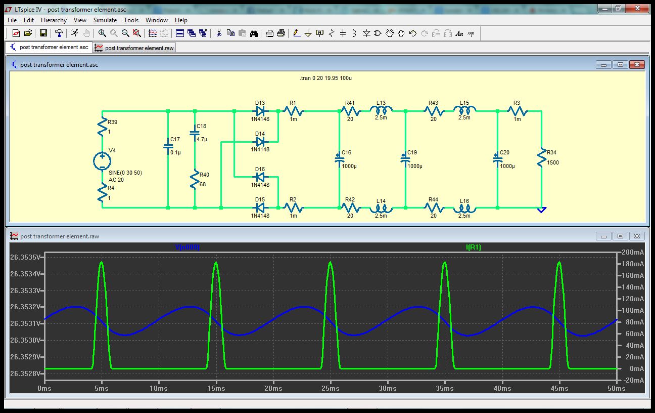

Did some spice research show current pulses into different caps etc including two methods of broadening the width of the current pulses.
100uF caps
Increased secondary voltage with 2 x 500mH inductively linked - with smaller values the current turn off at some times
  • 5 2R and increased voltage into 1000uF x 3 via 2 inductively coupled 500mH  x 3.jpg
My conclusions are
Increasing the size of the caps makes very little difference to the height and width of the current pulse.
Increasing the voltage and adding resistors substantially decreases the height and increases the width of the pulses.
Increasing the voltage and adding ( huge ) inductors gives the most ideal current always on situation ( via one or other diodes ) but for a low current supply - like the one I am just about to build - the inductors have to be impractically large to achieve this.
Unless anyone can offer other ideas I think I will opt for series resistors.

How much current ?
The charging current only equals the discharged current. The charging time is determined by the current available. That is mostly a function of the transformer current capacity. Once the filter capacitor is large enough to require maximum current then dV/dT = i/C.
The definition of capacitance is C = q/V. This yields CV = q. The first derivative is C dV/dT + V dC/dT = dq/dT. As in an ideal capacitor there is no change in C (dC) and dq/dT is defined as i. You get the ripple equation.
Here is one US supplier: Triad Magnetics Product Specs They don't have your exact choke but they do have a 6H 200 mA inductor. It weighs 2 Lb (1 Kg) and is stocked at Mouser for $23 ea. You are pretty assured of continuous conduction with 6H. It also has a DCR of 150 Ohms. That translates into 15V before you get to the cap. And with a choke input supply the output voltage is approx .707 X the RMS voltage going in. However $80 for two supplies for just that part quickly gets the BOM in the uber premium range. And they are not wound with 6/9 copper even. I would look for a small shop that could make a bifilar inductor so you would have one chunk of iron for both rails. Use it in normal mode, common mode won't do much.
