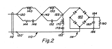

Demian,
You may want to put the inductor on the AC side of the bridge. For a complete list of passive current shaping rectifier circuits see:
http://www.sdaengineering.com/mepcon10/papers/154.pdf
Please note that the best looking results of the circuit in 3.1.5 are not practical to achieve. The parallel traps will draw the harmonic currents of any non-linear load connected to the mains. Proper dimensioning for power dissipation thus become a big question mark. The solution has its merits in closed systems like the 400Hz power distribution of avionics systems for instance.
Giorgio
Great overview. I have been aware of those ideas but did not think them too practical for consumer products.
I have been using a different solution for years, here: Patent US5251120 - Harmonic noise isolation and power factor correction network - Google Patents that has shown amazing results. It has proven really difficult to make due to the magnetics. If you follow what it does its similar to the traps but in a different way. In operation the voltage waveform into the diodes is square and the current waveform from the line is really clean when optimized. The peak currents into the diodes are lower than when directly connected, almost like a choke input supply.

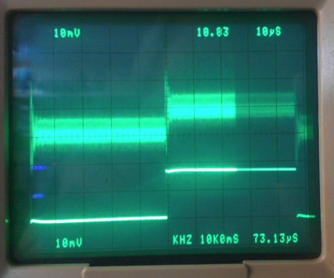

I have a bone to pick with you. Before when discussng measuring diode noise we compared the current probes we both own. You failed to show the article on rolling your own.
Well I spent two hours this afternoon building a wide band low noise 20db preamp, a current probe as mentioned in the LT ap note and used a small tuning slug core to build a small current probe as shown in your article
Well the LT style probe did show current when inserted into a test loop. Nothing worth looking at in the actual circuit. Then I ran a diode lead through the current transformer.
Using one channel for the probe and the other looking at the transformer secondary voltage to get a trigger, I got the best images of current through a diode by an amazing margin!
I see baseline noise until the diode conducts. Then I see the charging current although due to LF band limits it is probably limited a bit. I also see the line noise ride in while the diode is conducting. I clearly see the charging tail change depending on filter capacitor size. And for the first time I see a beautiful turn off spike. I can zoom in on it and even watch how well the various damping methods work. If I get a chance tomorrow I will post some images.
So now I have to pick up an assortment of cores and make and calibrate a series of probes. So not only did you hold out on a great method, you have created even more work for me. 🙂
ES
Here is the same current using two current probes. The lower trace is a Tek AM503 ($500+) the upper trace is Quantasylum QA190 QA190 Differential Probe which gives both a current probe (better suited to higher currents) and a differential voltage probe good for 150V for $79. They are looking at 10KHz at 4V into 50 Ohms or 80 mA P-P. The QA190 can work with DIY probes I suspect and that may prove useful. While its noisy at the 80 mA level you can see the waveform. This probe is scaled for 10A/V.
I have an assortment of current probes and they are all very useful for looking at switching waveforms. A few mag field probes are also very useful to see how far the disturbance goes.
Demian,
If you transpose the series of parallel LC into a parallel group of series LC you get better results - sonically, also.
[I know... cause I have a patent on it]
THx-RNMarsh
Demian,
THx-RNMarsh
Doesn't work. Its not a filter. (I checked to be sure and the output is 30V instead of 140V) The USPTO had trouble understanding it as well. Build a spice model and study how it works. Hint: The series networks are called reflectors and the shunt is called a pump.
Richard,
It is true that a parallel resonant "harmonic trap" filter has better performances than the series arrangement of the same. It is however more limited in scope and, IMHO, probably not the best approach for an audio system. I try to explain...
If you consider a preamp + amp system, the harmonic trap filter is a suitable solution for the preamp only. The power amp cannot use the same approach unless it is of very limited power. Ideally, you could use an active PFC with all of its shortcomings. In practice, only a few power amp for the consumer market are PF corrected (Halcro and Nagra comes to mind, pro audio is different).
So, your system ends up having a power amp using a peak rectifier that injects harmonic currents into the mains and a preamp having a harmonic trap filter that draws those harmonic current. All is well as long as the resonant cells can dissipate the additional power generated by the amp harmonics but there is always a chance that those harmonic generate a magnetic field into the preamp cabinet.

Why would you use a parallel resonator in series with the load? To block individual harmonics? Seems very inefficient and expensive to me.
Why not use a series resonator in series with the load that blocks anything that's not a 60Hz sine wave? Much less expensive, you might be able to filter a <10W circuit this way for $20.
Keantoken,
The solution you propose is the second best in the paper I've referenced before, the best being the one proposed by Richard. I still think it is too complicated and prone to susceptibility issues that might be difficult to deal with in a real product that needs to pass CB tests.
I would rather use the AC side inductor with a properly shielded transformer and medical grade EMI filter. Like I said before, a complete design must address voltage, current, electric field and magnetic field in the real-world installation conditions the product is likely to meet.
To me, the AC side inductor is the best trade-off, albeit not the top performer in absolute. What Demian did is really heroic engineering. But I understand this is the Blowtorch thread 😀
