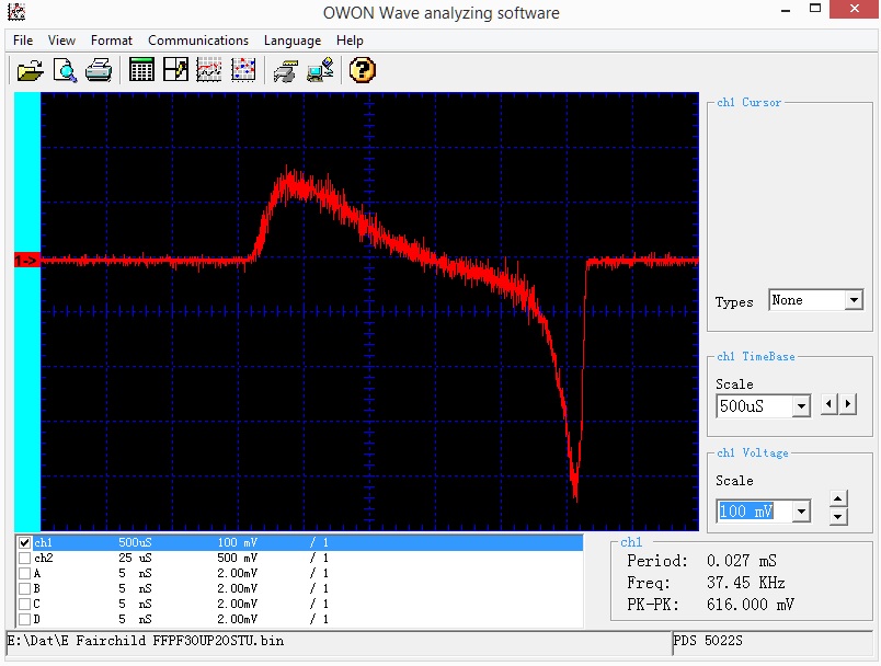

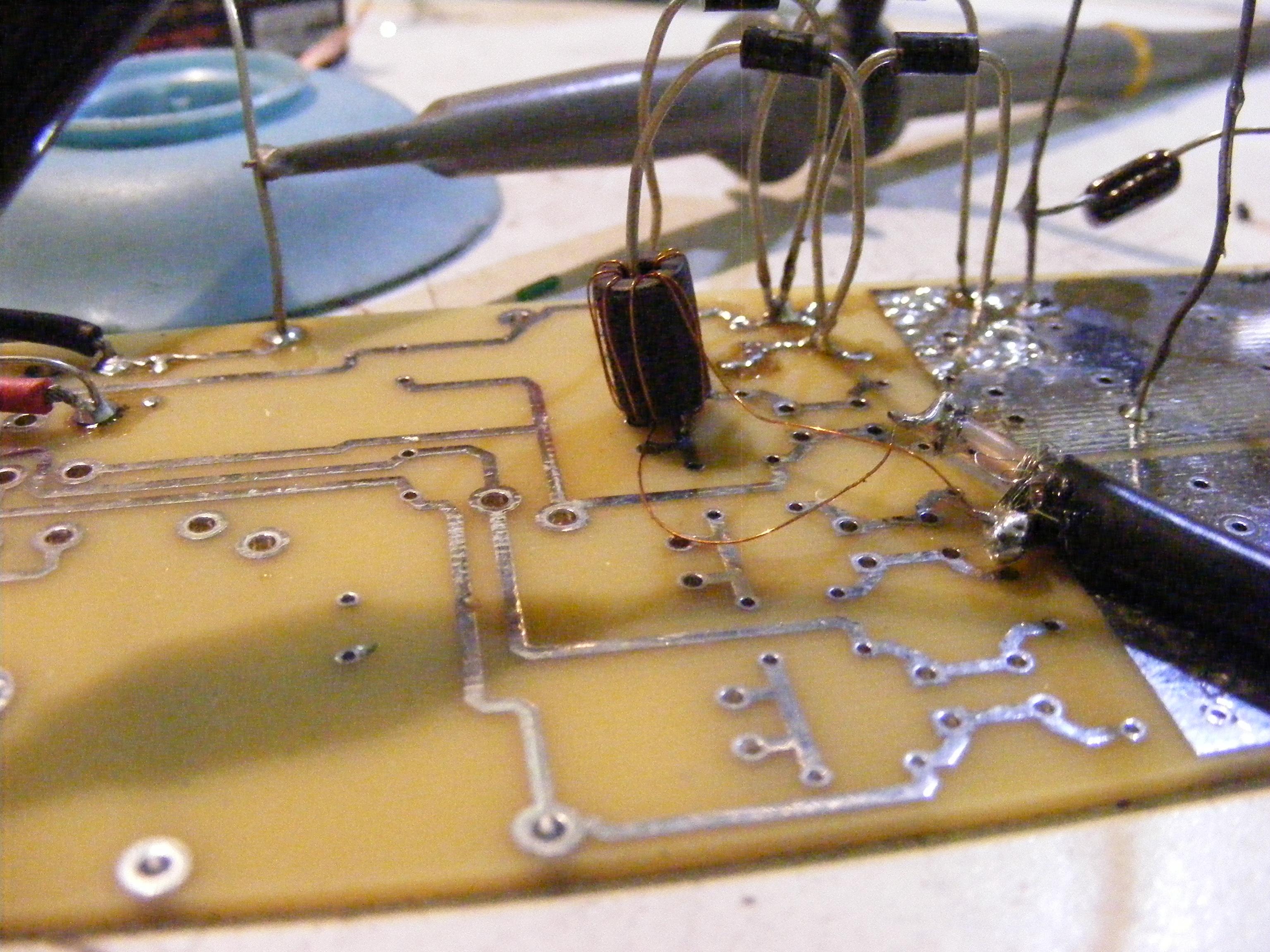

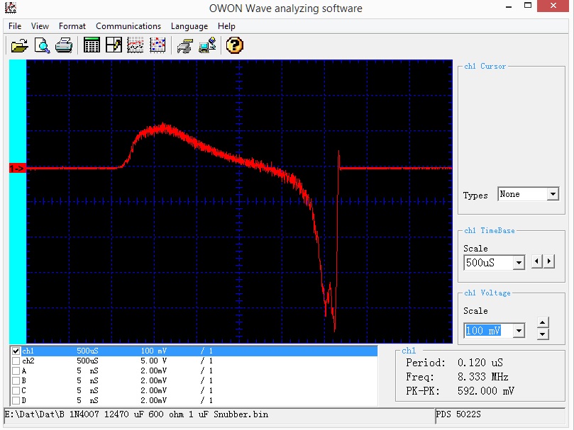

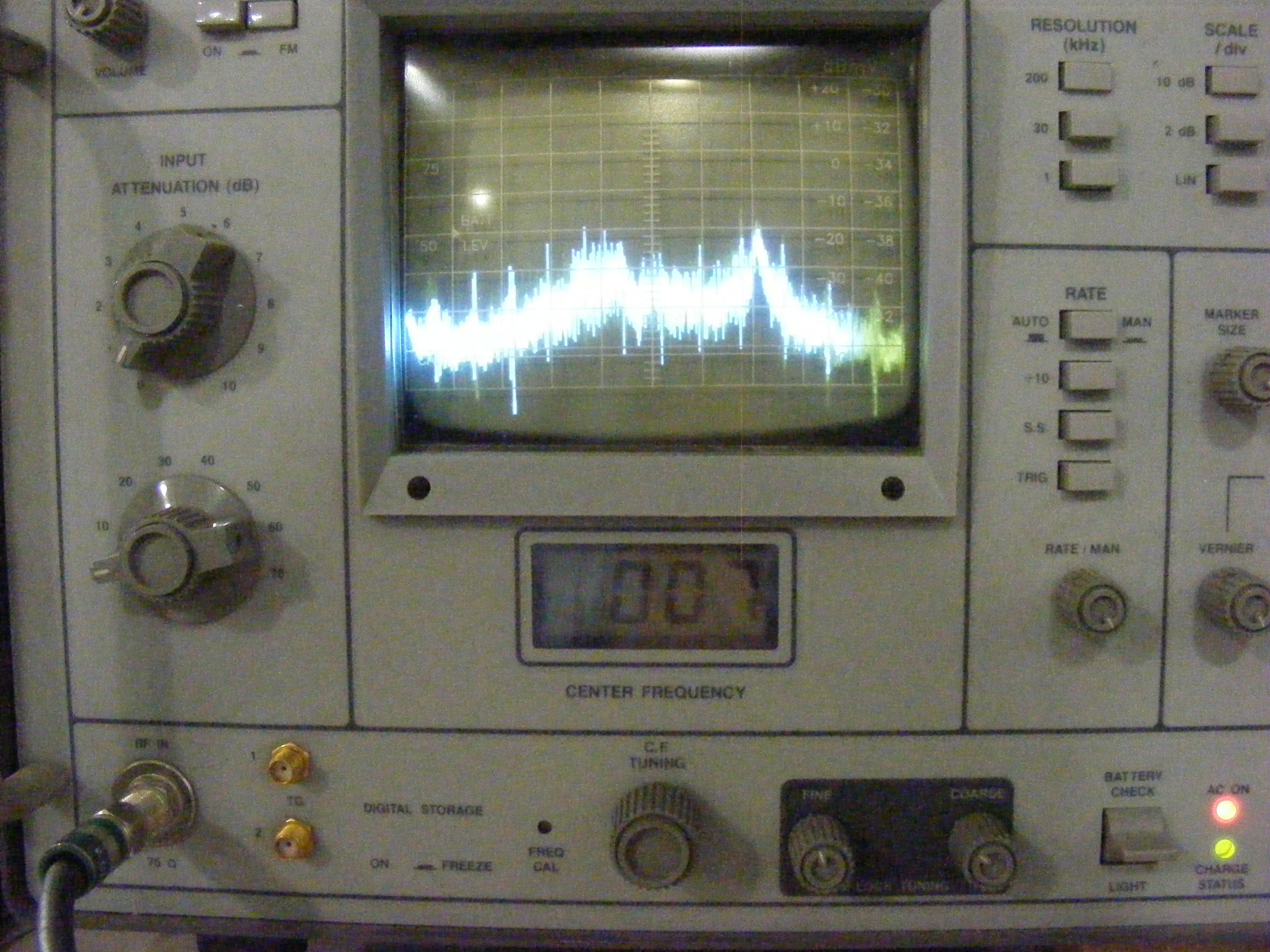

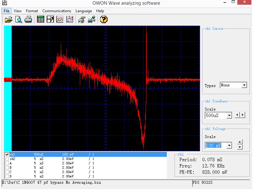

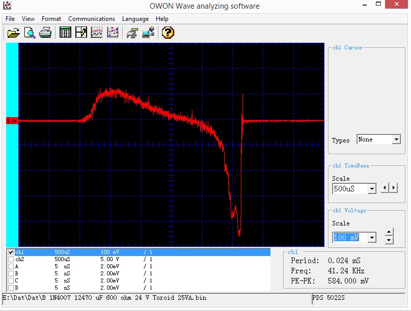

Attached are some images of my diode noise measurements,
The circuit is a 24 volt single coil from a 25VA torroid transformer feeding a 1N4007 diode bridge that is loaded by a 600 ohm resistor. About 36 volts DC. A 12,000 uF bank of capacitors can be switched in as can a 1 uF capacitor across the transformer.
First six images look at the current through one of the diodes.
First is AC trigger waveform with the basic setup. Second is a closeup of the diode switch off spike. Third is the whole cycle with the 12,000 uF capacitor bank added and the fourth scope image is with a 1 uF snubber across just the transformer secondary.

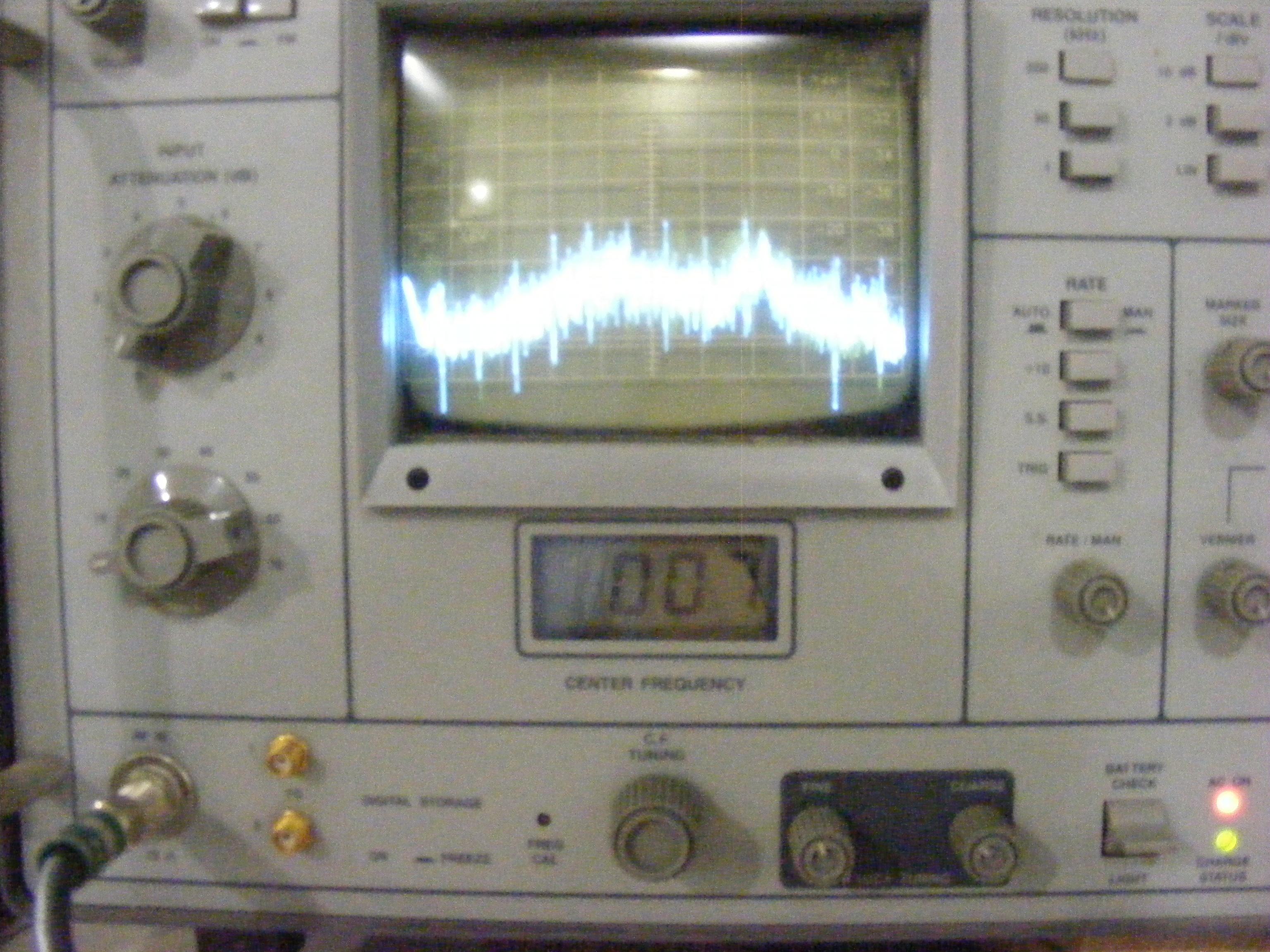

Next is the RF spectrum without the snubber and then with. Note the spikes are a 1 MHz marker showing that we are looking at about a 15 Mhz bandwidth.

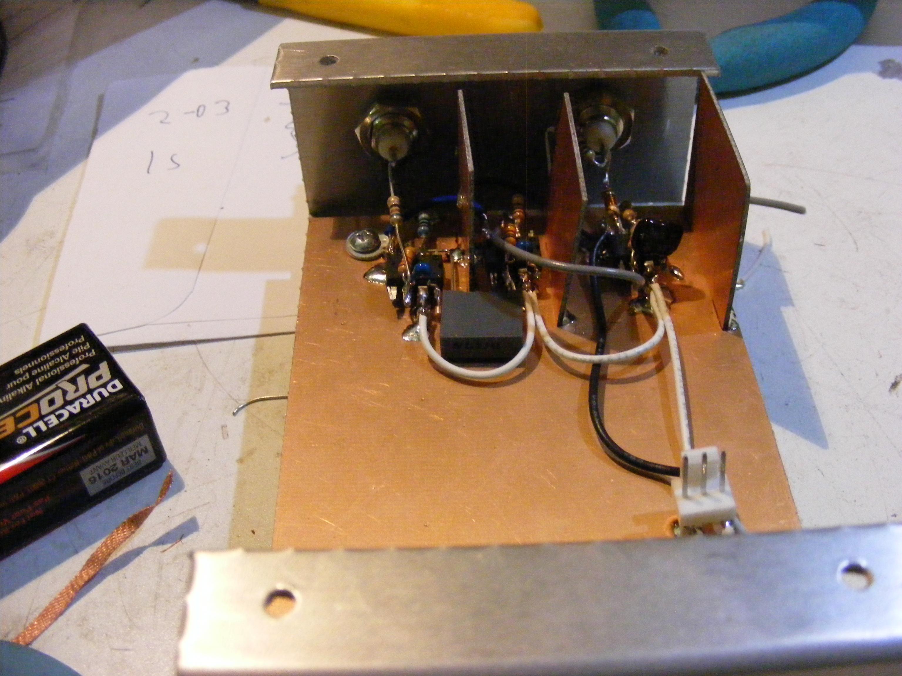

Then is a close up of the test card and my sensor. Last is the preamp used to get these images. Note it is built "Flying Bug" style!
What I note is that you can see the turn on surge also lets line noise in. The surge increases with a larger filter capacitor. The snubber has decent effect on the diodes, but not total.
The RF spectrum shows how broadband the noise actually is and that some is diode switching and other line noise.

Oops I forgot to mention there is always a 470 uF filter capacitor in the circuit. It goes across the 600 ohm load resistor.
Ed:
What is the calibration constant current to voltage on the measurements?
I see the noise floor increases during the conduction cycle but I must ask how to confirm that's line noise and not something else that causing the fuzz in the waveform. The fuzz seems pretty uniform when the diode is conducting which is not what I usually see when looking at line noise.

Ed:
If you look at the rf spectrum there appears to be an LF roll off. When I get the chance I'll run a current curve.
As I have a line noise generator or two, it is a simple matter of changing the AC line noise and watching it track.

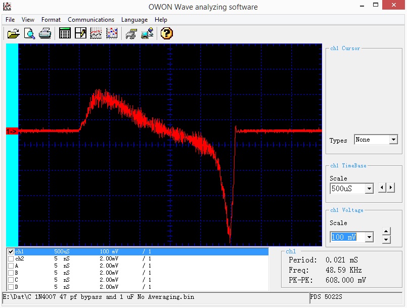

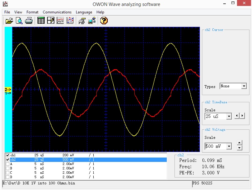

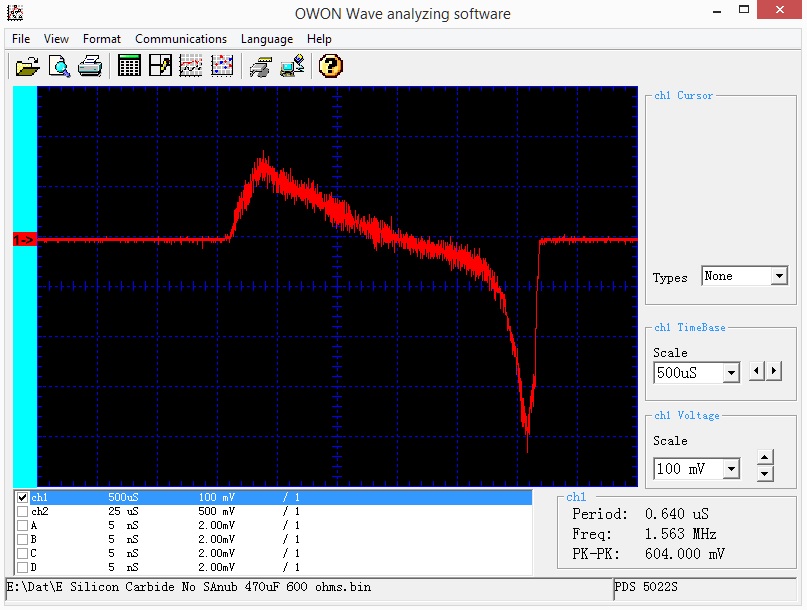

Demian,
I did a quick check of the sensitivity of the probe. I used a 100 ohm resistor and looked at the current through it and the voltage across it. Voltage is channel 2 or yellow. It's frequency response is horrible, but it does go lower than I thought. I tried my noise maker box on the AC line and it worked so well the scope no longer could talk to the computer. So I took off the signal averaging and am just showing single traces, I think you'll find the noise is nicely noisier.
I also looked at the way to snub using small capacitors directly across the diodes, as you can see the 47 pF capacitors did let in a bit more noise but had no effect on the spike in the frequency range handled by this measuring method. The 1 uF across the transformer was more effective and knocked down the noise a bit.
Attached are a few pictures, as you can see there is virtually no difference between the turn off spikes from a 1n4007 and any of the faster diodes>>>> 🙂 Note the bump in the curve from the silicon carbide rectifier, I read this as weird ESR. So I would use them for low current use only, but based on the price probably not even that.
That would make me suspicious....
Jan
Jan
Jan,
Are there optometrists around where you live? Please take a look at the curves. Remember all absolutes are wrong.
