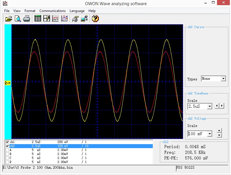

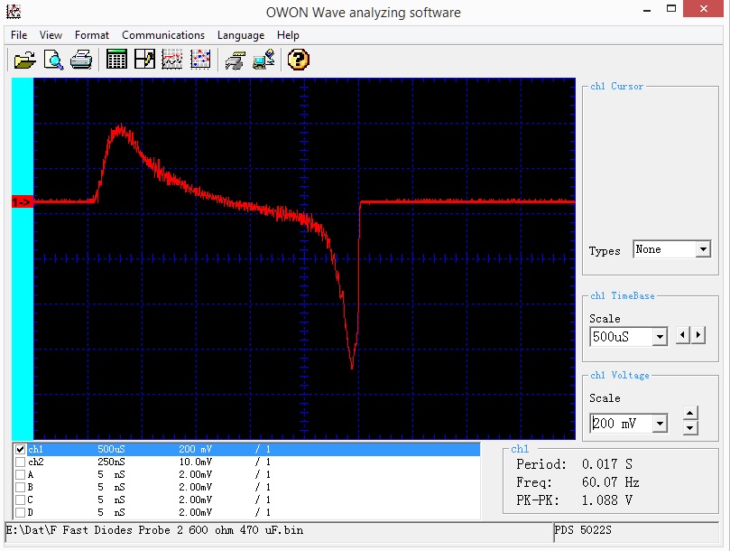

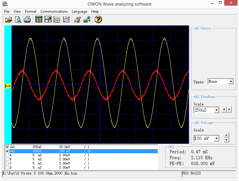

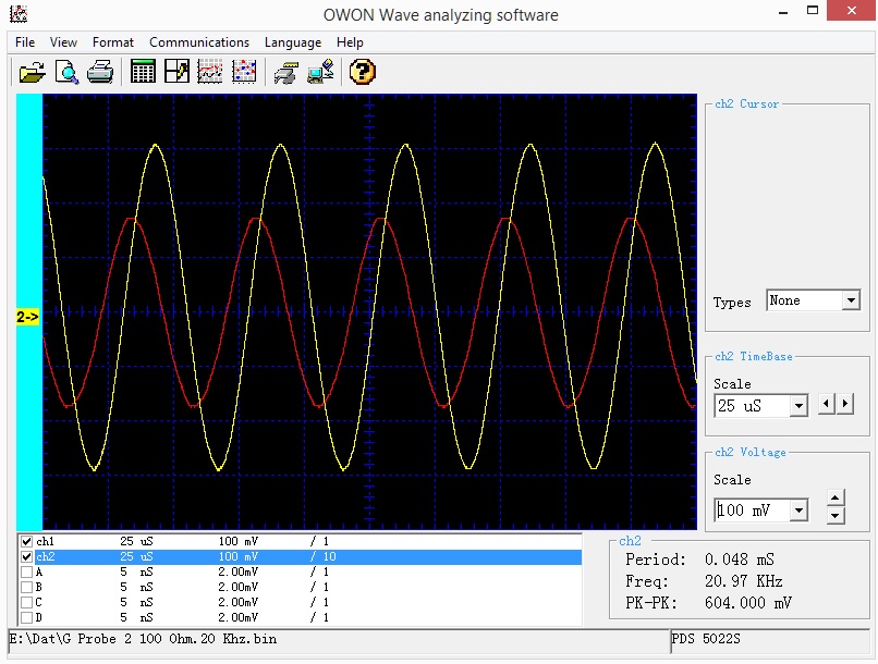

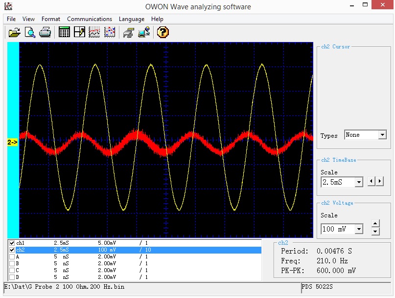

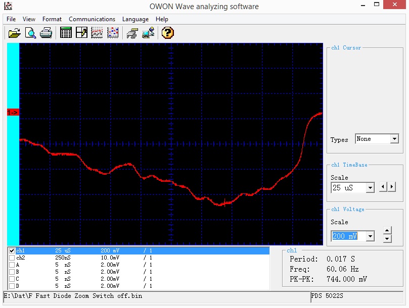

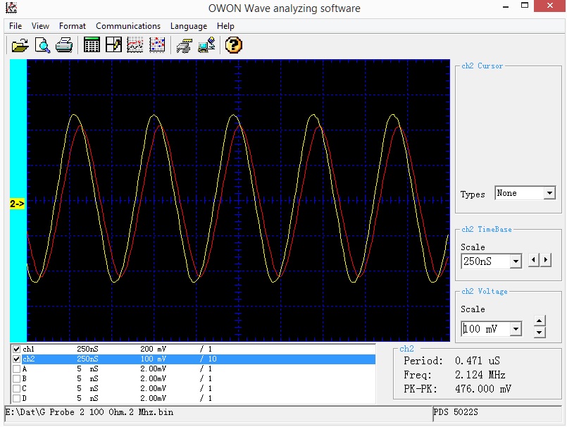

Here are the results of my tests using a ferrite core designed for RF use. As my good Tek scope is down these are from my Owon as it is a 20 Mhz bandwidth scope it will not show all of the energy. I have also shown before the results of RF spectrum and these clearly show spikes around 2 nS duration.
Just for SY, The current source is a function generator set to sine wave (Except for the square wave shot) driving a 100 ohm resistor. Channel 2 (yellow trace) shows the voltage across the resistor. We use Ohm's law to realize the current is 10 mA per volt shown. The Channel 1 input shows the output of the probe and preamp. It is the red line. At the bottom is the particular notes for each shot.
The calibration shows that the core attenuates low frequencies (not very surprising) and the entire system overshoots a bit at 1 Mhz squarewaves. I also include a redo of the Fairchild FAST diodes for a comparison between the much worse proof of concept tests and this better probe. There also is a close up of the turn off surge showing the limits of the system.

Yah, the transfer function drops as frequency, not surprising as you say. The overshoot is circuit inductance and transition speed. This will rear it's ugly head when you stick a snap diode in. edit: sometimes a diode will hold it's current for a while, then really snap off, while some diodes will be much softer in the transition. It's all that diffusion stuff, and how quickly the charge sweeps out or recombines via diffused or implanted impurities.The calibration shows that the core attenuates low frequencies (not very surprising) and the entire system overshoots a bit at 1 Mhz squarewaves.
Would you please also redo the 4007...thanks.
AH, almost forgot.
Your first two transfer responses get progressively stranger, at 2Khz it's starting to show those weird artifacts that you presented at 10 KHz previously.
Something is not right somewhere. Don't know where. But my spidey sense is tingling. I think there's some kind of equipment artifact as yet unidentified.

What is the freq response BW of the ferrite core design? -3dB at ?? freqs?
THx-RNMarsh
It is minus 3 db around 20,000 Hz and I don't have a generator to span the frequencies between 2 Mhz and 50 Mhz at the moment. My estimate is it is good to 10 Mhz. Paper calcs say 15.

Those artifacts are most likely digitization errors. They show up on some sine waves.

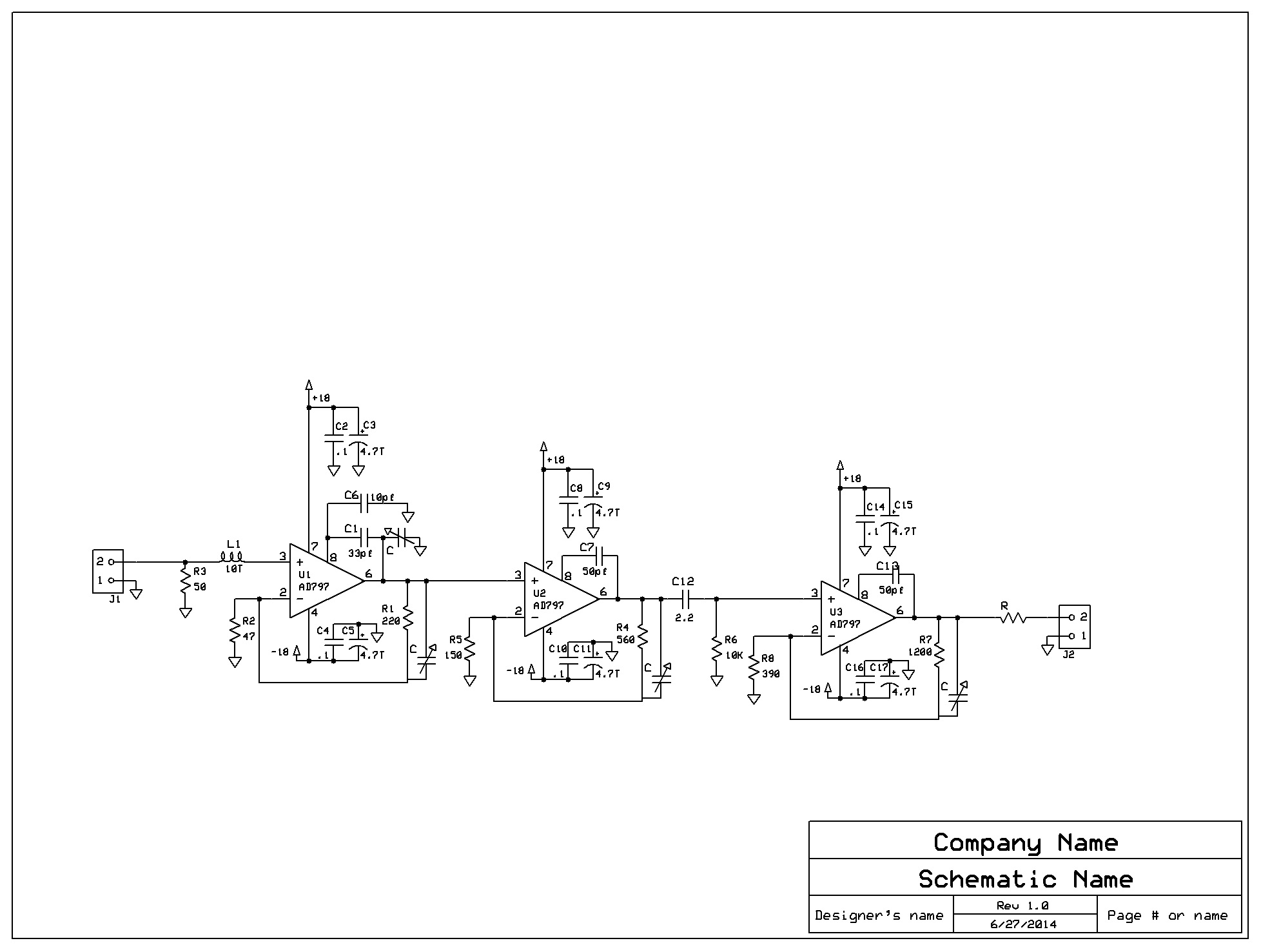

How do you tune all those trimcaps? Is the 10 turn coil to boost the response a bit? Or maybe improve the characteristic input impedance of the opamp?
The input inductor is to keep out rf and keep the input from oscillating. You tweak the trim caps by using a 10x probe stage by stage and adjusting for best square wave response. The current overshoot will get trimmed a bit more next time I open the preamp case.

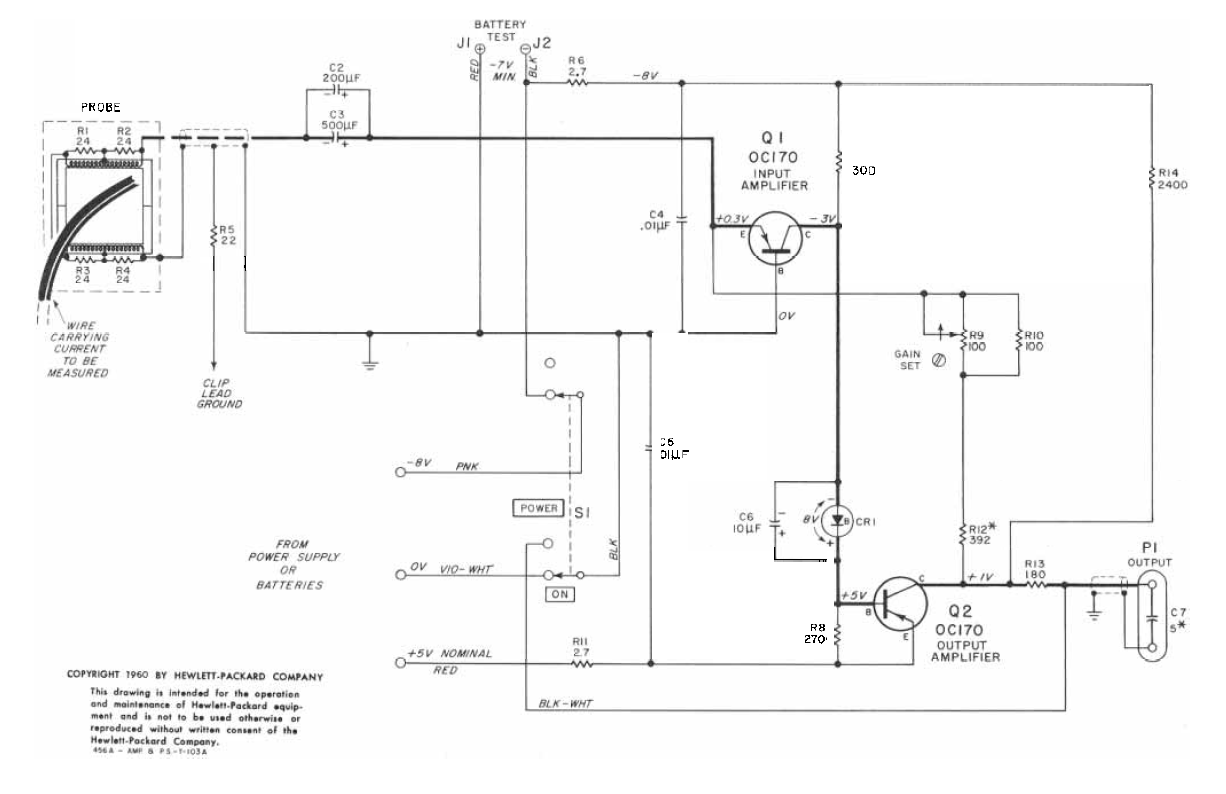

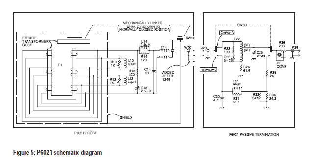

The current probe may work better and have more extended low frequency response with an optimized termination. Usually they want a low impedance termination. Below is the Tek P6021 as an example of a passive termination. There is a lot going on to get 50 MHz from it and the extended low frequencies. Too much for a casual DIY project but a subset may help.
The HP456 is more in line what a practical DIY probe amp can be (it also dates from 1960) and it shows the direct drive into the inverting input. A decent opamp could replace the 2 transistors and eliminate the coupling caps.
