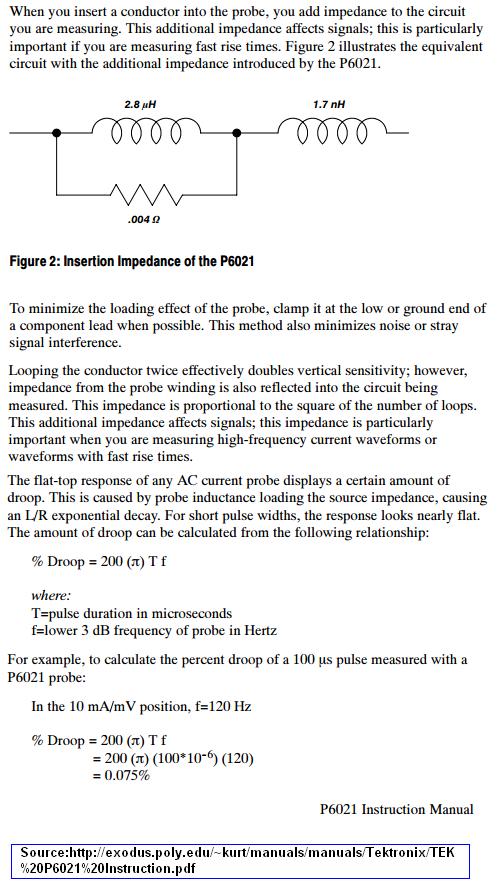

http://www.ko4bb.com/Manuals/Tektronix/Tektronix_-_Probes/Tek_P6021_Current_Probe.pdf
http://exodus.poly.edu/~kurt/manuals/manuals/Tektronix/TEK%20P6021%20Instruction.pdf
http://www.hpl.hp.com/hpjournal/pdfs/IssuePDFs/1960-07.pdf
I have a relevant dump question. When we double the number of loops around the current probe, would all the L and R of the reflected impedance raise to the square of the value shown in Fig.2 ?

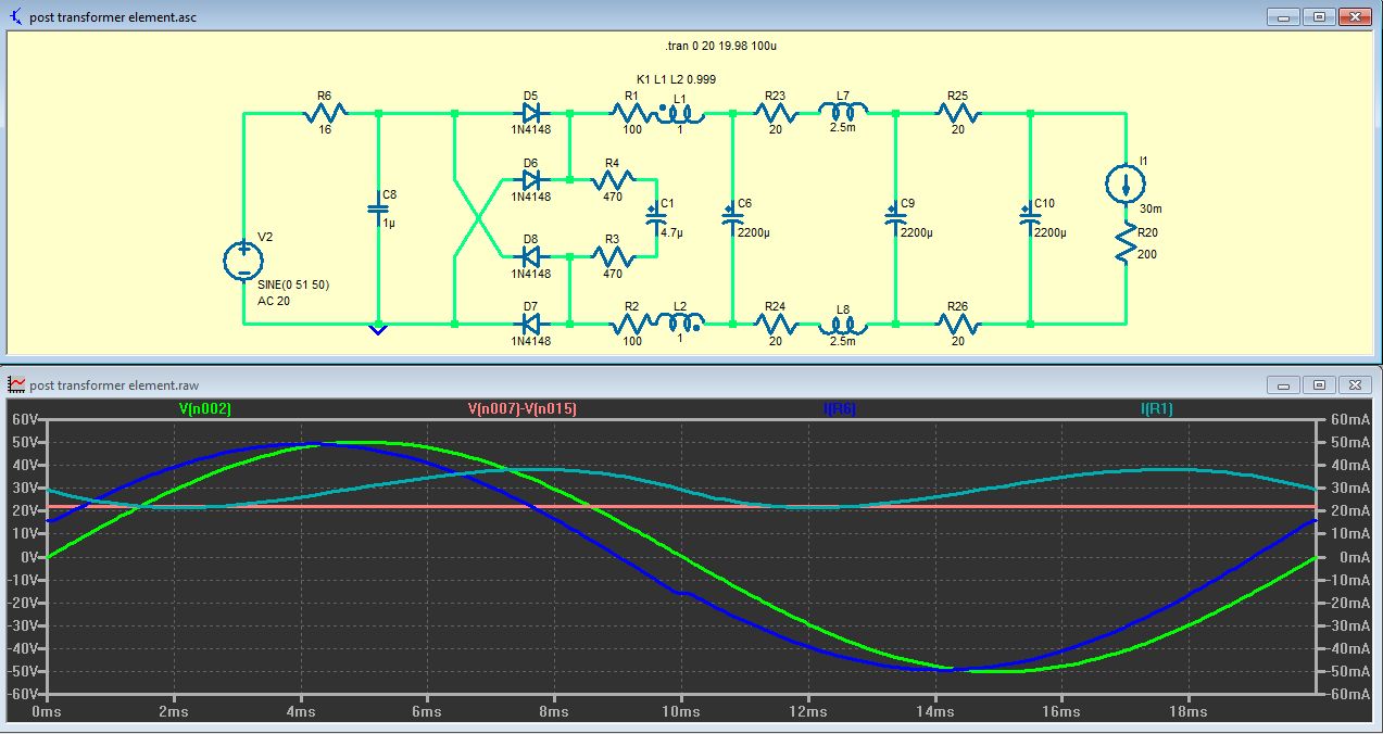

Been playing in spice to optimize my power supply design and came up with this.
It wouldn't win any prizes for efficiency - the supply dissipates twice as much as the load ! but I think I can deal with wasting 1W. What I like is the close correlation between current & voltage in the secondary and the clean 100hz ripple in the chokes.
V(n002) - green, is voltage o/p of transformer secondary.
V(n007)-V(n015) - pink, is the output voltage.
The currents are self explanatory. The little glitch in the inductor current at 10ms can be entirely removed by trimming the values of R3 & R4.
Any suggestions welcome - will start building soon and will use schottky diodes as always.

I would split R6 into both transformer leads.

Thx Ed,
In reality R6 is the secondary resistance so it is evenly split.
I tend to decouple the ground to deal with common mode noise.
I like lots of space around my circuits and chokes to avoid the potential problems you allude to but in this project my space is limited so I will do the best I can but I do have separate steel boxes for the supply and the actual preamp so that will help.
