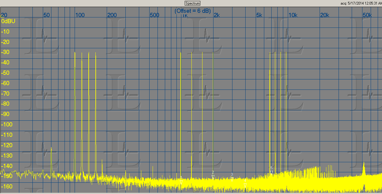

The multitone really separates the sheep from the goats. I'm using 30 1/3 octave tones at about 12db crest factor. Artifacts show up on even the best boards.
More details or perhaps a plot? Using that tone set will plant harmonics and IM products on existing tones. The tone sets on the attached spreadsheet work around that issue. The plot below is a quick loopback test of a stock EMU 1616M using a triband test.
