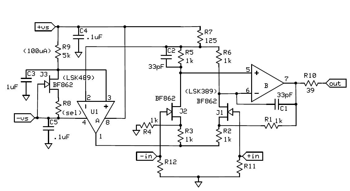

Would you be kind enough to post a link to the original idea ?
Thanks,
Patrick
I should add that it is a rearrangement of a circuit that dates from at least 1968. It is an interesting rearrangement, though. I have the original somewhere in a file but as PMA said when I posted it I noticed that the values could use a little tweaking for common mode input range. Hopefully his values are more optimal than the original.

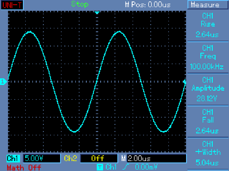

The classic current feedback :tongue: Alexander amp. Those simulation values are absurd, probably due to very rough output mosfet models.
Patrick, I also do not remember the link now. I believe it is somewhere in the CFA thread started by Bonsai. You will have to try DIYaudio search engine.

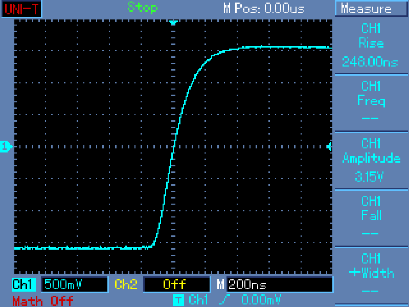

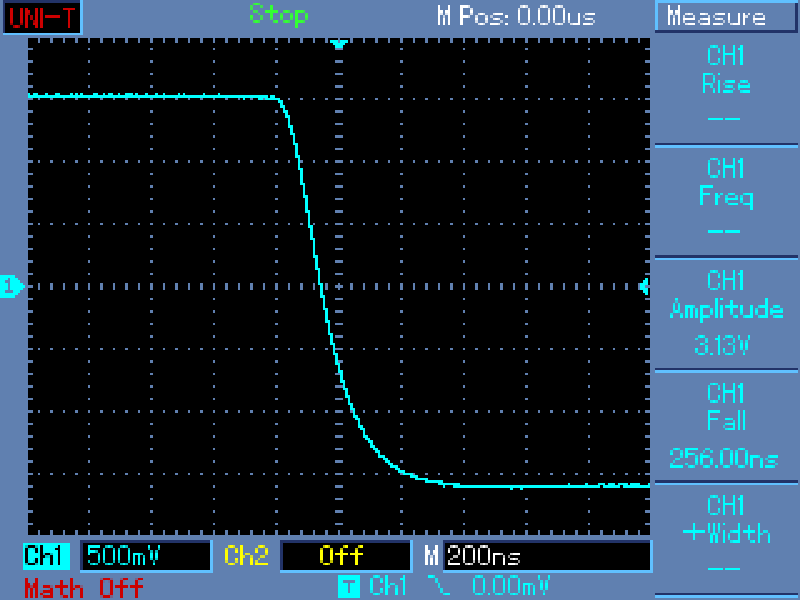

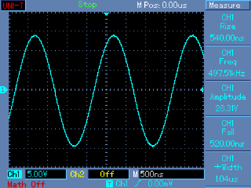

I can post step responses, rise and fall. And full output swing at SE output mode (+OUT only).

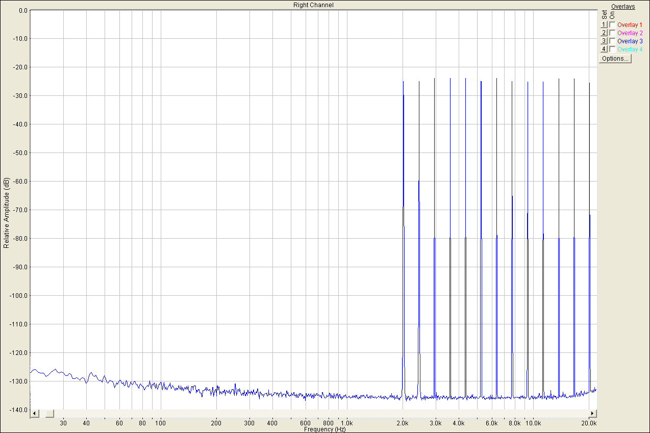

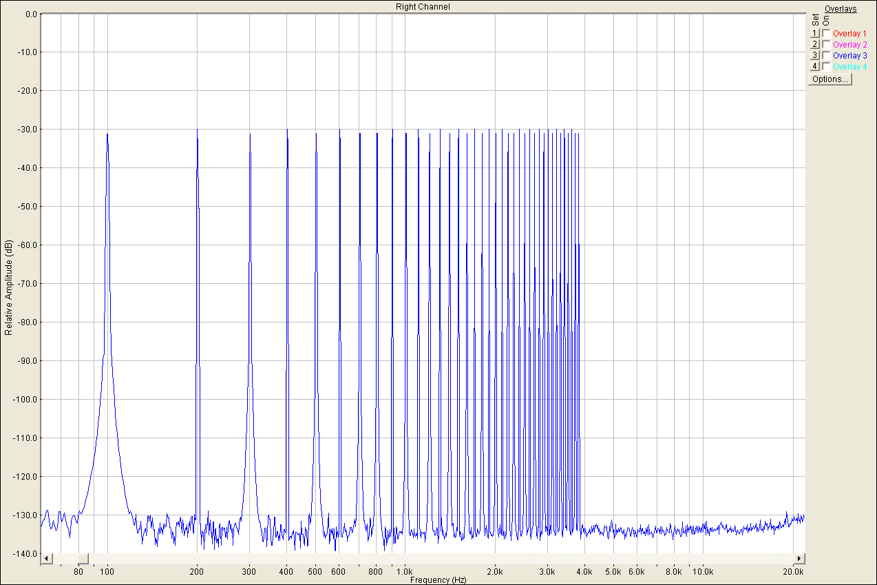

More details or perhaps a plot? Using that tone set will plant harmonics and IM products on existing tones. The tone sets on the attached spreadsheet work around that issue. The plot below is a quick loopback test of a stock EMU 1616M using a triband test.View attachment 418943
There's an ISO 31 tone spec that avoids harmonic and intermodulation products to fall in other tone's bins. Also has empty bins so you can test for noise in the presence of a complex signal.
Jan
Scott,
> I have the original somewhere in a file ...
Could you post a link or send me a copy by email ?
Many thanks,
Patrick
Here's the original (at end) but lots of good early stuff about differential amplifiers before it as well as some unusual references.
http://www.analog.com/library/analogdialogue/archives/41-01/evoloa2dataamp.pdf
Below is my original post, the gain resistor goes between the FET sources. Use PMA's resistor values since he fixed the limited common mode range in the original. If you can imagine the original (Demrow paper above) where the first two op-amps are repurposed as one for common mode elimination and one as differential gain you can place the 4 resistors around the output amp right at the input and eliminate the third op-amp. As a bonus you get a single ended output and reuse two of the common mode resistors as your gain setting network.
A note about invention, there was a stir in some quarters following the Forsell AES paper since basicly Demrow's circuit is the same but uses bipolars. I did a FET version, still have it in a notebook somewhere, as a favor to the Naval Research Labs sonar staff and that is almost exactly the Forsell preamp. Let's just be happy that good circuits happen.
