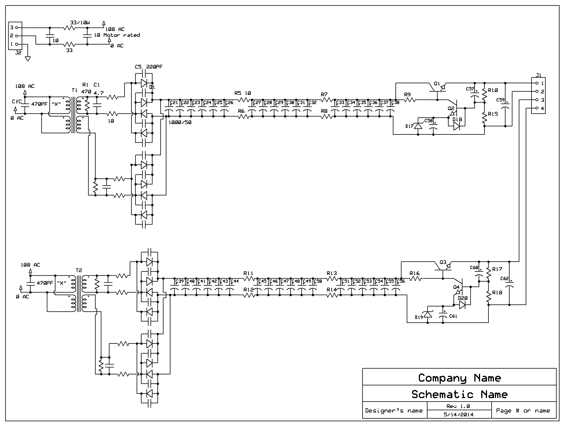

Attached is my preamp power supply.
A few notes;
The input fuse should be at least 5 amps time delay. (Not Shown.)
The transformers should be sized so that when the secondary is shorted they will blow the fuse.
The transformers should be placed in a steel enclosure and the safety ground attached to it.
The enclosure should be floated on rubber grommets from the chassis.
No wirewound resistors should be used.
ES
Ed,
Those 220puf's transport all hf hash directly from the secondary to the rest of the supply. Lose them and use soft recovery diodes!
Jan
No, the value is chosen so that they reduce the switching noise to a few dB above the incoming line noise. I thought I gave you that preliminary article with the data.
Also pay attention to the secondary phasing. Most noise gets cancelled.

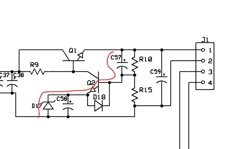

Any concerns over low impedance paths like this and possible reliability/degradation issues with the error amp over time ?
Possibly, but the circuit has been used since the 60's.
The output rail can be shorted to zero, which is handled by the reverse diode. To get a spike large enough to degrade the base junction would not be expected from the rest of the load.
But if you screw up the ratio between C57 & C59 you might become vulnerable under some conditions.
