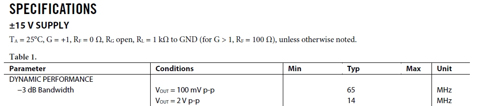

yes, a consequence of slew rate limit - that's ~75 V/us even though just below the typ slew rate is given as 50 V/us
and some may sneer since you can get an order of magnitude higher slew - but especially in this case the "highly linear input stage" is expected to change the usual relation between slew rate limit and distortion - as can be seen in the 1 MHz 3rd harmonic in the distortion vs frequency figure

Slew rate, as you know, SR = Vp . 2 . Pi . F, for sine wave.
Ahh yes, I calculated for audio, but 55V/uS hits the stops just above 4MHz, hence the lower BW.
Silly me!:D
