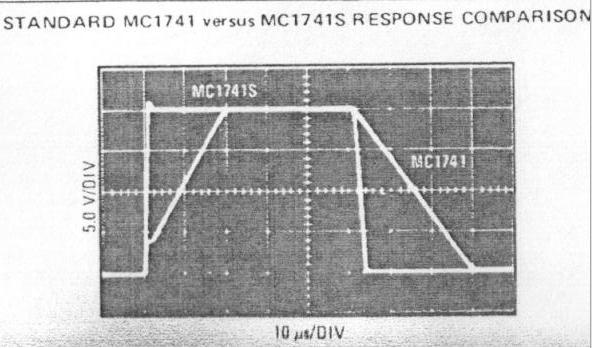

HA!...HA!...HA!....
~ 20 V/uS compared to 0.5 V/uS
Puts it within Jungs criteria for audio use .....
HA!...HA!...HA!....

Yes, Hitsware, but look at the 'small print'. It is vastly better than the 741 in rise-time and slew-rate, but disappointing in actual performance BELOW SLEW RATE. This is WHY Otala did not like to use slew rate as the dominant criterion. (I don't necessarily agree with him on this)

I got the impression from some of the comments that the 'S' was considered
meaningless .... Far from it no matter the small print .....

Slew enhanced op-amps are an obscure backwater of basicly useless technology, we learned that soon after they were proposed.
