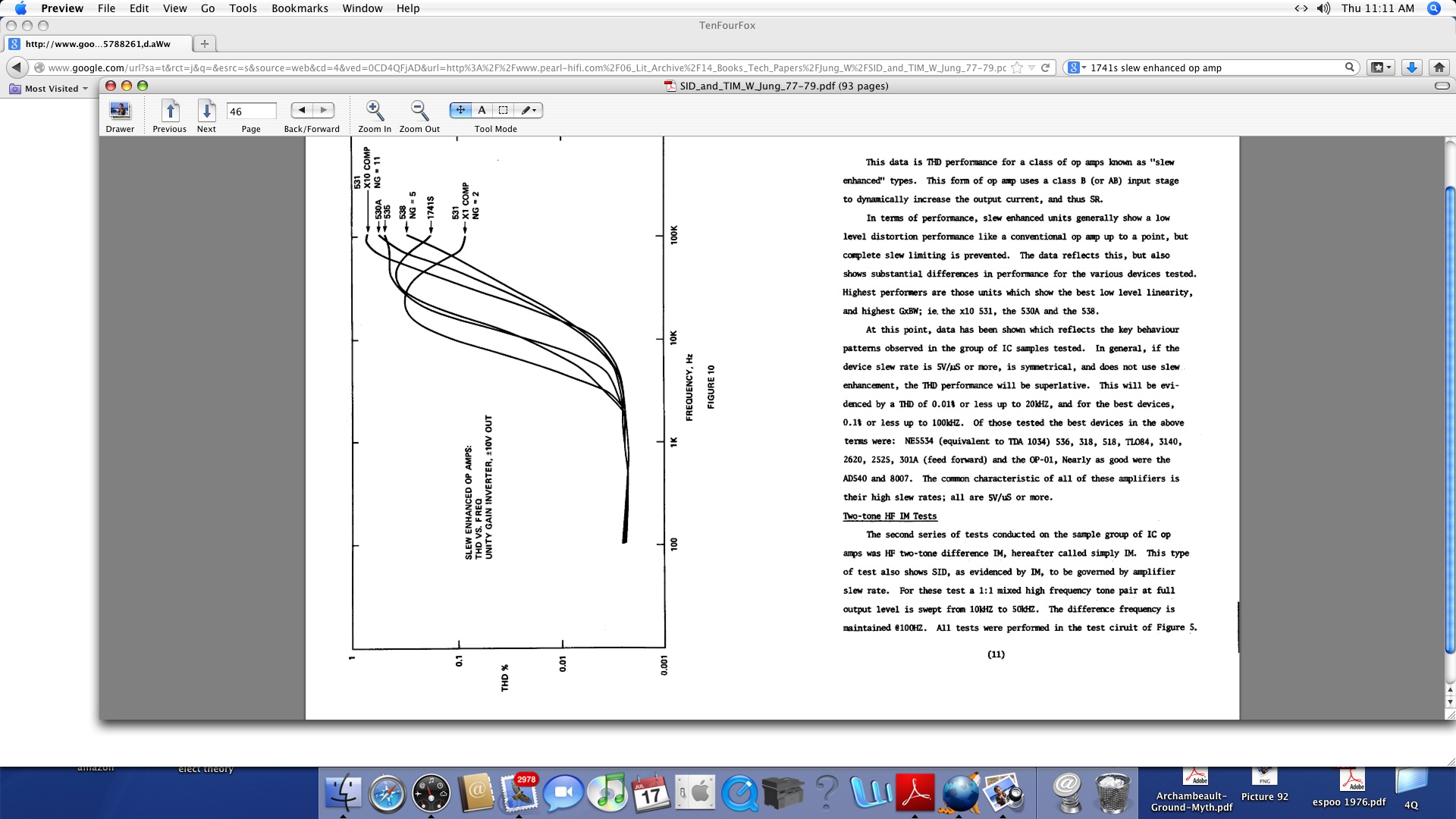

Here is a measurement of 1741S. It was much faster than a 741, BUT the distortion started to rise, well below the slew rate limit.
Sorry PMA, apparently it was the 1741s, that I meant to ask you about. It is an IDEAL op amp to show the difference between TIM and slew rate.
Huh? MC1741 was Moto's 741 same 1/2V/usec. slew rate.

Thank you, Mooly. OF COURSE it existed. I used it for buffered meter drivers in 1974. Walt, later proved its limitations.
I can't even remember how I came by mine now. It was either a leftover from my days as a TV repair tech although I can't for the life of me think of anything that used a 741S or it was supplied "in error" from the days when I used to order lots of stuff to play around with as a youngster from cheapo companies such as Bi-Pak. But fast it was. I discovered that when playing around with opamps and squarewave testing them (as you do when its all new to you :)) and finding it as good as a TL071 (from memory). I have an even vaguer recollection of a 741AS ?
