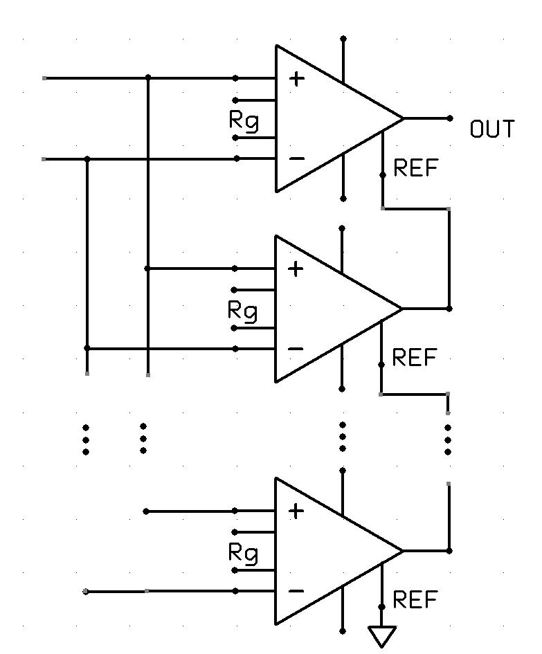

There have been a couple of mentions of paralleling amplifiers for low noise test measurements. Before I forget this old idea still has merit. IC instrumentation amplifiers can be paralleled and their outputs combined with no extra components. The SSM2219, THAT1512 would both work here (unfortunately the outputs only add so so 4 parallel G =1000 amps would have G = 4000 but <.5nV noise). The best candidate is the new AD8229 which has 1nV RTI noise at a lower closed-loop gain. The 210C version of the AD8229 is for oil well exploration and has a price to match, there is now a plastic version.
You can also stack in two groups with inputs cross-coupled and get diff-in diff-out.
