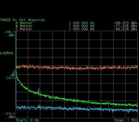

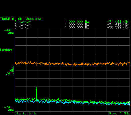

Yes, I'm using here 20 opamps in parallel ( 10 pairs ADA4898) for noise measurements.
Delivers 220 pV/sqrt Hz from a few Hz to 1MHz.
Blue line: input shorted,
brown line = noise of 60 Ohm = 1nV/sqrt Hz
green = noise of 4 Sanyo Eneloop NiMH AA in series
2nd pic is a 2/3AA Lithium Cell.
Probably the Eneloops are even better. It's time to update
my second preamp so that I can use the cross correlation
capability of the analyzer, that should bring 25 dB more. 🙂
I wanted to try NiCd, but I cannot buy them here any more.
Gerhard
Traditionally I have used a SNA-33 spectrumanalyzer 20Hz to 26 GHz with 1 Hz resolution.
That one has a 50 Ohm input, could not be different and the preamp must be able to
drive 50 Ohms.
These pictures have been made with an Agilent 89441A whose inputs can be 50, 75
or 1 Meg, at least for the lowest 10 MHz. That can make it simpler.
AC coupling into 50 Ohm with a lower -3 dB corner of 0.1 Hz would require a huge
output capacitor, so I took a slightly different route. I chose 10k input impedance at
the input of the preamp, so that takes about 150 uF. With 10k, offset starts to hurt
at > +40 dB, at least for the parallel input stages. (from bias current)
Since I needed 80 dB, I have dc blocks at input, +40dB and +80 dB stages.
There is a follower after the +80 dB dc block to drive the 50 Ohm.
The follower can be boosted to +6 dB to make up for the loss of the
49R9 source termination when a 50 Ohm load is used.
So, while the output is driven directly by an opamp, one could argue that
it is AC coupled.
BTW I had nice WIMA foil caps for the input, but only 3 of them, 10u each.
I did the board layout for them but could not get more. Those that I could
get do not fit. I'll have to live with 1 Hz lower corner until next layout. :-(
