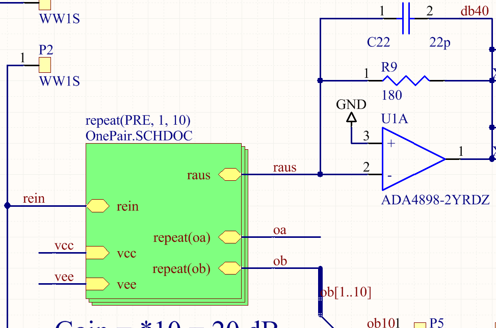

The effort to make 10 ADA4898 instead of 1 is here: (pic)
Hint: it's in the repeat(pre, 1, 10). The layout of the single
ADA4898 ist automagically repeated 10 times. (Altium Designer)
The preliminary writeup on this amplifier is in
< http://www.hoffmann-hochfrequenz.de/downloads/lono.pdf >

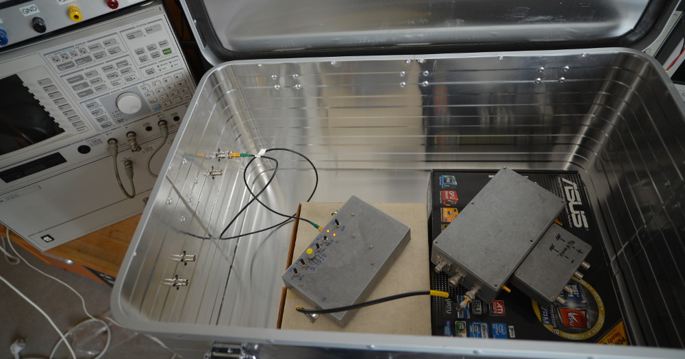

Yes, I'm using here 20 opamps in parallel ( 10 pairs ADA4898) for noise measurements.
Delivers 220 pV/sqrt Hz from a few Hz to 1MHz.
Blue line: input shorted,
brown line = noise of 60 Ohm = 1nV/sqrt Hz
green = noise of 4 Sanyo Eneloop NiMH AA in series
2nd pic is a 2/3AA Lithium Cell.
Probably the Eneloops are even better. It's time to update
my second preamp so that I can use the cross correlation
capability of the analyzer, that should bring 25 dB more. 🙂
I wanted to try NiCd, but I cannot buy them here any more.
Gerhard
